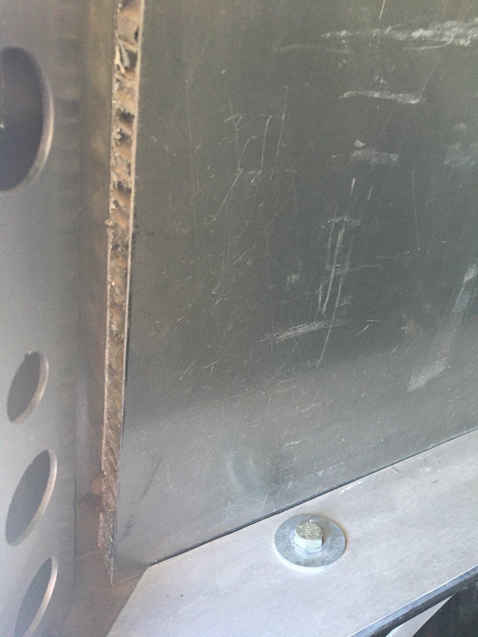

    So it doesn't have another aluminum sheet over it? On my version there is also a honeycomb insert in between the two aluminum walls.

    It looks like they just adhered the panel from the inside. Hence why I have a leak issue

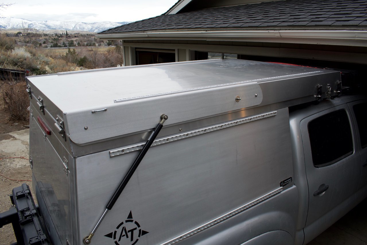

    Got the roof L track mounted yesterday. I don't really plan on carrying stuff up here although its nice to have the option to if needed. It will be a very convenient spot to hang stuff while tent is deployed at camp, lanterns, wet towells, toiletry roll, etc.

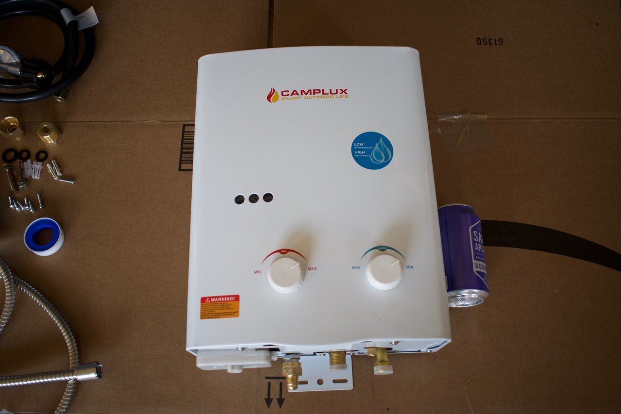

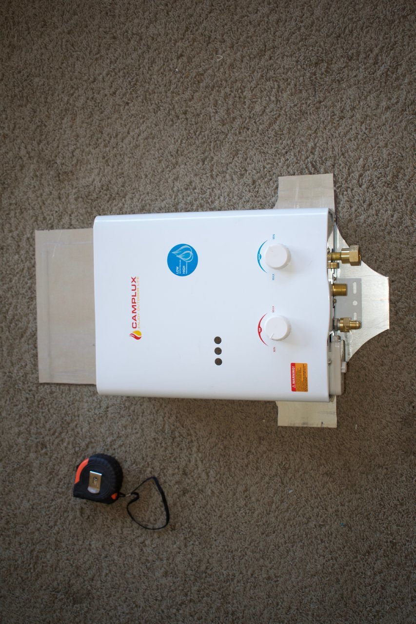

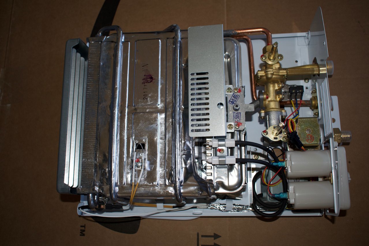

    Also got the tankless water heater in the mail, It is a little bigger than I had anticipated, and therefore will most definitely not be permanent fixture in the habitat, beer can for scale.
    I built an aluminum heat shield for it that attaches to the interior L track (don't have finished pictures). But it is easily removed with two bolts.DSC_1948.jpg
    Of course I had to open it up to see how things worked in there, Looks like a well built unit and Im confident it will be easily repairable if something stops functioning.DSC_1935.jpg
    Still haven't had a chance to test it out as I need some D batteries, and a male-female hose adapter. Hoping to give it a shot today and monitor temps closely, although I don't foresee there being any issue with the heat shield, especially since the tent will be open when we use it, so there is plenty of clearance above it.

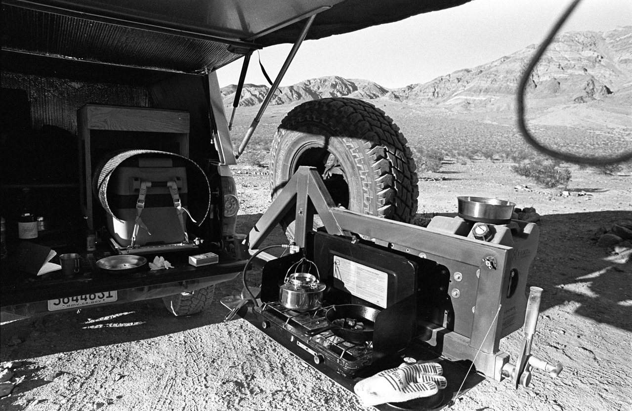

    fully zip tied
    just found the thread today. last trip was 12/17 a few fotos in mono film
