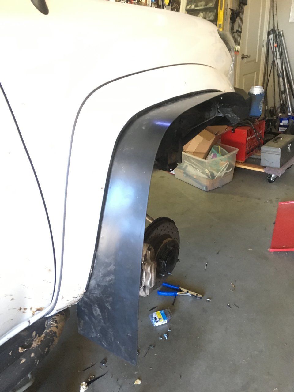

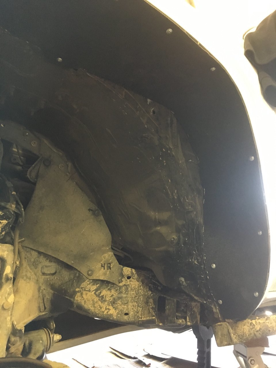

    Here's my solution. I cut my fenders, but did not want a snorkel. I left tabs on the cut portion of the fender and attached ABS plastic with self drilling screws. It helped tremendously with road noise and is easy to clean.

    So where did you get the ABS sheets from? And cost if you don't mind? is it 1/16?
