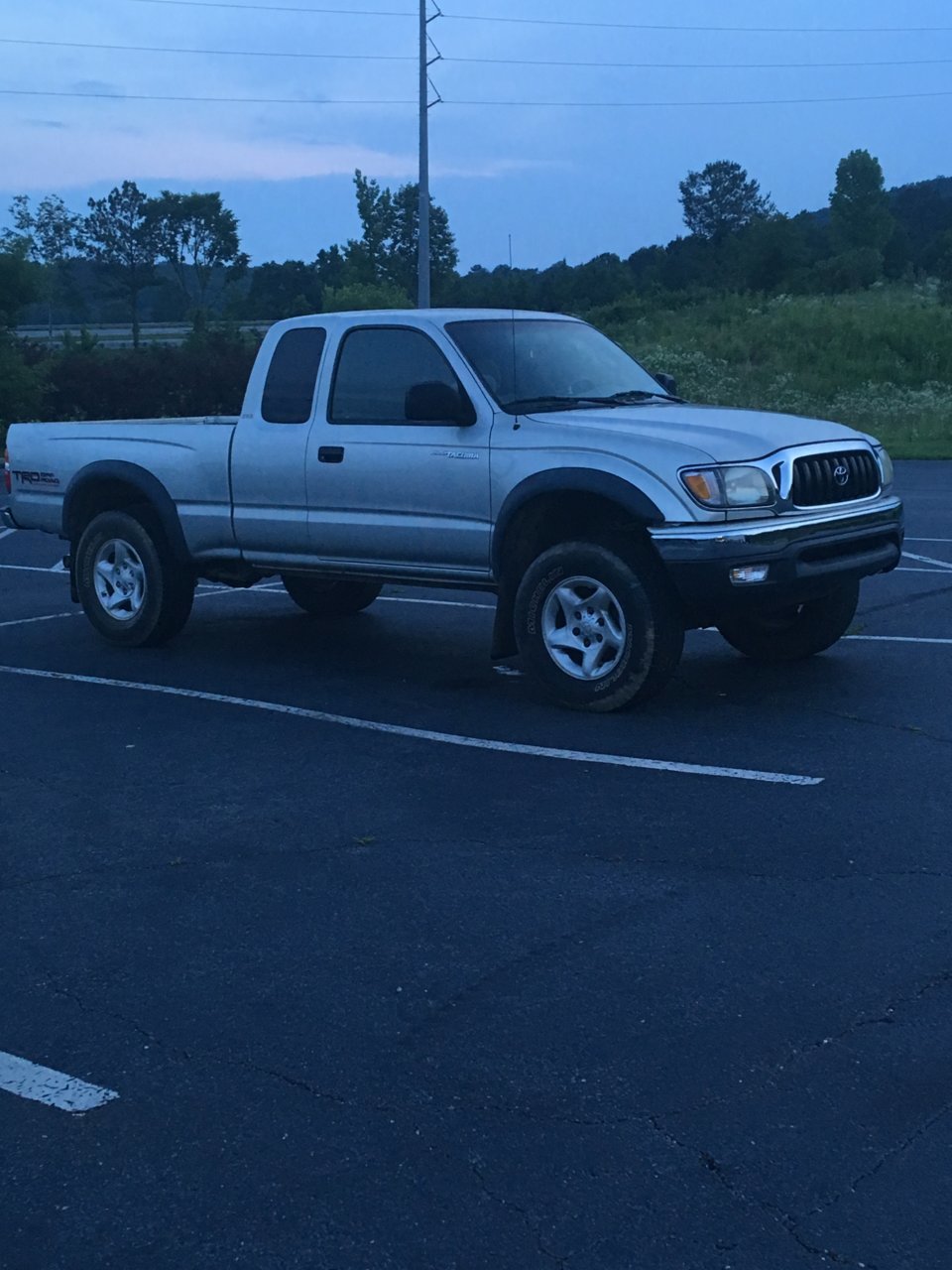

    DC306DDA-B457-425D-BB2F-416C316432C6.jpg There a decent pic

    Stick with 265's, 285's will rub without modifications.

    Stock height to a 2" lift I would run 265-70 or 265-75. Whats your budget? I think you can get the Cooper Discoverer RTX from NTB for around $120 a tire in those sizes. Its a cheaper yet still decent all terrain tire. I plan on switching to them when my current tires wear out.
