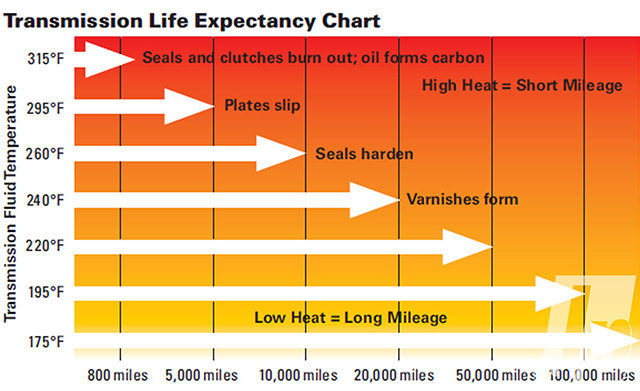

  5. Apr 7, 2024 at 10:25 AM
    #65
    Schlappesepple
    Schlappesepple Well-Known Member
    Jan 9, 2017
    #206998
    900
    Joe
    2020 4Runner ORP
    My main issue with these charts is that I can't find one that's not published by an ATF cooler manufacturer / seller. So a little too conflict-of-interesty for my tastes.
