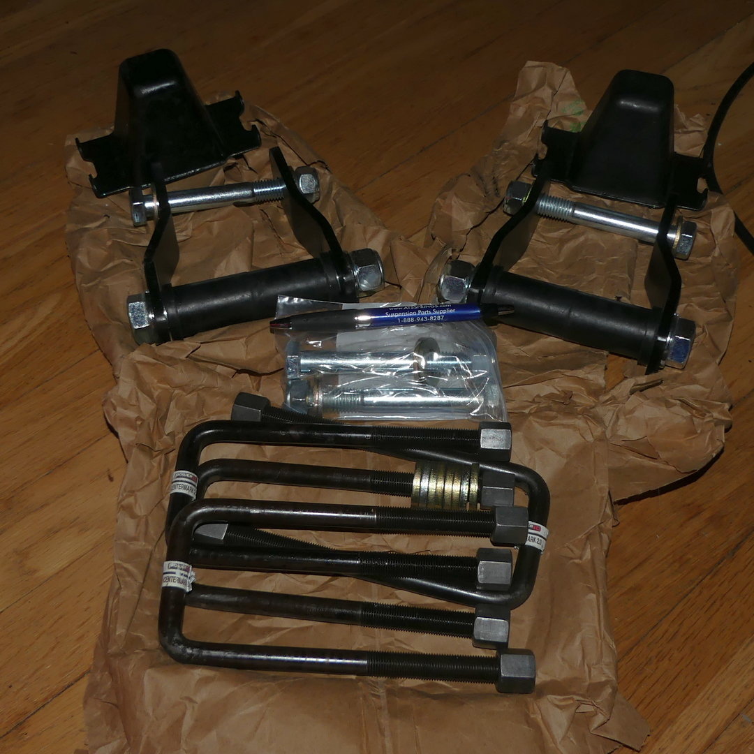

    The "kit" was the hardware (minus bump stops) in the pic plus a standard set of springs. 345.00 plus 60.00 delivery from PA to MA. He called it an even 400.00. I placed the order on a wed by the cutoff (noon I think) & had them Friday.

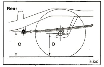

    I purchased a set of ATS stock replacement springs (90-171, 90-173) for my 1996 xcab 4wd V6 after reading this and a couple other threads. I am beyond satisfied with them. My intent was to (temporarily) keep my suspension as stock as possible. After three months and 3,000 miles, the rear height is exactly as specified when measured according to the factory service manual in the alignment section. The rear was previously 0.30" under the specification with the 24 year old springs.

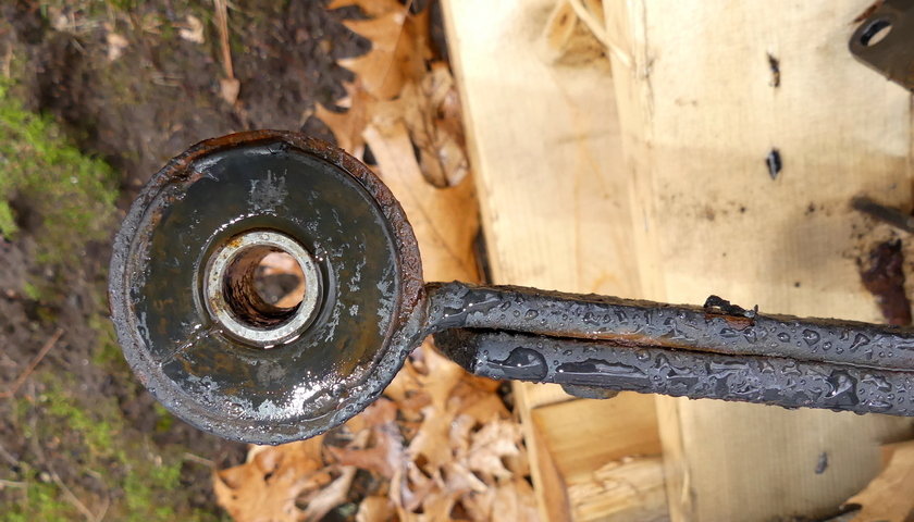

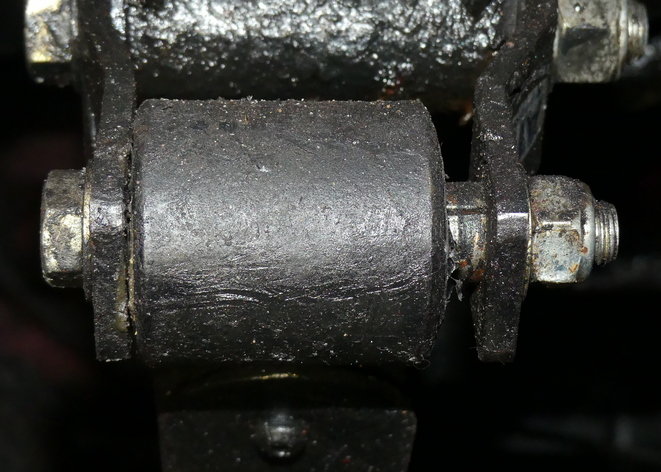

    His answer to this

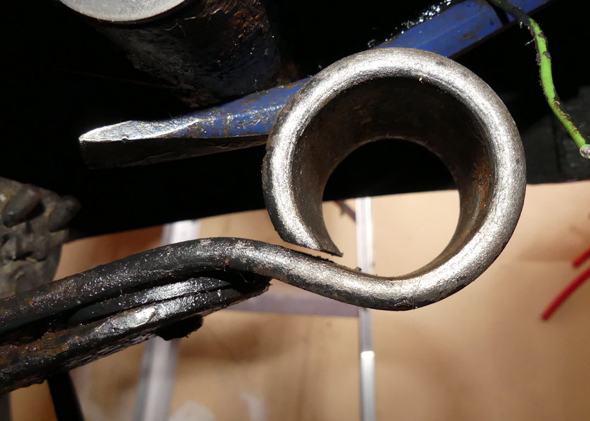

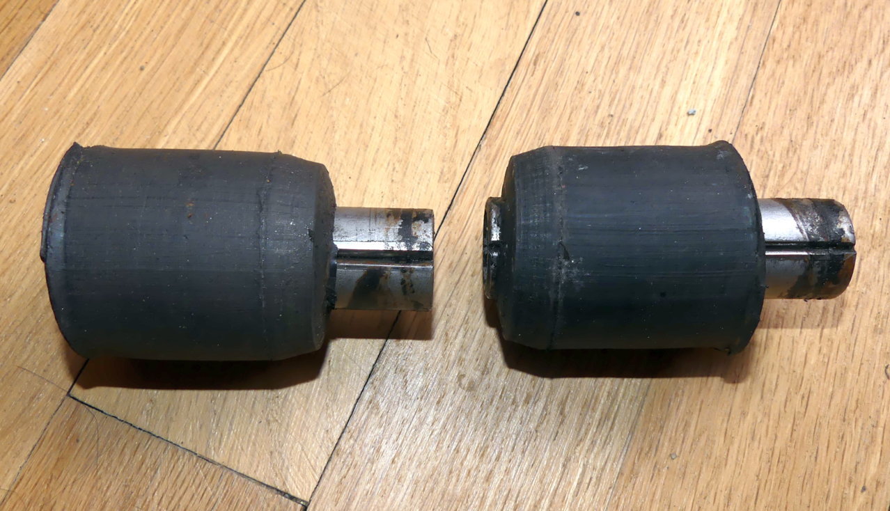

    was to send me new bushings, oh, & "free of charge". I sent him the pics mid-December & had not heard back from him. So I contacted him right after the New Year. So as this unfolded (there is more), the quick responses I once received, disappeared. The replacement bushings were two piece with the flanges. The ones installed in the spring were one piece. Does this matter? I dunno, except Toyota uses two piece for the rear eye. While there are one piece that allow for articulation, I believe this is the idea behind two piece that have a slight space where they meet. Can one claim to sell an OE product if this is not the same? Was this the issue with my springs? I don't know. What I do know is it was a PITB to press the old ones out. P2590146.jpg The sleeve was paper thin compared to the replacement ones he sent. The only thing I could think of to use to press the sleeve out was the new bushing, or at least get it started & deal with backing it out or whatever, later. Whelp, wouldn't ya know that bushing went right in & popped right back out. I thought maybe I was dealing with the issue I have read about with aftermarkets & stock bushings, so I went ahead did the other side (PITB). This time the bushing was slightly tighter. Come to find out the spring eyes had stretched & while the left somewhat tightened up after the sleeve removal, the right one did not. The stress marks on the shackle bolts was evident, especially on the right side. P2590147.jpg
    Sent him the pics & realized the springs did not resemble Toyota stock ones in more ways than just the bushings, although the pics on his site, did. (Very small pics). Course I kick myself for not having known better to look at them closer when I first received them. I sent him comparison pics & of course, had to call him & call him. Here are the comparisons. P2590144.jpg P2590148.jpg He insisted they were no different.
    I contacted the member who purchased his right after I did. This is what he sent. IMG_1015.jpg As you can see the difference in the leaves. His were more like stock. So, call I did & call again & wait. Meanwhile, all this time, I am in traction. & eventually, eventually, he sends new springs he just "happens to have found out back". Oh, & "free of charge". Did he advise me to use new ubolts? Maybe that is on me to know as I was self-installing, however being that I was still under warranty you would think they would have been sent with the springs.
    My point about the ubolts & you can throw the bushing solution he came up with, is that my safety was not of a concern. There was not a single moment along the way that he bothered to work with me to maybe figure out why this had happened. Nor was there ever an apology.
    The only time I received feedback was in regards to the first pics. He stated that they looked properly torqued, etc. & he had never seen this happen.
    Was it tha I am a "girl"? Did he assume that the only things I would be using my truck for was going to the mall & putting flowers in the bed? (his stereotype, not mine) I don't usually go there. But obviously, it has crossed my mind....
    Oh, & I decide to just purchase some ubolts locally. They were way "beefier" than the ones he sent back in the beginning. I regret not having purchased my springs from the local spring guy....
