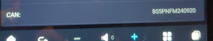

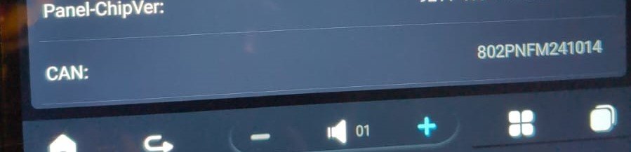

    I had the same issue with my recent install on the weekend. I contacted AuCar support via WhatsApp after 9PM EST which is 10AM China time. WhatsApp telephone number for AuCar support is +8615811876790. They asked for pictures on the SW version and determined I need a new can bus update applied. They sent me the binary "simplecanupdate.bin" about 52Kb in size.
    Instructions were to:
    1. format a USB drive
    2. copy the file to the root of the USB drive
    3. install USB into head unit usb
    4. navigate to settings>>system>>upgrade>>plug box>>protocol update - mine was not named protocol update, but the option was the bottom selection
    5. a progress bar will appear
    6. once complete, return to settings and select "save and reboot"
    7. After reboot all climate control functions worked perfectly
    Version before update:
    Version after update:

    That can version pic you posted was the same as mine. I got the file loaded up and immediately installed it. SHE WORKS!!! Thank you so much mang I appreciate it.

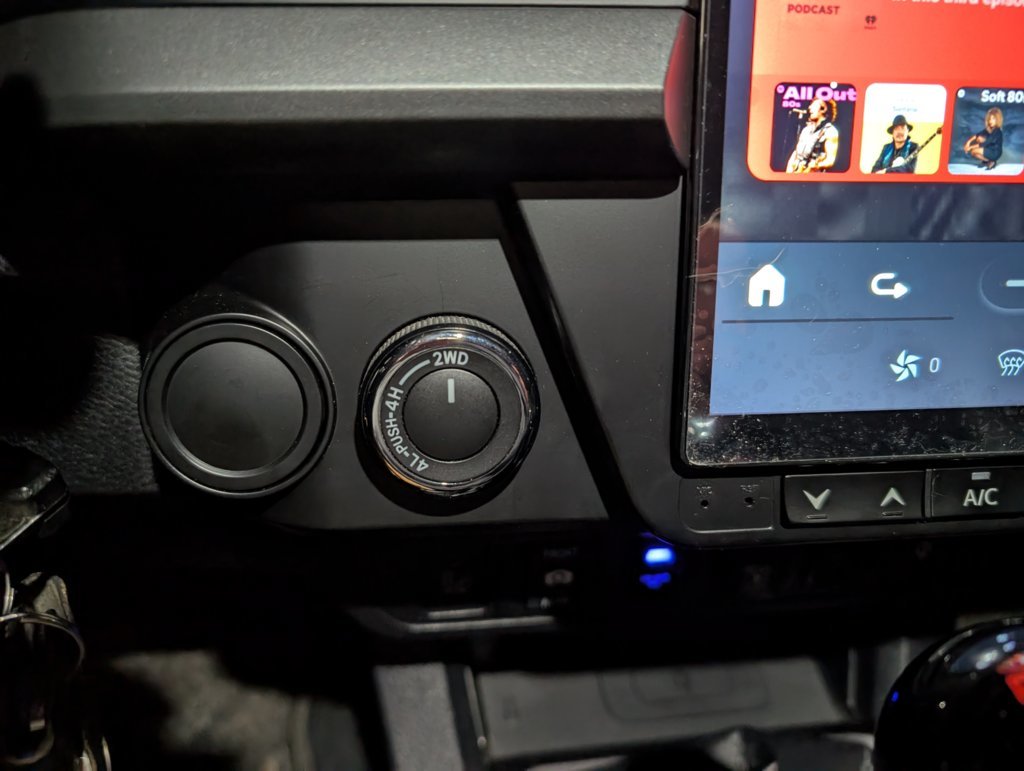

    There is a blank in the kit for the push button start.

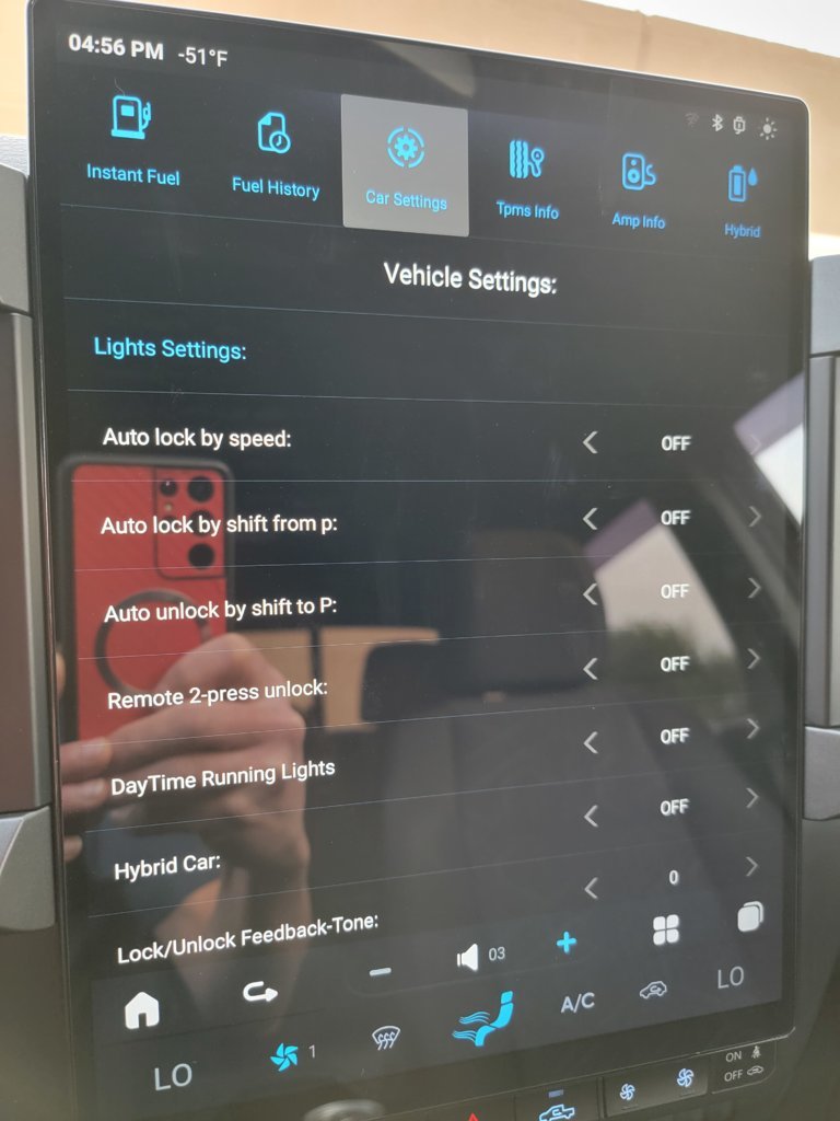

    Ok so now that I've kinda been checking things out since install, and since I'm not getting much response from their Facebook group, I've discovered a couple more things that need attention. One being the options in 'car settings'. None of the options here are changeable.. One of their techs said it needs an update but haven't heard anything back on how to do that..
    Another thing is the reverse parking sensor/radar beep is gone. I think that might be an rca that needs plugged in ( only plugged in the brown one) but not sure. I'll pull her out and see.

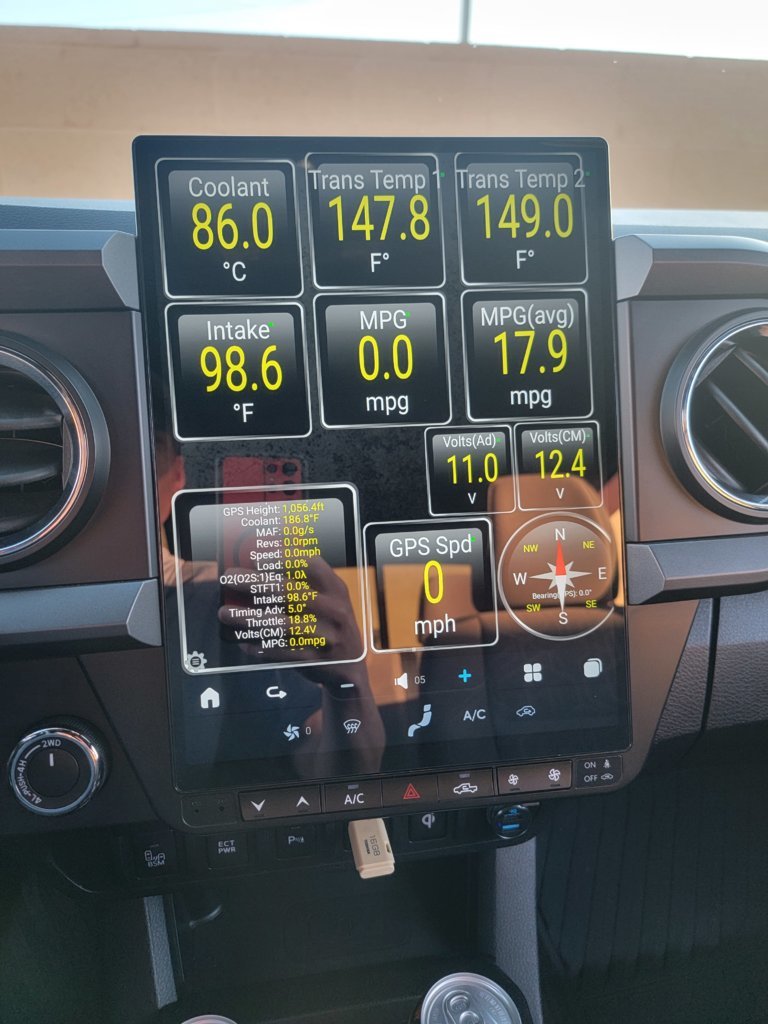

    Finally installed Torque Pro App. Used this on my 1st gen but on my phone. One of the reasons I got this unit. (Still haven't found a fix for the car settings regardimg my previous post, still gotta contact them).
    Link for custom pids for the transmission temps

    I have noticed that the car options are not working, but I had all the options set prior to the install of this head unit. The option setting were not changed after installation, just that the options could not be set by this head unit - yet.
    The backup/radar sound does work for me, I did not make any changes to head unit to enable it and I only have the camera plugged into a RCA connector on the head unit.
    Let me know if you hear anything from AuCar regarding a update. I asked them about enabling this "voice" button on the left hand side of the steering wheel to initiate a "OK Google" prompt. They replied, that it is not implemented yet.

    Same for me on the settings. And my dumbass didn't realize that the parking sensor button was deactivated after I had disconnected battery. Ha. So that works.
    And I did talk to them last night and got an update for the car settings. However there was a couple glitches with a couple of the settings. The interior lights option(works but glitched as showing "off" and doesn't change on screen, but does actually change the setting when hitting arrows) and the beep/feedback tone on lock/unlock no longer works. He sent me another update for the beep feature but am at work rn. Will install when I get home. And can follow up with you guys on that and send the updates your way.
