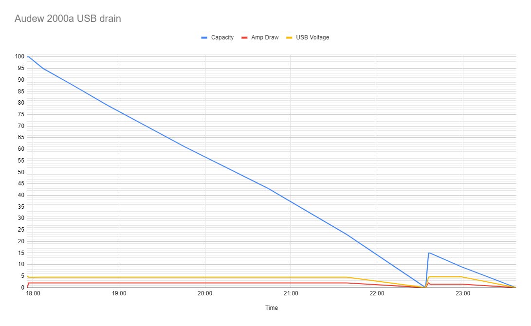

    I picked this up on Amazon prime day 2020 based on review from ProjectFarm on youtube. I charged it fully when I received it and threw it in my truck.

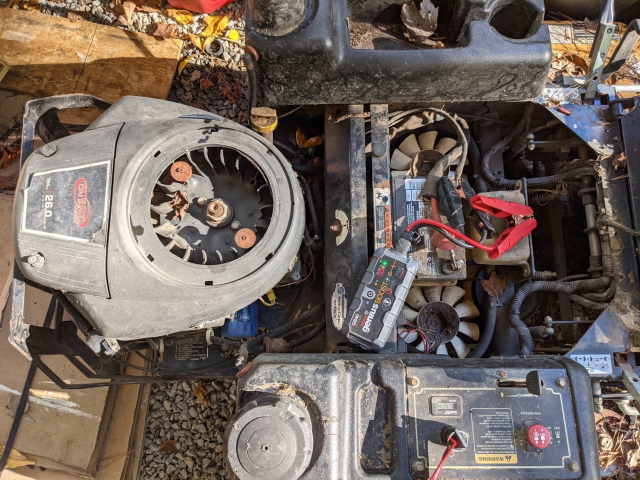

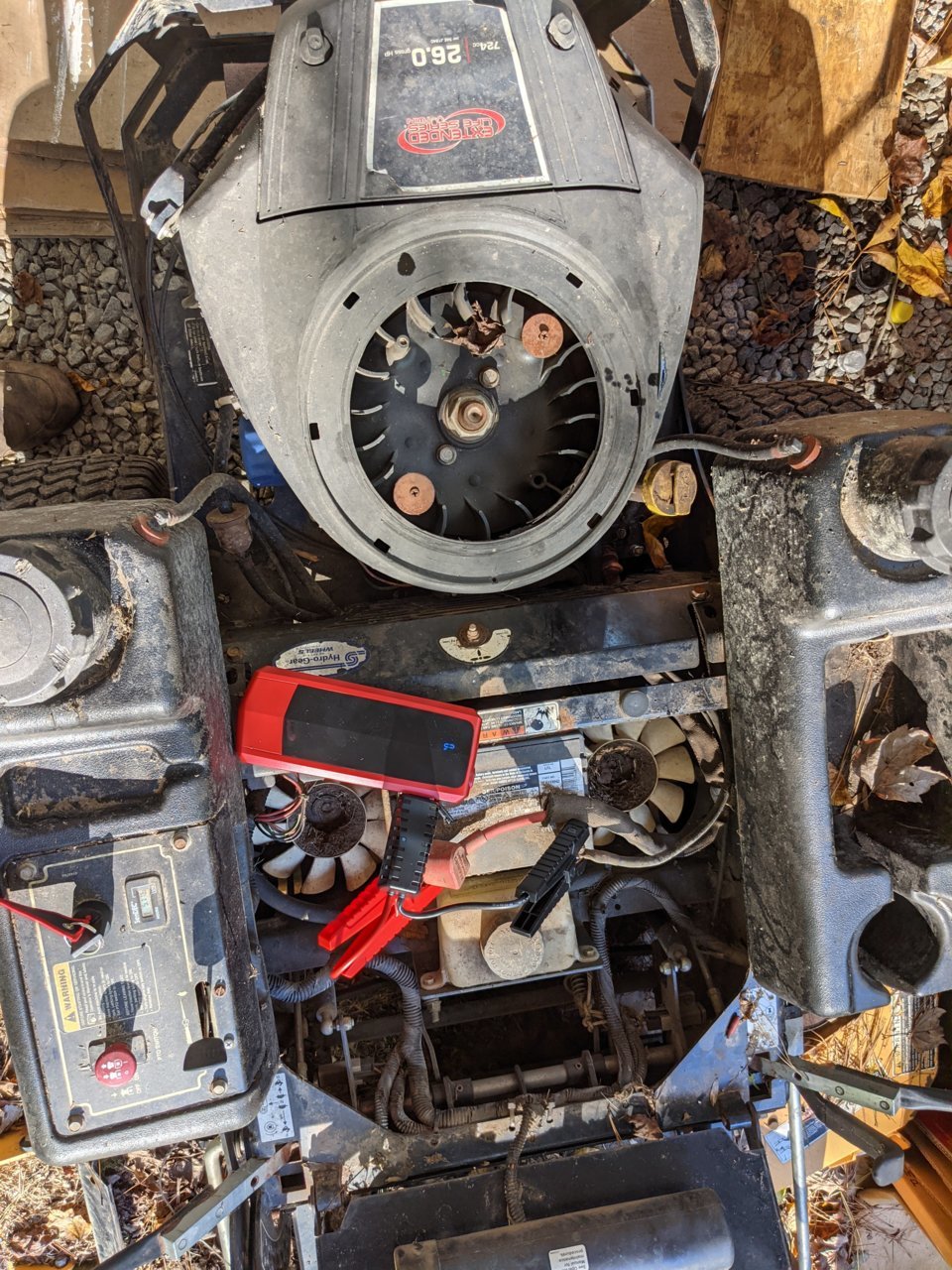

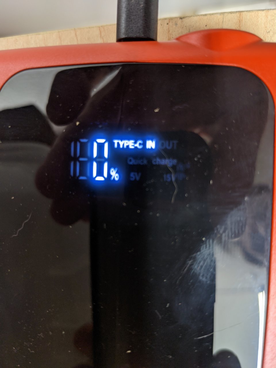

    Wanted to mulch up some leaves, lawnmower has a history of needing Jumpstarting, weak charging system but the battery wasn't flat. When I pulled it out of my truck it read 100% and immediately dropped to 93% as I was unpacking it. Cranked the mower and it wasn't firing. After about 1min the jump pack is at 0% and beeping.. If it won't start this lawnmower I wouldn't trust it to start my truck..

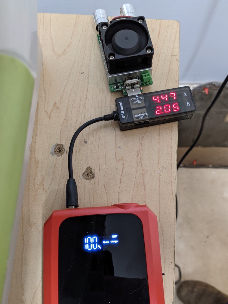

    Discharging with an adjustable Resistive load on the USB port

    Charging from fully discharged to fully charged to see if it holds charge better for next time.

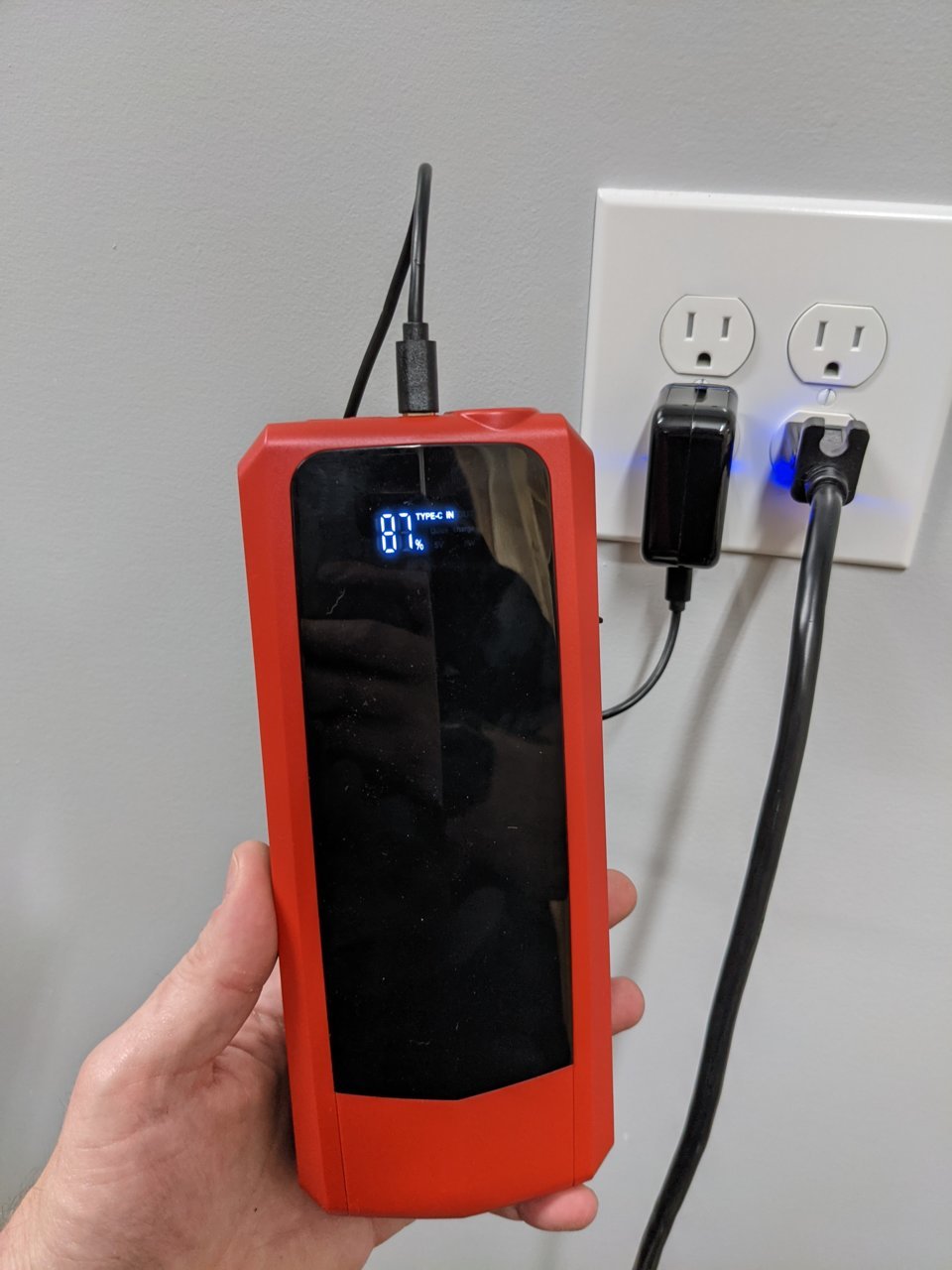

    Uhm.. I just took it inside, plugged it in with the supplied charger/cable and it reads 87%

    My NOCO booster had no issues fighting the lawnmower..

    And it's at 100% already after maybe 30mins.. I'm going to put a usb load on it to draw it down and recharge it again.

    100% 5:56pm to 0% 11:37pm with a 2amp load. Looks like once it hits 15% it shuts off, possibly. I restarted with 1.5amp load for the remaining capacity. It's plugged back in to recharge overnight.

    With a 2A load for about 21 minutes when voltage starts to drop off, your graph shows about 700mA-hours capacity at 2A with a 5V output, thats not much something isn’t right ...
