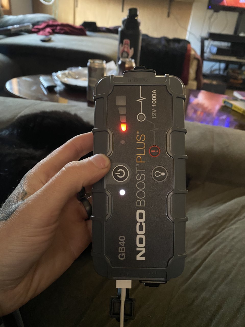

    Using my gb40 to charge my iPhone. Phone was at 30% when I started gb had full power. These little things are junk I will go back to a regular jumper pack soon I just have no confidence in these. Phone now at 95%. 549A7A13-37C5-46B4-85FC-DBB3BCCE6E89.jpg

    Like I said before, based on the Amazon reviews even the NOCO has about the same failure rate as the cheap “Chinese” brands.

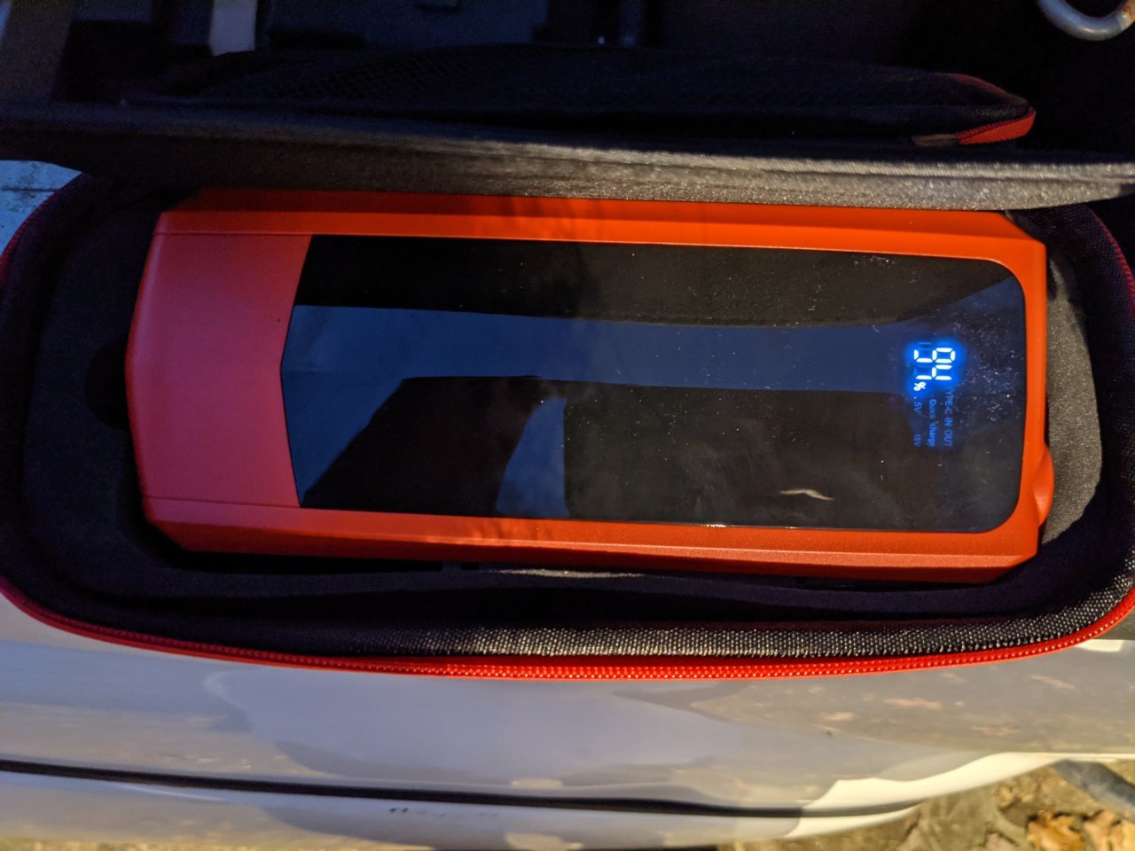

    Since y'all brought this back to the top I just checked the Audew pack. It's been in my truck with Rollercoaster temps from 30-80F. It's reading 94%.
