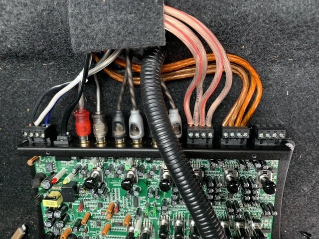

    E21DD522-49F0-40C3-9443-7034DC91B367.jpg E9CA9DF9-072D-4A06-9139-983BE468AC53.jpg DA936810-0DD4-4314-A11E-D04DC96E1095.jpg
    Middle pic is before I did the switching from two and 3 channels

    Everything looks ok there. BTW, what I meant with the switching the inputs, you would have your orange cables plugged into the middle one, then the clear/red stripe ones plugged into input 1(front) Then you would just swap the rca cables around.
    But, lets try a few things here. Unplug the subwoofer, unplug the rear on the amp, unplug the inputs except for the orange cables, put them into channel 2 (rear), also unplug your bass knob
    So you should only be getting sound to the front speakers and nothing else.
