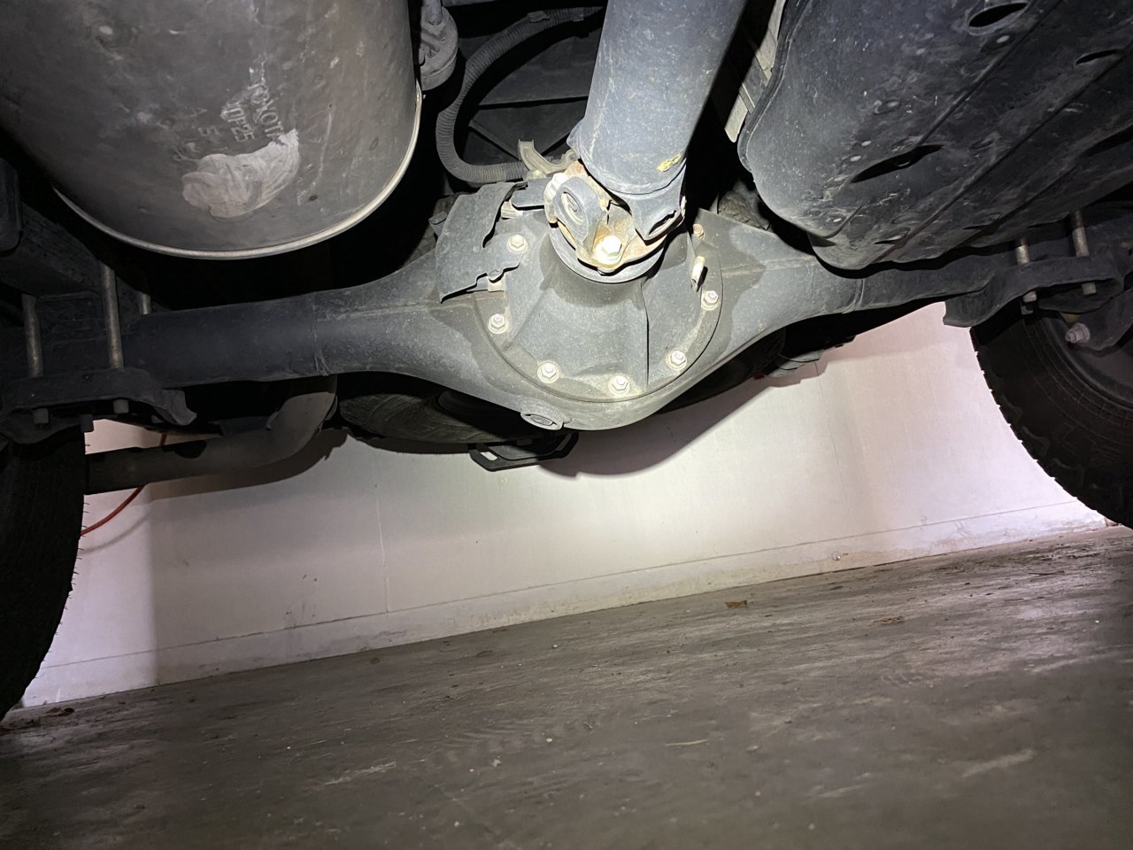

    Is this amount of rear diff seepage normal?
    2020 with about 44k miles.

    No, should be a 14mm I’d take a ratchet to all of the nuts in a Chris Cross pattern no more than a 1/4 to 1/2 turn. Clean with brake cleaner and watch what happens over a week or 2.

    Chris Cross? Or Christopher Cross? The latter lives in town, but don’t think he’s wrenching on Tacos anymore.

    No amount is acceptable. Like @MattCowsmasher said, check tightness. There all all 14mm nuts. Check the torque spec on em and see if any are loose. Most likely a failed seal, but you could get lucky.
