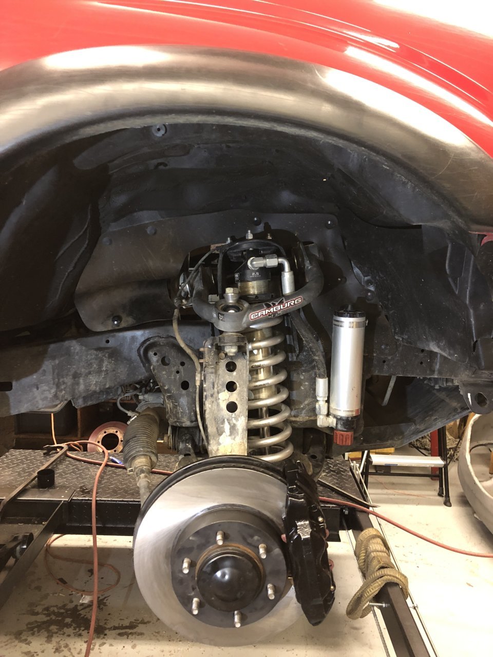

    It's a worn steering rack guide. Basically a little bushing that the internal rack slides on. Over time that bushing wears down and creates slop in your steering, as well as a clunking noise. I already did the tack weld mod which took a lot of play out as well.

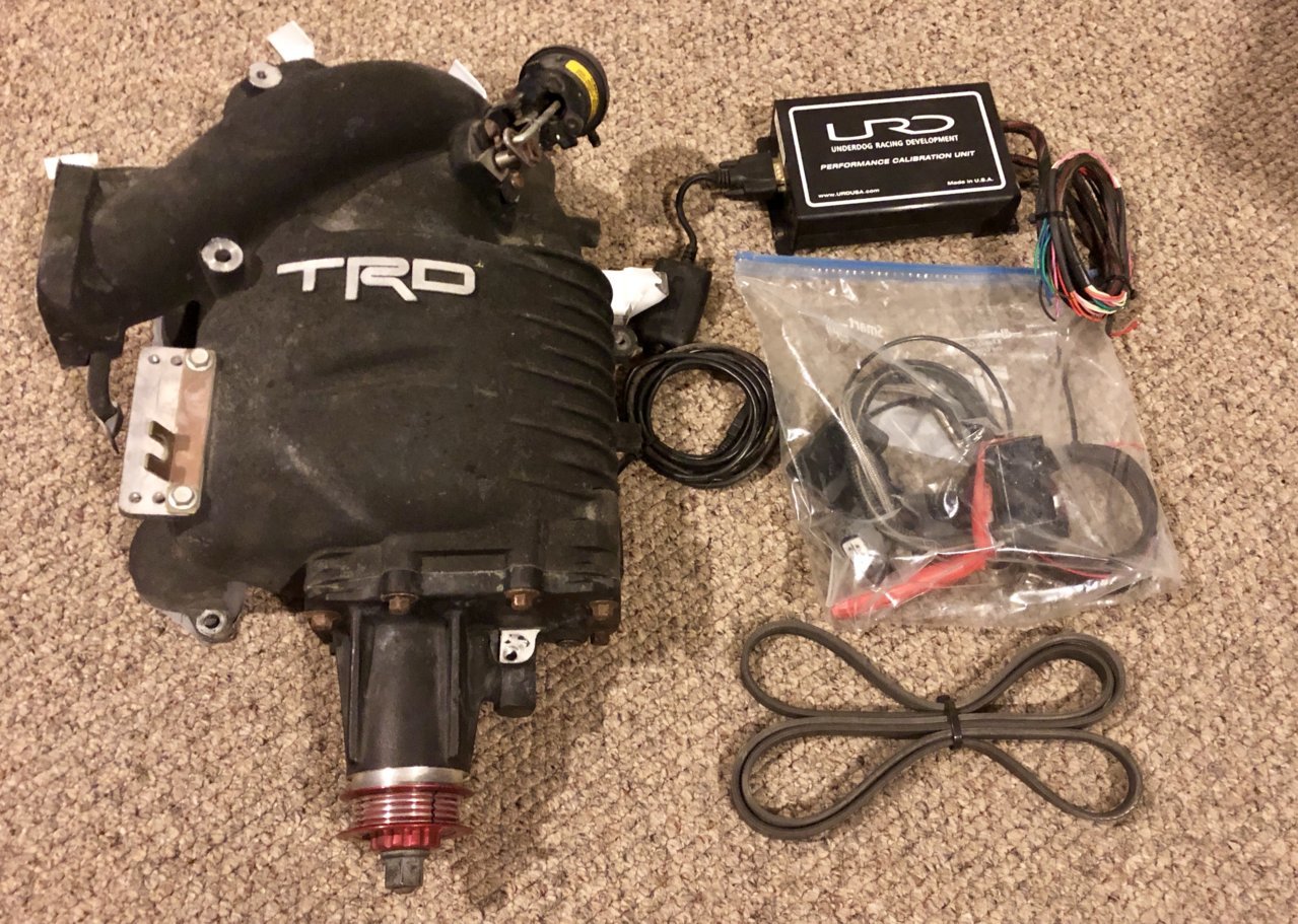

    Didn't plan on putting a supercharger on anytime soon but I found a deal that I just couldn't pass up. Came with everything I need to install, URD 7th injector, URD calibration unit, smaller pulley, and tons of extras.

    Hopefully more than whats pictured, a lot is missing.
    But still cool. They make the truck a lot more fun...also PITA for tuning..but mostly worth it.

    Yeah I have a ton of stuff out of picture. Pretty much double all the hardware I need. The guy I got it from found a supercharged truck at a junkyard and pulled all the hardware and lines off of it, in addition to the kit he purchased from URD. Just need to get the IK22 plugs and fuel pump that comes with the 7th injector kit.

    Finished up my 13WL tundra brake swap and ABS system delete.

    Louisiana
    01 V6 4wd PreRunner DCSB OME lift
    Good stuff good stuff.
    Also how ya like the camburg UCAs?

    They do their job. I've had no issues with them for 2 years.

    How was the abs delete? Just use the lines from non abs trucks? Always wanted to tackle this and the manual lspv at the same time.

    It was time consuming but not too hard. I just made my own brake lines in the area's where I couldn't just use or alter the stock brake lines. In addition to deleting the ABS, I replaced the LSPV with an in/out Wilwood proportioning valve.
    Here's a few links I found informative:
    http://www.off-road.com/trucks-4x4/project/project589.html
    https://www.tacomaworld.com/threads/abs-delete-2001-2004-tacoma.377243/
    I can also provide you with some photos of my setup if you would like?
