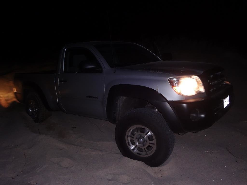

    Gotta 09 Reg. Cab Prerunner and i would be stuck a lot more often if it wasn't for Auto LSD.
    I've gone to Ocotillo Wells and was stuck once due to not enough momentum in super soft sand and the fact i didn't know where the trail went. Here's a pic of that stuck:DSC02475_zps58ba72a8_555279ec9589752cb19ac5e092c8b932e6f13d09.jpg

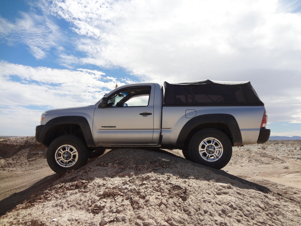

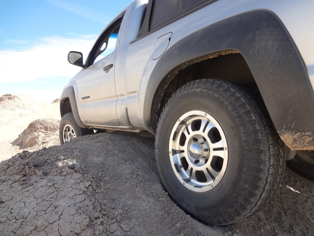

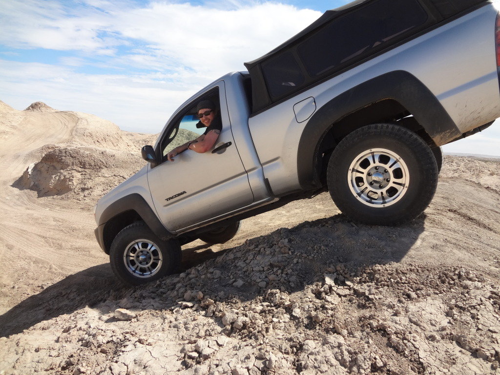

    Took my truck to Otay Mountain truck trail a few months back and went on a side road that was clearly not meant for my 2WD and started spinning my tires going up hill, one push of a button and up and over she went with not that much more of effort.
    Also took it out to TDS this last March and was goin all over the place out there in Truck Haven. Got hot headed and wanted to do some blind climbing and didn't notice how this hill was shaped more like a triangle and got high centered. Got out of that by Auto LSD doing its job and airing the tires down more to 15psi and some help by a few rocks around the tire. Heres a few photos of that:DSC02675_zps21e37e7b_677e4229442190f78db2b7bccace00655ee8dc8e.jpg
    and me off triangle-high-center-hill:
    i know its not a 4wd but every now and then its got the attitude of one.
