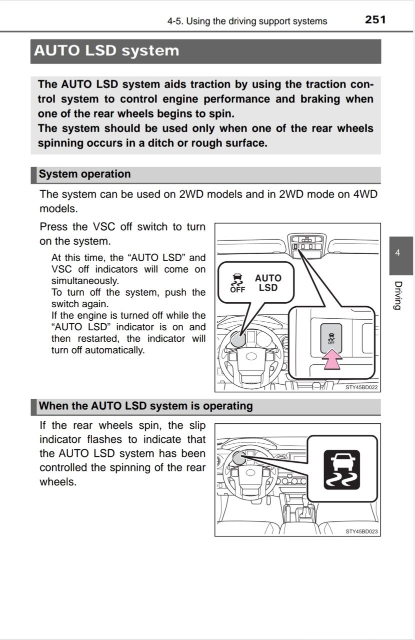

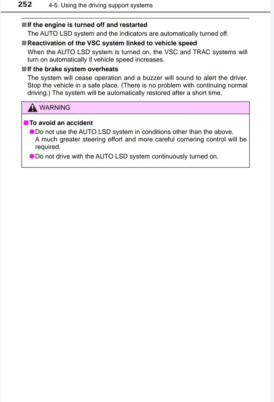

    Here is some information from the manual. Page 251 & 252 on the Auto LSD. It has a some important safety info in the boxes to be aware of.

    Please don't give answers if you don't know...
    The standard mode is called TRAC and is electronic limited slip using engine regulation and brakes to prevent tire spin.
    The Auto LSD is a 2WD traction aid that turns off the engine output regulation so there is no throttle-cut. Full power goes to the traction tire while brake force is applied to the spinning tire when TRAC isn't strong enough.
    You use Auto LSD to move from a stop when tire spin makes that difficult.
    To activate AUTO LSD, press quickly the VSC OFF button. To return to the standard TRAC mode, press the button again or restart the truck. The VSC turns off to 30 mph.
