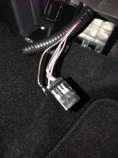

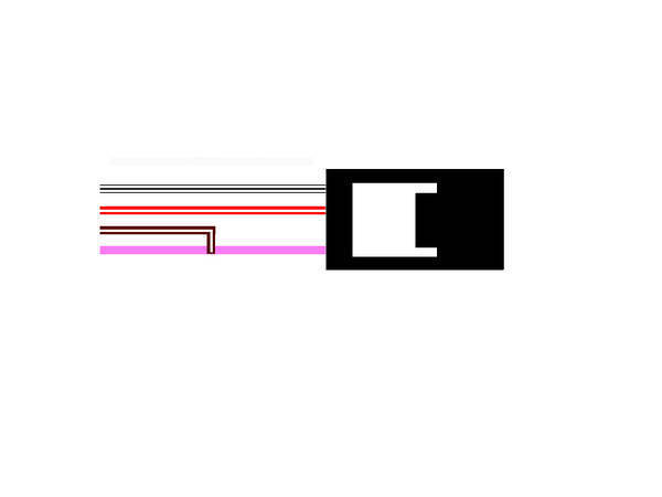

    Here's what the connector looks like and the color order:

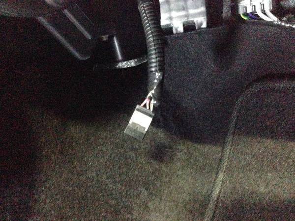

    Step two, Disconnect the connector and remove the white cover from the connector. This can easily be done using a small screwdriver. You wil also need to untape and remove the plastic loom covering the wires.

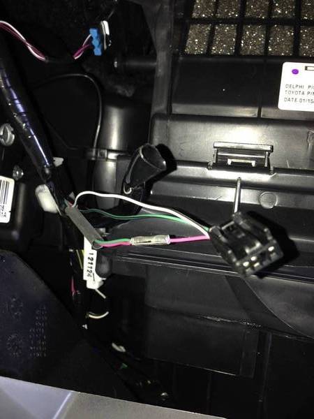

    Step three, the brown wire needs to be removed (or cut, if you cant get it) from the connector. I used a small nail inserted into the T shaped hole in the front of the connector to release the pin.
    Step four, I lined the brown/wht wire up with the pink wire and cut both of them simultaneously to be sure the lengths coming from under the dash were the same.

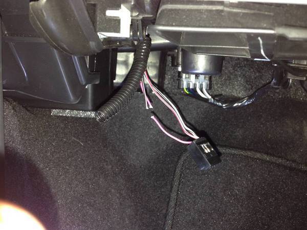

    Step five, strip both ends of the pink wire and the remaining brown/wht wire heading under the dash. (the other end of the brown wire which used to be going to the connector should now be loose and not connected to anything.)
    After stripping the wires, take the brown/wht wire and the pink wire going under the dash, twist them together, and crimp them into one end of a butt splice. Crimp the remaining stripped pink wire into the other end of the butt splice. It will end up looking similar to this:

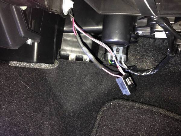

    I used an uninsulated butt splice along with some heat shrink to add a little strength to the connection but if you prefer to use an insulated but splice im sure that will be more than adequate.
    Ultimately you will end up with this:
    Final step, replace and re tape the plastic wire loom and plug in the connector, you're done! Feel free to turn that temp knob as far to the left as you want without fear of running into that dreaded MAX A/C! But wait, you want A/C now? No problem, its your choice, fire that sucker with a simple button push and feel the cool breeze flowing. The choice is yours now but please use your new found control only for good...:)
