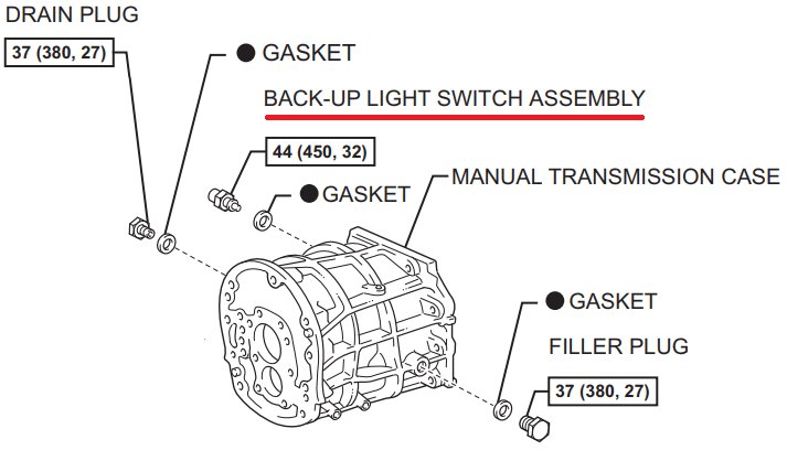

    05 PreRunner TRD Offroad AutoTrans
    Hood Struts, My version Fogs always ON, Map & Overhead Light Mod,

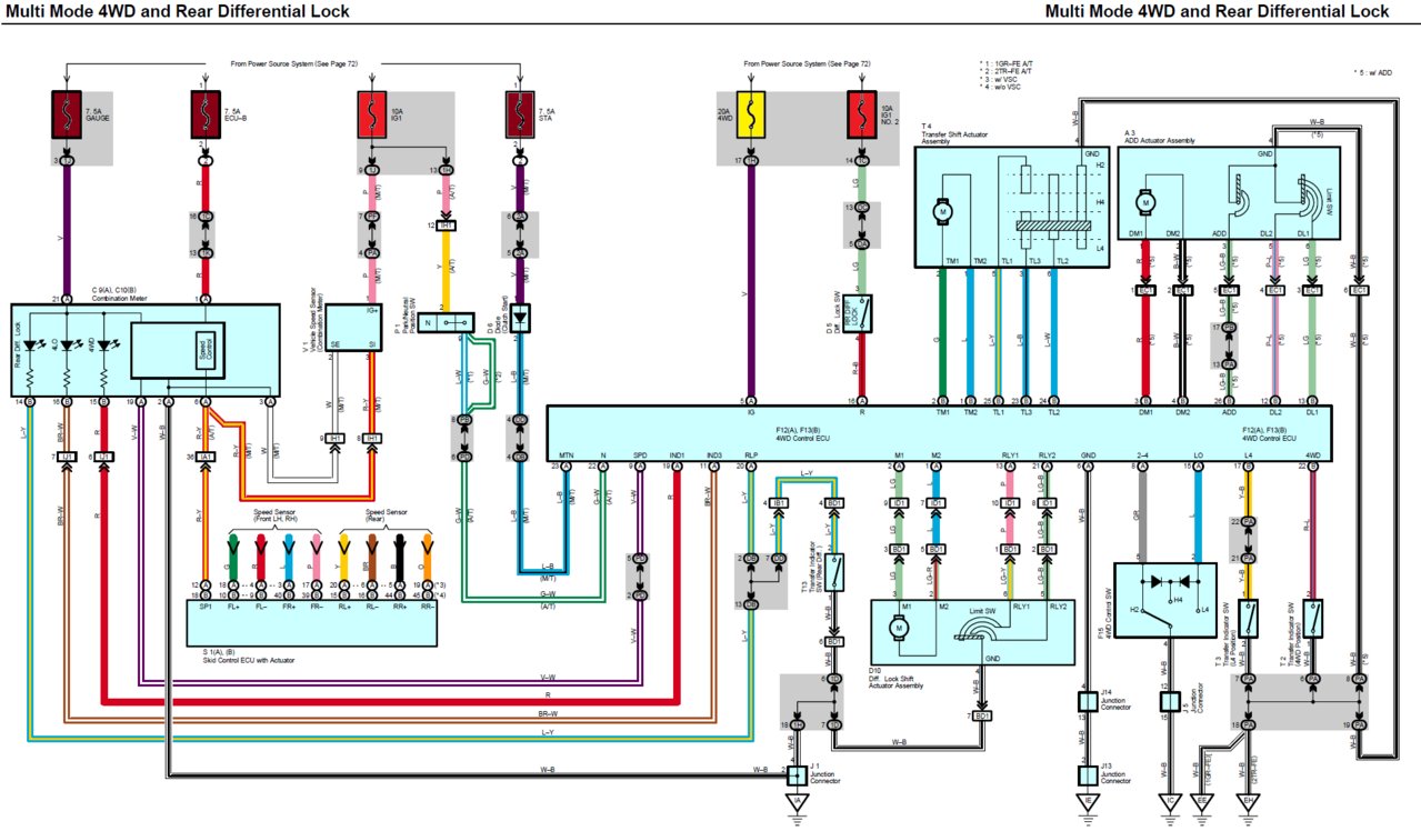

    Manual transmission only has a neutral switch & speed sensor.
  2. Mar 3, 2023 at 1:23 PM
    #82
    cfcarpenter
    cfcarpenter [OP] Well-Known Member
    May 29, 2018
    #254913
    328
    Clint
    PNW
    2005 DCLB 4wd MT
    Right but according to SparkyIX swap thread he had to put the auto harness in neutral permanently so the 4 low would engage. Maybe mine being a 05 wont need that? I guess I will cross that bridge when I get it moving was just trying to be a step ahead if that was the case.
    Thank you

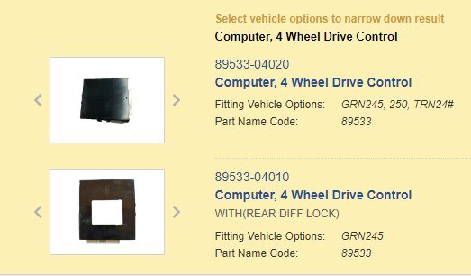

  3. Mar 3, 2023 at 3:03 PM
    #83
    caribe makaira
    caribe makaira Well-Known Member
    Feb 13, 2011
    #51121
    11,782
    Caribbean, Puerto Rico
    My guesstimate on that is his Taco (and yours) has the auto version of the 4WD Control ECU...not the manual version.
    Maybe:notsure:
    6 gearT444E likes this.

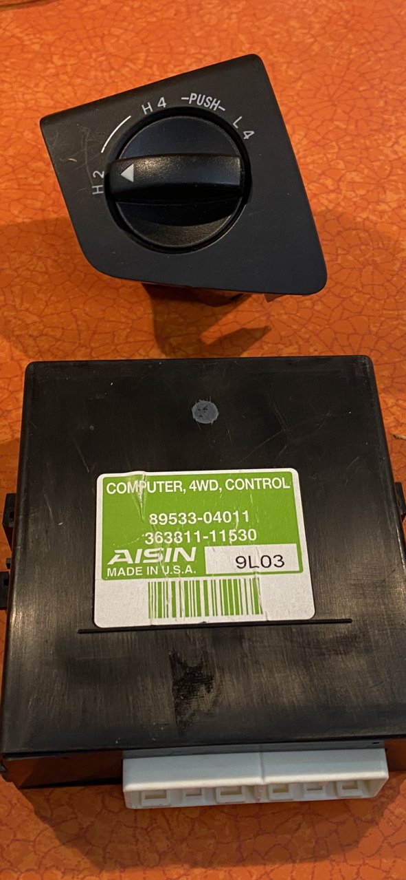

  4. Mar 3, 2023 at 4:24 PM
    #84
    6 gearT444E
    6 gearT444E Certified Electron Pusher
    Feb 3, 2018
    #243372
    7,798
    Deep South
    Herculiner Hootus
    this was the 4wd ECU out of my 6 speed. I think the difference between the two models is a 2wd and a 4wd setup. Not sure why there’d be a difference between an auto or manual ECU for the 4wd

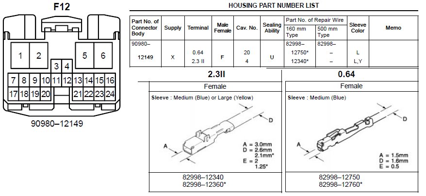

  5. Mar 3, 2023 at 4:27 PM
    #85
    6 gearT444E
    Feb 3, 2018
    #243372
    7,798
    Deep South
    Herculiner Hootus
    just wire ignition hot +12V to F12 terminal 22. That will trick ECU to thinking it’s in neutral all the time this won’t affect dash lights.
  6. Mar 3, 2023 at 6:22 PM
    #86
    cfcarpenter
    May 29, 2018
    #254913
    328
    Clint
    PNW
    2005 DCLB 4wd MT
    Ok where would I find the f12 terminal 22? Is that on the ecm?
  7. Mar 3, 2023 at 6:24 PM
    #87
    caribe makaira
    Feb 13, 2011
    #51121
    11,782
    4WD Control ECU

    Dm93
    Dm93 Test Don't Guess
    Mar 3, 2015
    #150066
    13,444
    Texas
    2014 DC OR 6spd 4x4
    Predator tube steps, Ranch Hand grill guard, Magnaflow CatBack exhaust, Toyota tool box & bed mat, 2LO Module by @Up2NoGood, Rearview Compass/Temp Mirror, Tune by @JustDSM.
  9. Mar 3, 2023 at 9:20 PM
    #89
    cfcarpenter
    May 29, 2018
    #254913
    328
    Clint
    PNW
    2005 DCLB 4wd MT
    Perfect thanks guys I’d be lost with out the help!

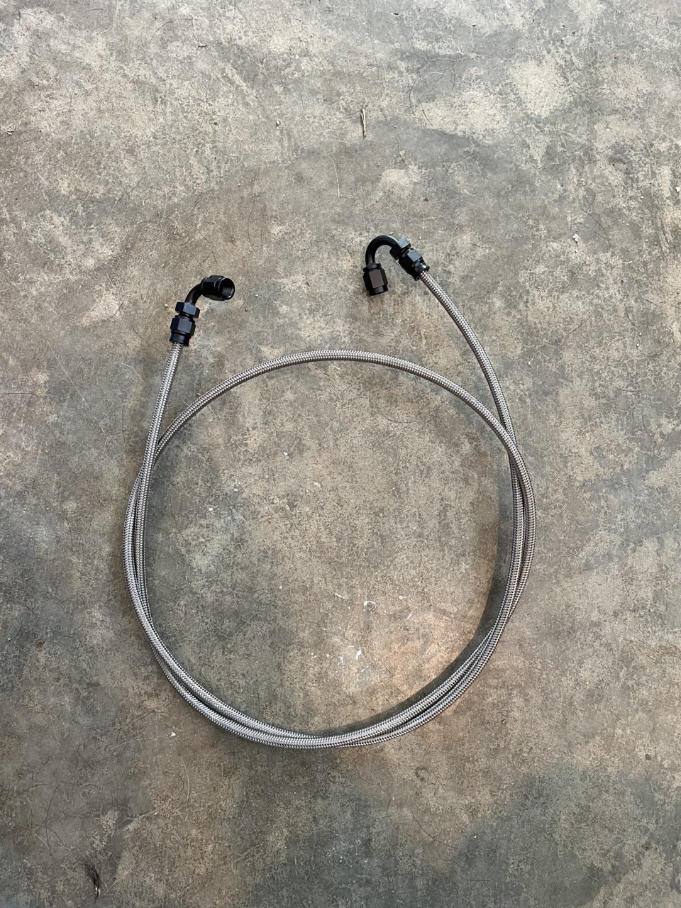

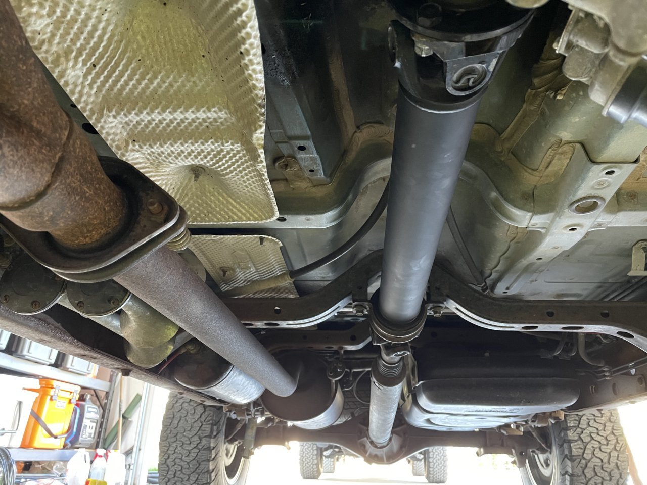

  11. Mar 5, 2023 at 4:52 PM
    #91
    cfcarpenter
    May 29, 2018
    #254913
    328
    Clint
    PNW
    2005 DCLB 4wd MT
    Here are a couple of pictures, driveline lengthened 1” fit perfect. Clutch line out of 3an braided stainless. Swap wise everything operates like it should. Idle is a little high but I’m hoping that’s going to correct itself as the computer re-learns. Only issue I have is non swap related, I believe I wired my adaptor harness for my 12+ hvac controls backwards. Just need to unpin and repin that. I still need to wire the auto harness to neutral, I have also not tested 4x4 yet.
