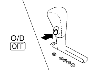

    Brah, this?
    mWqrdpIRdY6W_UMC8w_DAH-WI3sjHA14rHHvxZOe_d3c4bc36458ccc5aa2cc0d14d171dc5805ba6269.gif
