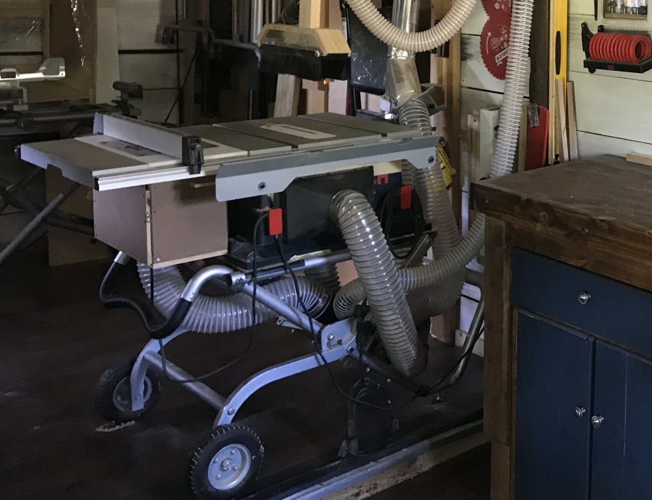

    Sorry this is an old thread! I use the iVac switch and Super Dust Deputy with a HF dust collector. I modified it to use a canister filter. I have four tools hooked to it with 4” duct, along with a sweep port and 2” aux hose. All have blast gates and actually works pretty damn good.

    Interesting. If your looking to go full budget, do a Thein separator. The dust deputy works amazing if you just want to buy something. Also when you switch from a shop vac, you’ll notice a lot better fine dust collection.
    As far as the switch goes, I have an extension cord ran to each auto switch. My stuff on the left is all on one, stuff on the right on another. My router is not on a switch because it kicks the iVac fuse. So that’s one thing to keep in mind. Depending shop size and saw amps, a foot switch or remote control switch might work better for you.

    It's a Sears Craftsman cabinet saw from 1974... recently acquired when my neighbor passed away.. I'm thinking I will take the saw off the base and insert a piece of 1/4 plywood and add a dust port into the plywood. I do have the tilt slots covered in the front and back.. it still makes a heck of a mess. The base I have covered on both the sides it's open and a 6 HP shop vac attached when it's running. I definitely feel like I can do better.

    Got ya. Google it, there’s lots of stuff on enclosing saws.
    I added a piece of wood and port to the bottom and a more enclosed port to the back of mine. The box on the left is for the router.
