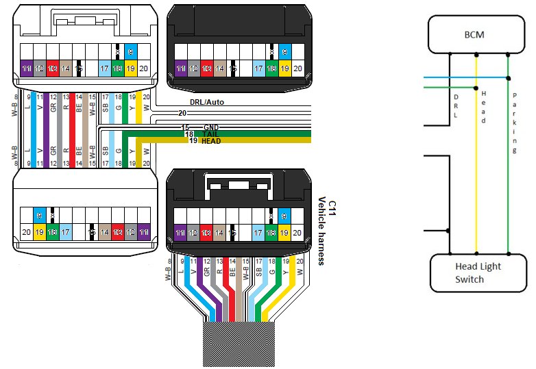

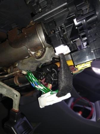

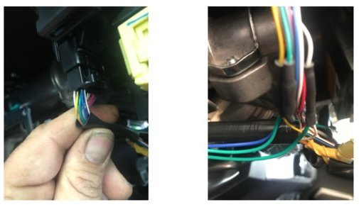

    Hood Struts, My version Fogs always ON, Map & Overhead Light Mod,
    Here's a no-cut, T harness to the C11 (light stalk)
    Contact @kmorgan3 , there's also Hot & Ign power source at OEM radio harness (N24) which also can be assembled into T harness.
