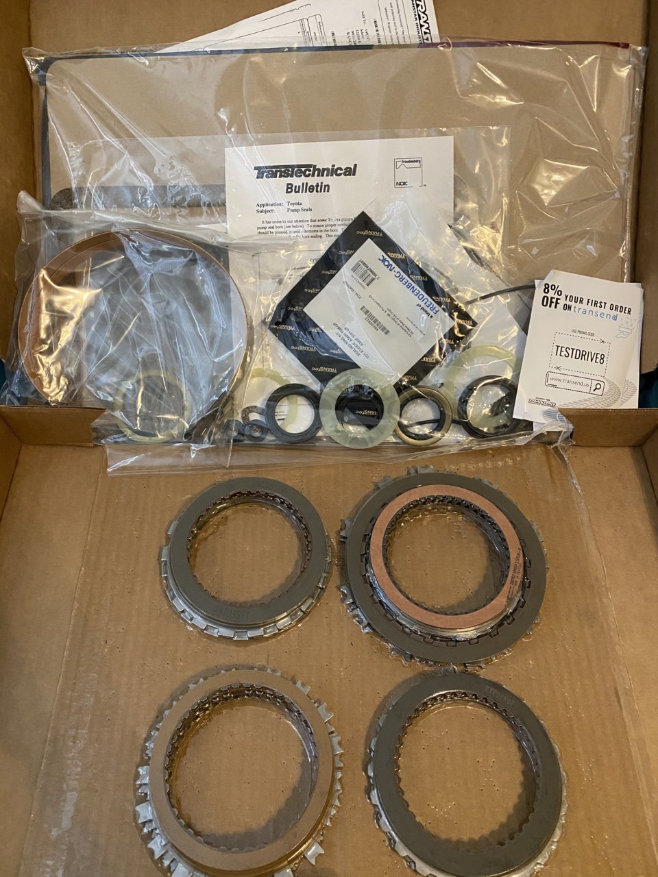

    I just rebuilt my A340F for my Prerunner conversion and I got all my parts from Transtar Industries. They make really nice kits with much better parts than most kits. I don’t know where you live but they had a will call location about a hour from me or you can order online. Their website for ordering is Transend.us they have the rebuild kits, bands, torque converters, and some hard parts as well. Hope this helps

    This is the kit I got from them, had steels, fibers, sealing rings, O rings, plastic washers, pan gasket, check balls, and a few other things. The band does not come with the kit and has to be ordered separate. I think I paid $260 for the main kit and $40 for the band. Not bad when RockAuto wants $242 for their kit. I would much rather use a kit from a company that supplies transmission shops.
