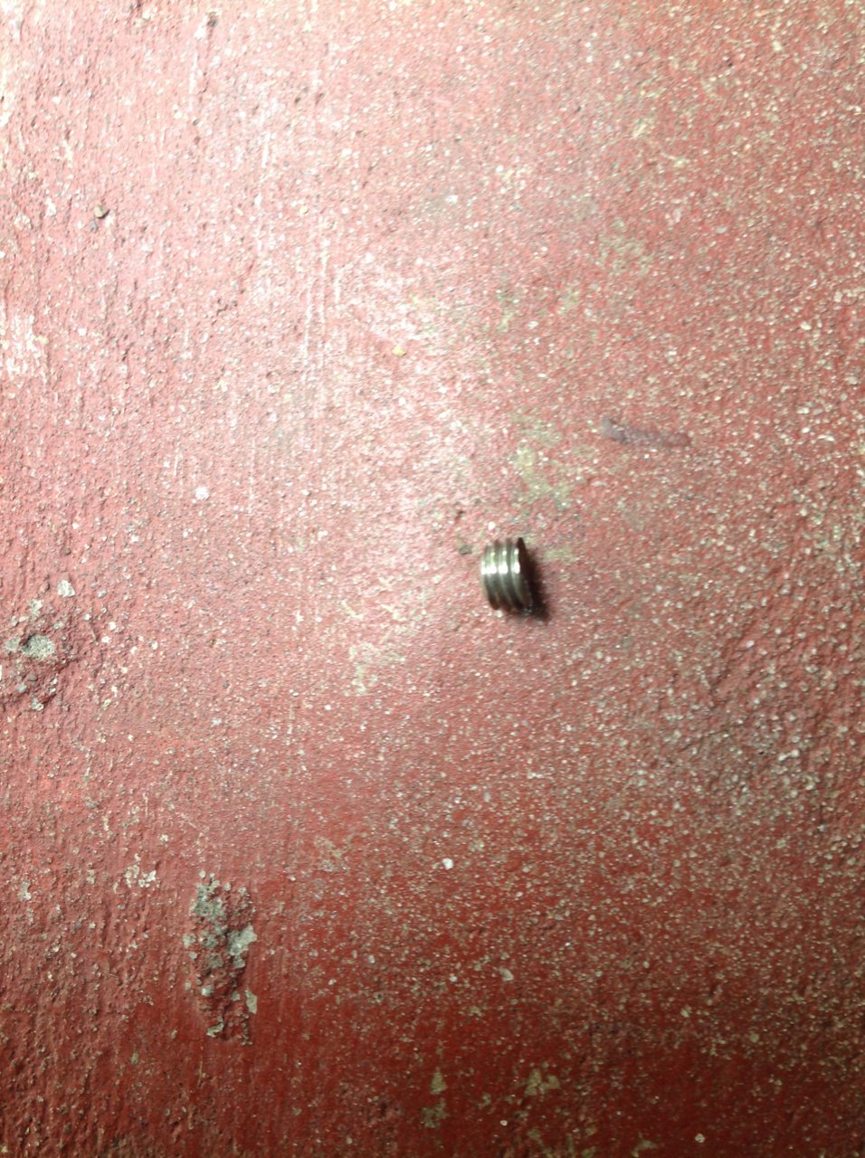

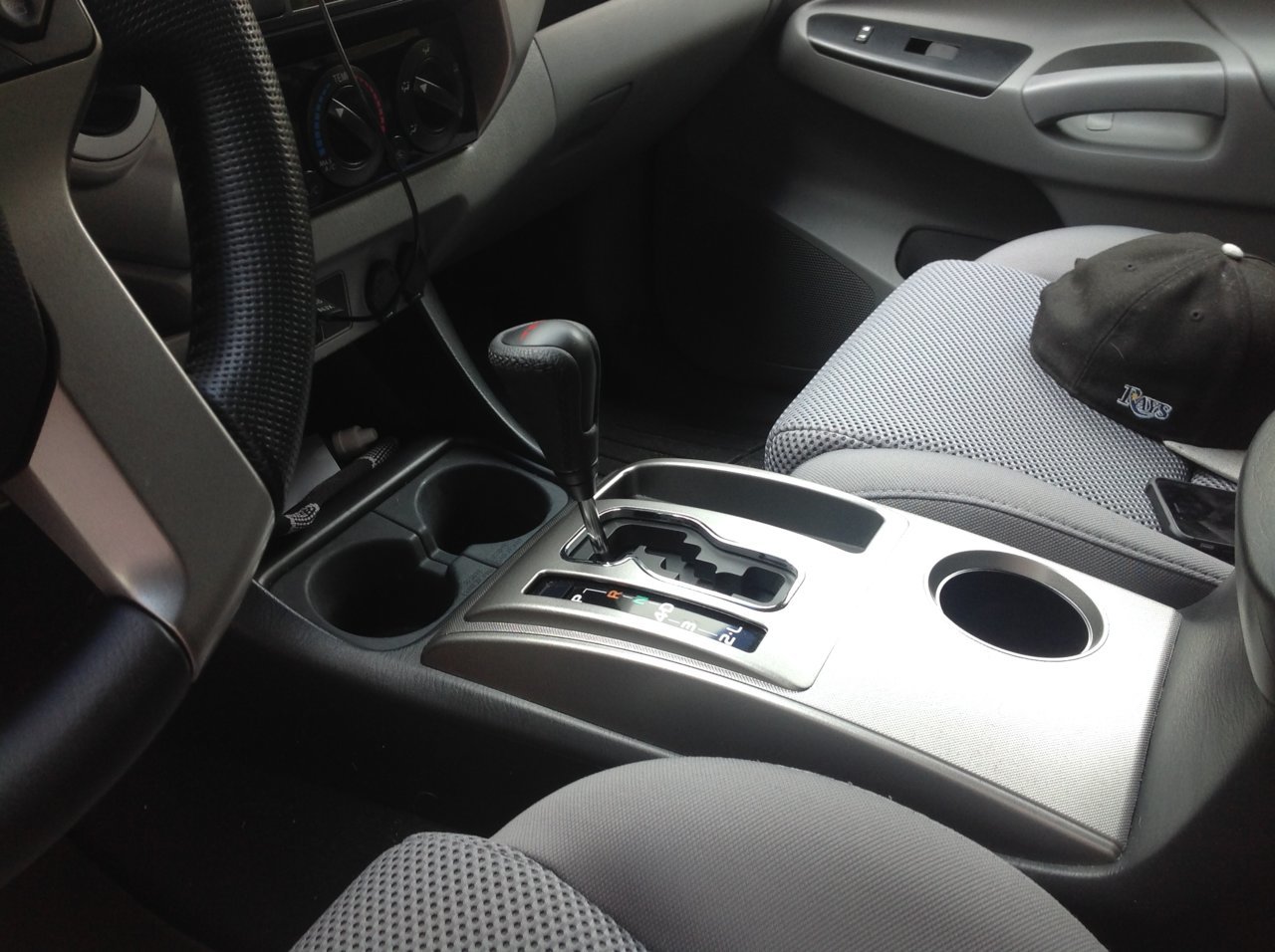

    image.jpg Alright , the TRD knob is here ......... here is what I cut off and the end result . Very happy with it .IMG_1410.jpgIMG_1409.jpg

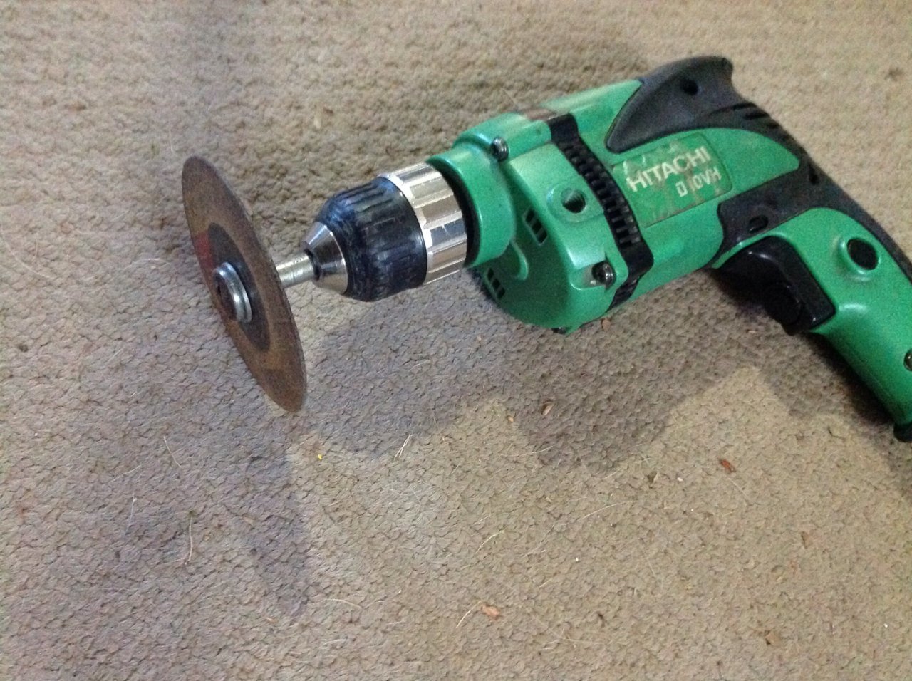

    What kinda tool are ppl using to cut the shaft?​

    I want to do this so bad!!! How’s it cut!?!

    Hacksaw, dremel tool

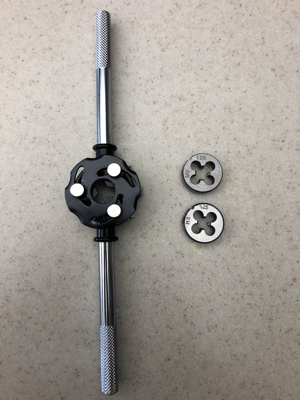

    I love this thread. Thank you very much. I did this mod to my truck and love the look and height of the shifter now. I had trouble getting the die past the thicker area.. so I used a M9 x 1.25 die to cut down first and then followed up using the same M8 x 1.25 die to cut the finally threads. I found this to be easier for me and just wanted to pass on this information.
