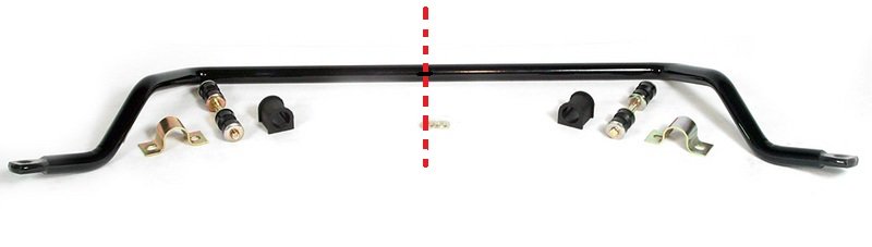

    Just thought about something, could be completely retarded or even discussed before, but here goes.
    What about fabbing/modifying a sway bar into two pieces, split down the middle. Somehow having a cable tied to a strong pin/fastener to hold them together, and when you want to remove, just pull the cable to release them to allow for better articulation. Not sure what sits around the bar above the skid plate, or how it will move around in there if cut down the middle like that.
    Any input?

    I'm thinking more along the lines of this unit from Speedway Engineering:
    http://www.1speedway.com/608_175bars.htm
    The disconnect unit could be at the splined ends, or perhaps just at one end. The bar can't function unless both ends are attached. This set-up could be accessable enough to be a manual thing similar to a mini locking hub. I'm just talking concept here. I haven't measured anything.
    Whatever you do would have to be a spline of some kind. A pin won't work on the bar.
