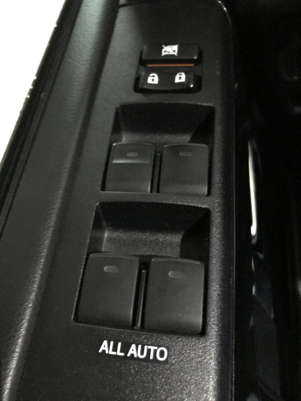

    4Runners since 2010 are all auto up and down on all 5 windows.
    5570EA3F-268B-48D8-8B44-5F48DFB9FBC0.jpg D521E134-8DAE-4AB1-BCB2-015C7FC3520F.jpg
    shakerhood likes this.

    My 4 runner says the same.
    Wish Toyota did not change it to say "all auto" I miss the "FULL AUTO"
