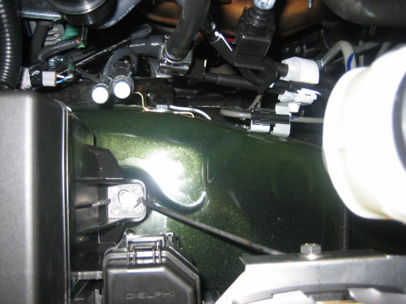

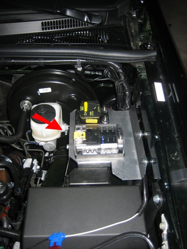

    I've completed cutting/bending the panel and fabbing the main support, however, the back edge is still a bit flimsy. Do you think it would be a good idea to use the lower bolt on the master cylinder?
    Panel - 22ga steel sheet (probably should've gone 16ga on this, oh well...)
    Main Support - 1/8" steel rod
    Here's a wide shot showing the bolt I'd like to use...
    This is the main support, utilizing a bolt in the main fuse box mount...

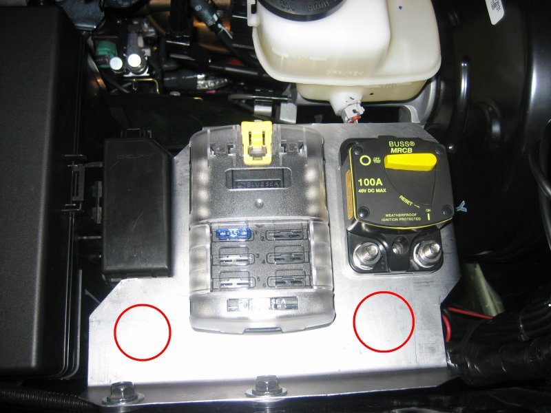

    General shot of the panel. I still need to cut out the red circles for routing wires... or do you think I'd be better off cutting slots or smaller holes to maintain integrity?
