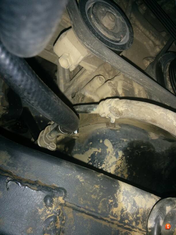

    Either way is fine. Bypassing the stock cooler will keep the strawberry milkshake from happening. However, from everything I read it appears to be a 4runner issue. If you change your coolant regularly you shouldn't have any corrosion inside.
    The zip ties are ok if you don't wheel but they'll break eventually.

    How hard are these to install? I can do it, I'm just more worried about trying to disassemble the from of the truck

    It would be a good ideal to leave the rad. cooler in place. With no air flow in traffic and no water cooling you are running a risk of high trans temp.

    If you can turn a screwdriver and squeeze some pliers , it's very easy. It took me longer to figure out I was going to install it.
    Remove the skid plate and look for the two hoses that go to the radiator. Then follow my diagram on how to plumb the hoses.

    I'm just more worried about bolting it to the front
