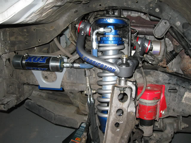

    Well I am on the waiting list for my Camburg kit at the moment and I have been tossing around the different options that are available for my whip. My thoughts are this- spend a small fortune and do my truck right with the Camburg LT kit, Deavers in the rear with a bypass and bumps at all corners. The problem I am coming to realize is this- If I have the truck built like this I am going to want to use it! The kid in me says "shut up and do it!" , while the adult in me is saying "Dont be an idiot! your going to ruin your 35,000.00 truck" I have been down this road before and built a street driven Pre-Runner and having the ability to go fast off road makes you do just that. Its all too familiar to me to get a few friends in the ride and want to show them what shes got! Next thing you know you think your Ivan Stewert racing the 1000. When the dust settles and you get back to realization you realize that your daily driver has just been beeten down with a wet stick and now makes all kinds of new noises! So that being said I think I might go with another solution. This "Mid Travel Kit" will absolutly do the job and for a fraction of the cost. What do you guys think...?
    Fox 2.5" Remote Reservoir coi overs in front, Fox 2.0 Piggy Back Reservoirs with C/D adjusters in rear, Total Chaos UCA's, Deaver replacement progressive leafs, Donahoe Racing "Chubby's" bump stops at all corners.
    This kit will provide a true 12" of wheel travel in front and 14" in the rear. Enough to get with it and keep up- You would be surprised at how good these Fox's work togeather with a bump stop. The bump stops are the key to the equasion - they will lead you through the deep whoops without bottoming out.

    Sounds like a good setup thats cheaper than a true mid travel kit. Can you really get 12" of travel out of the front with only some Fox CO's and UCA's? The mid travel kits only give you 13-14" of travel and are much more extensive and require 'glass.
  8. Feb 4, 2009 at 8:28 AM

    I think you meant the long travel kits give you 13-14" of travel.
    And those travel numbers assume 2 wheel drive in most cases. Even with a long travel kit the CVs are a limiting factor to wheel travel.

    Ah, yeah. I guess I meant LT. I know the CV's are the practical limiter to the travel but can some simple CO's and UCA's really give that travel? I thought the travel on a stock Tacoma was only about 8", that seems like a big jump to 12" just for adding the CO's.

    My thinking too. I know I'm not seeing those kinds of travel numbers.
    At least, my suspension isn't making those numbers willingly. ;)

    You must not have seen my Barstow carnage pics. Broke an upper control arm in half, snapped 2 limiting straps, and turned my shock oil into a frothy mess. :devil:
    Edit: Forgot to mention that I mangled the uniballs on both UCAs before the passenger side gave up the ghost. You can get those numbers out of a mid-travel. Just not for long. ;)

    The Fox 2.5" Coil overs that are made to be used with a replacement UCA have additional droop travel giving them increased wheel travel.

    Didn't know that. Is it a different shock housing, internals, or a combination of both that give the additional droop?
    Wondering if I could modify mine for additional travel when they're opened up for revalving.

    They can change the internal adjustments on both. Thats why these bumps are great- they have compression and rebound controll unlike others.
