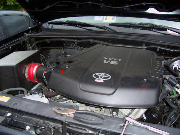

    Start by removing the negative battery cable, this allows time for your computer to reset while doing the install. Remove the two 10mm bolts from the top of the engine cover, take it off and set aside.

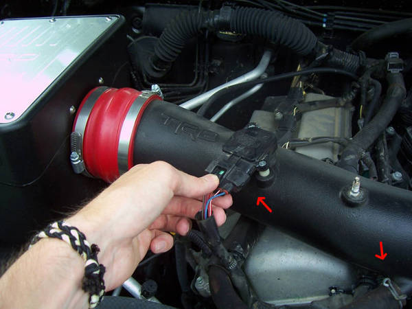

    Now remove the MAF sensor wire harness by squeezing down on the clip and pulling back. Also remove the valve cover breather hose on the front of the intake tube. You wont need to remove the long vacuum hose. Now you can unscrew the (4) hose clamps that hold the intake tube in place.

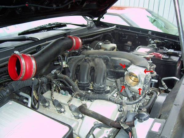

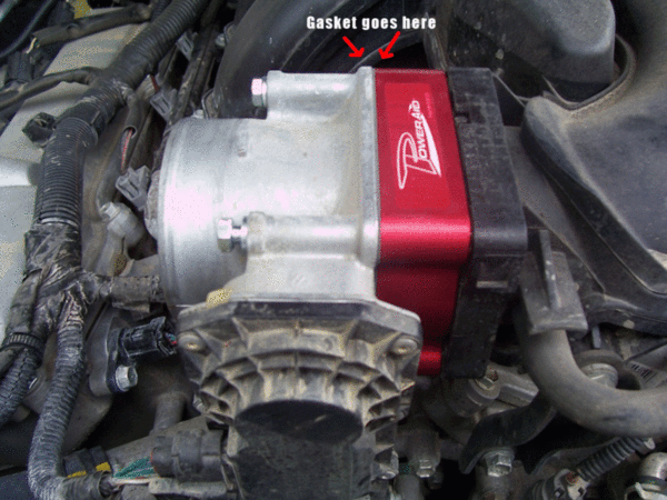

    Place the intake tube back next to the fire wall. Unbolt (4) bolts on the throttle body and place the bolts somewhere out of the way. Place the Poweraid spacer between the throttle body and intake manifold there will be a "TB Side" marked on the spacer this side goes toward the, you guessed it, Throttle Body Side along with the supplied gasket.
    Reinstall the (4) new bolts and washers that were supplied. Be careful not to over tighten, its only brass fittings in there!

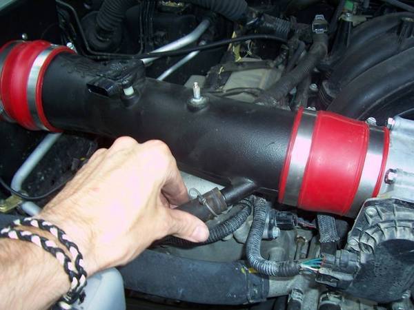

    Now reinstall the intake tube, tighten hose clamps and reinstall MAF sensor into its connection and the valve cover breather hose. The Airaid instructions now go on to say reinstall the engine cover, i decided to leave it off, I like looking at all the engine parts. Now reinstall the negative battery cable and your ready to feel the benefits. this is the finished product with no engine cover.
