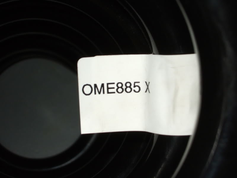

    Bilstein 5100 set at 0, OME 885 coils, 1/2" Top Plate Spacer, Light Racing Upper Control Arms, Alcan AAL, 17" Moto Metal 951 ALL BLACK, 285/70/17 BFG A/T, Depo Black Housing Headlamps, Onex 4300K HID/3000K Fogs, FLM, Toyota Optional Skid Plate, Avid Offroad Sliders, K&N Drop In Filter, Centric Posi-Quiet Front Brake Pads, USA-Spec DF-Toy, Sirius Sportster 4
    I think the only way to tell if you have the newer version of the OME885 springs is to check the part number. When you get new springs, there should be a tag on a coil that has the part number. Older versions were simply "OME885" whereas the newer versions are "OME885X". I talked to ARB about this when I received one of each type of springs in a box (their is still old stock floating around out there). The OME885X are the new versions and they have a higher Nickel content. This effectively makes them lighter and stronger...less chance of sag.
    And here's a picture of my spring showing the p/n with a X at the end.
