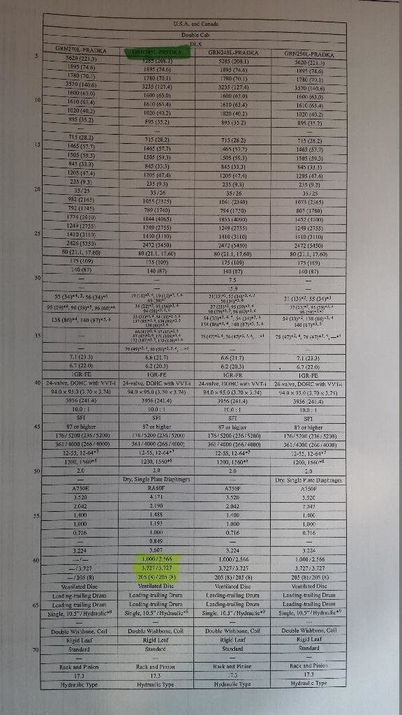

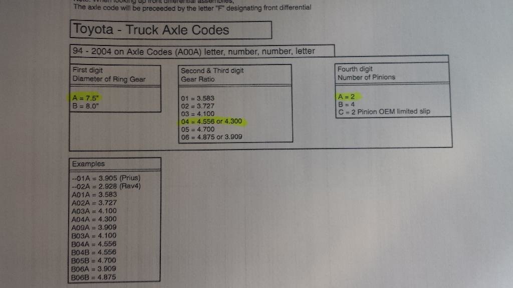

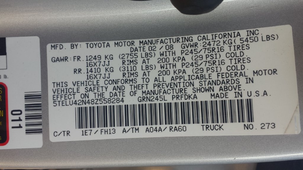

    So once upon a time I was trying to find out what gears and axles my 2008 DCSB have and went to the dealer and had them pull me the build sheets.
    Which one do i believe, as they are contradicting...

    last pic shows for 1st gen tacoma...
    aren't you looking for a 2nd gen?

    2008 tacoma with a V6 will have 3.73

    ring size depends on whether you have an e-locker or not...either a 8" or a 8.4" for the rear...fronts are 8"

    DAMNIT, I read that axle sheet as 94-2004 "onward".
