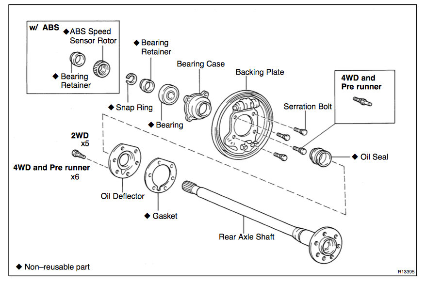

    Not sure if it is different for your year. On the 2003 it is an oil seal, the one all the way to the right in the diagram below. Had to replace mine. It gave out and dumped gear oil into the brake drum, which made for an interesting and stinky braking experience. Anyone have a diagram for a 1998 axle?

    Think I found the correct Toyota parts diagram on Camelback's website. The link is for a 1998 w/ 4WD. Looks to be the same setup as the 2003.
    http://parts.camelbacktoyota.com/pa...siteid=214329&vehicleid=84922&diagram=8510555
    It has two different parts numbers for the same diagram number, both referred to as an oil seal.
    inner: 9031050006
    outer: 9031348001
    9031348001 should be the one I'm thinking of but would have to check the invoice when I had the dealership do mine. Brought in the axle shafts and let them do all the cutting and pressing.
