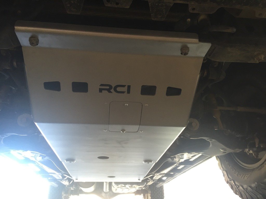

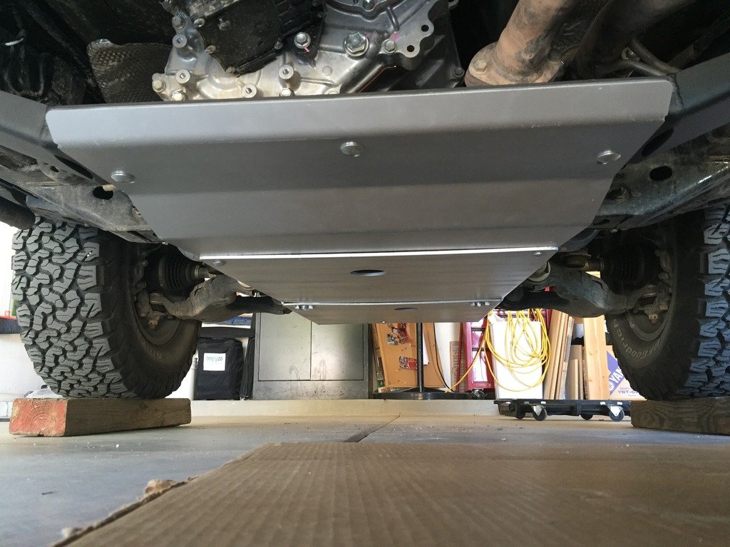

    1" square aluminum spacer in this last pic to clear the exhaust. Will see how long it last if I take a big hit.

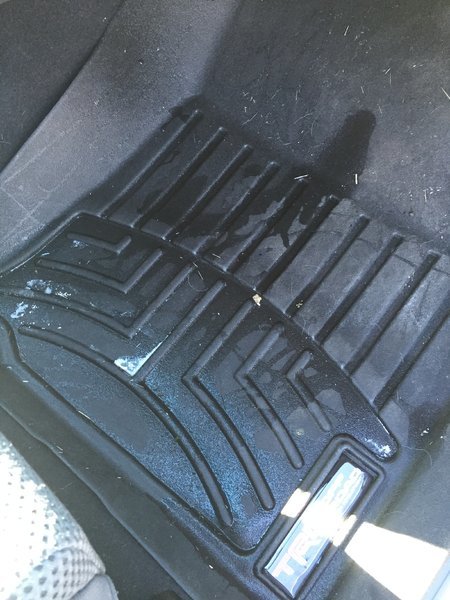

    Anybody ever seen water leak into the passenger floor board after getting a car wash? It's not much but enough to be alarming. Didn't come from below or from the door. Looked under the dash and there was some drops of water.

    Its happened to me before. I actually saw it dripping down from somewhere behind the glove box. Never did figure out where it was coming from.

    I'm pretty pissed right now. There's a lot of electrical down there.

    ^ that's not good at all. I would be pissed too.

    Perhaps coming in the cowl vent to the A/C box and out the floor vents.
    Likely means the evaporator drain is plugged.

    I guess it's coming from the cabin intake. Filter is drenched. And I popped the hood and looked at the other side of the intake, sure enough it was soaking wet too. I'm gonna dig around the forums and find a fix.

    My initial thought too. Just check the intake filter and it was wet
