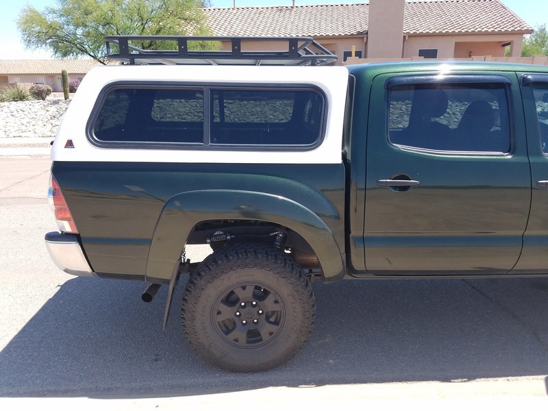

    Found a pretty good deal on a Leer camper shell with a custom built roof rack. It's white, but I can live with that for now. Future plans may include paint or a wrap. We'll see..
    Some guys have asked so I figured I'd throw this out there. I run Dakar leafs and with nothing on my truck or in the bed my center hub to fender measurements are 25" even. With the shell on I lost a whopping 3/16". I suspect I'll lose around 1/4" on top of that.

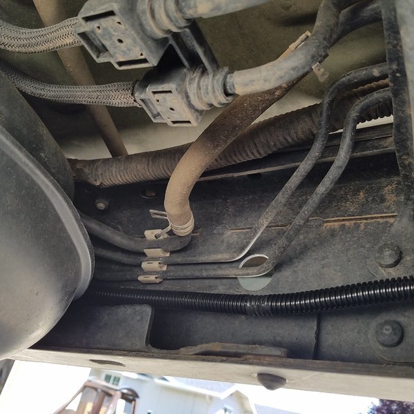

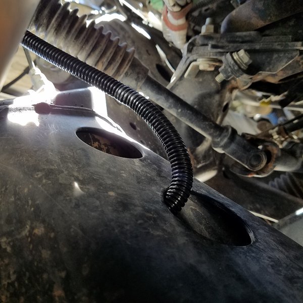

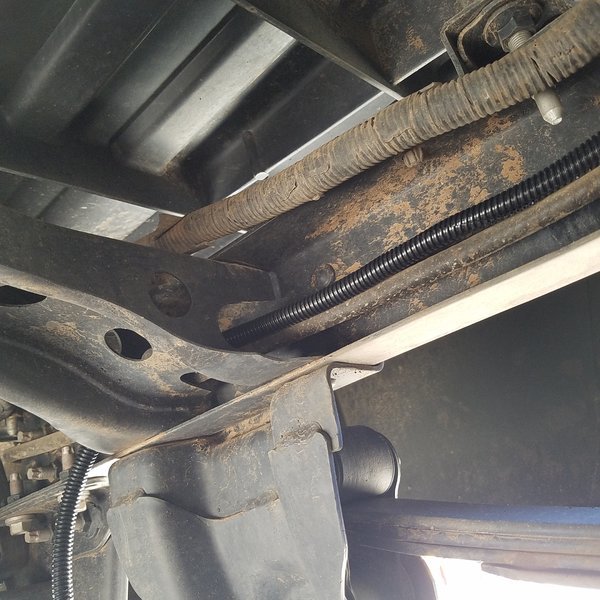

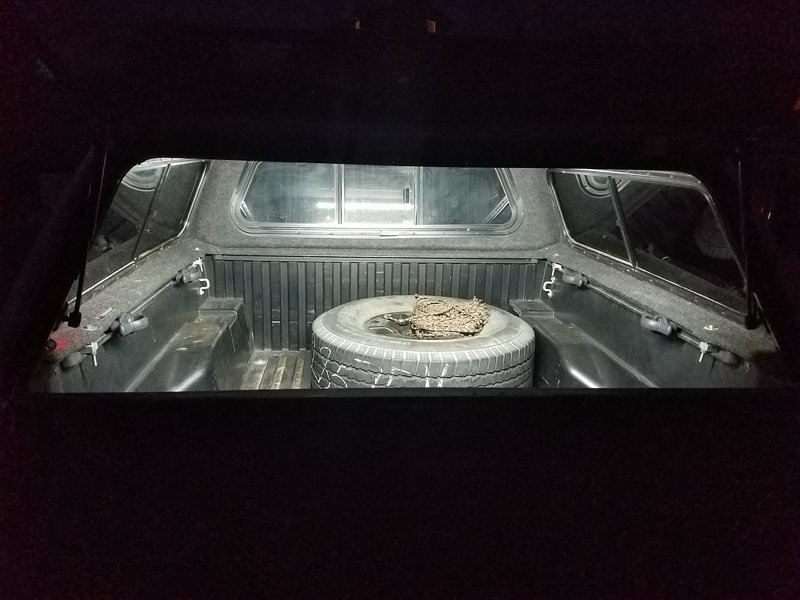

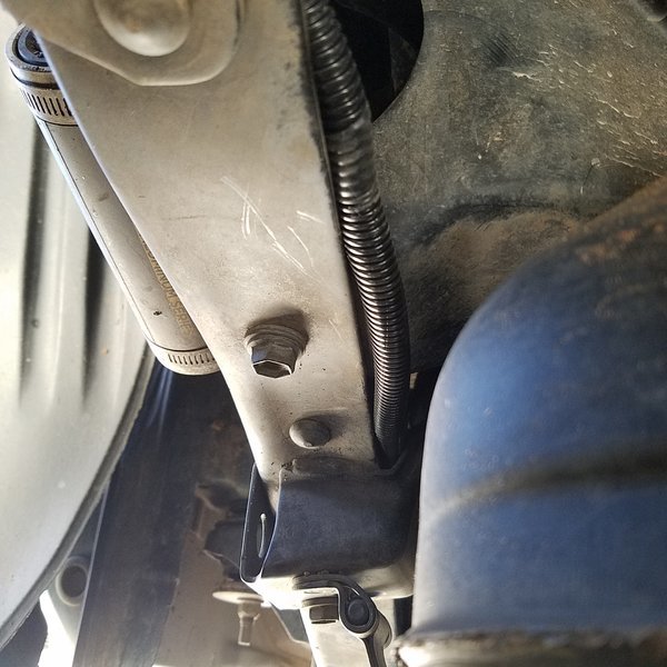

    Got the led lights in the new shell wired up. Pretty easy but tedious work. I wanted the ability to turn them on any time without having to turn the truck on. Since there's no constant hot in the rear of the truck I had to run wire from the engine bay all the way back.
    I started by stuffing (3) 20ft sections of wire into a loom. I ran 2 extra wires in case I needed them for additional accessories in the future. I have my blue sea fuse block next to my battery which made it a pretty easy to start. I dropped the loom down near the fire wall and into an opening in the cross member.
    A little different angle:
    From there it was a tight squeeze with the fingers to make the turn to go into the frame. Once in, it was simply feed slowly until the end showed up where the frame opened up.
    From there it's super easy.
    Following the diff breather hose along the frame and up into the bed behind the driver side tail light.
    I guess I forgot to take pics of where I brought it up but it's super simple once you get to the rear. I capped the 2 extra wires and taped them up inside the loom. I ran one power and ground up and into the bed for the the led light and switch.
    For the led I went with a little more sturdy option than the standard strips. https://www.superbrightleds.com/mor...h-power-led-waterproof-light-bar-fixture/680/

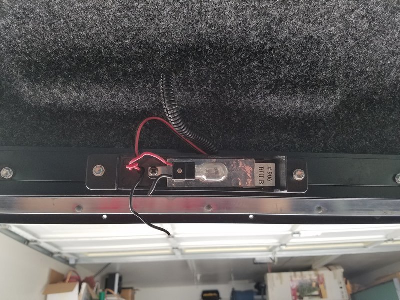

    I mounted it above the door, facing in. First had to remove the old light.
    The lip on the door where the old light was is the exact same width as the led bar. I screwed 3 of these clips directly into the lip.
    Once the clips are in, simply snap the led bar in place. Nice thing about this led bar is there is a groove in the channel that will allow the bar to sit over the remaining screws so it still mounts flush to the door frame. The led bar is solid!!
    Ran the wire from the led over to the corner of the bed into a switch. Once it was all wired up I loomed it and stuffed the loom into the little channel in the door frame so it stays hidden. Once again I forgot to take pics of that. Haha. I'll add some later.
    Final results!!

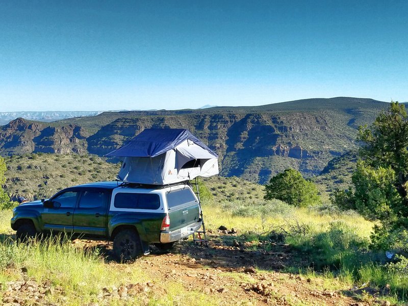

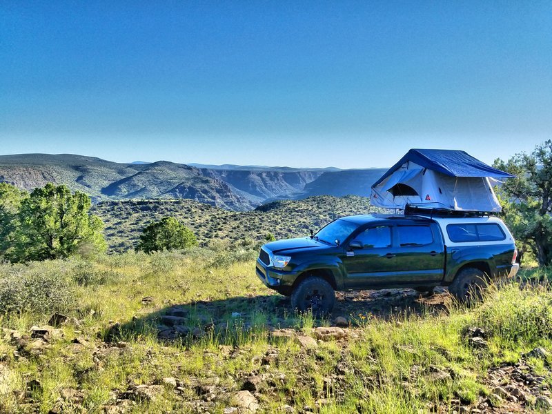

    Had some plans get cancelled last weekend so we squeezed in a quick overnighter in between workdays. Found a sweet spot at the end of a two track that basically ended on a bluff over looking Devil's Windpipe. It was a little tricky getting the truck leveled out but we managed.
