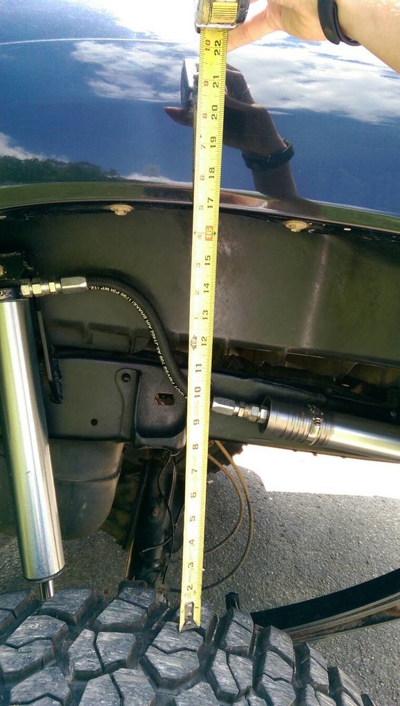

    Yeah the leafs are supposed to be good for 11". I've got 17" at the wheel right now if that helps you.

    You have 17" of travel with 12" shocks and the AP standard SOA pack?

    At the wheel, yes.

    Hmmmm something seems fishy.

    I just can't believe you're getting 17" of travel with 12" shocks and an OEM replacement leaf pack, when say a DMZ SUA pack with a 16" shock is getting 15-17". Something here doesn't add up lol
