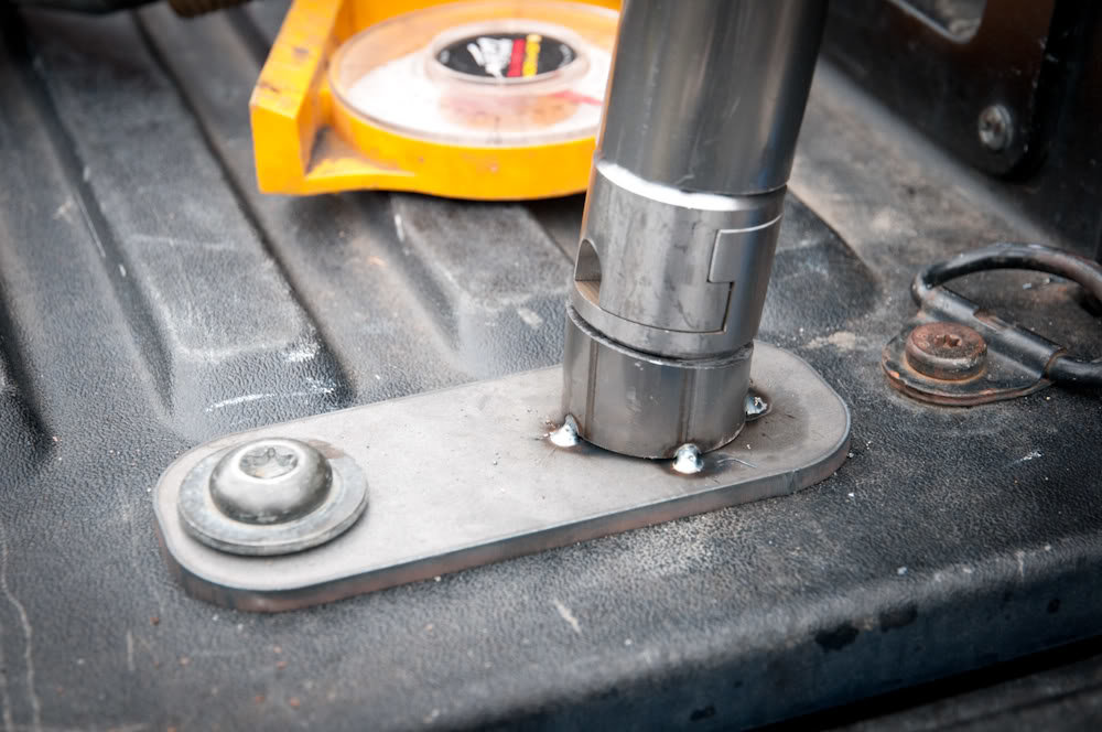

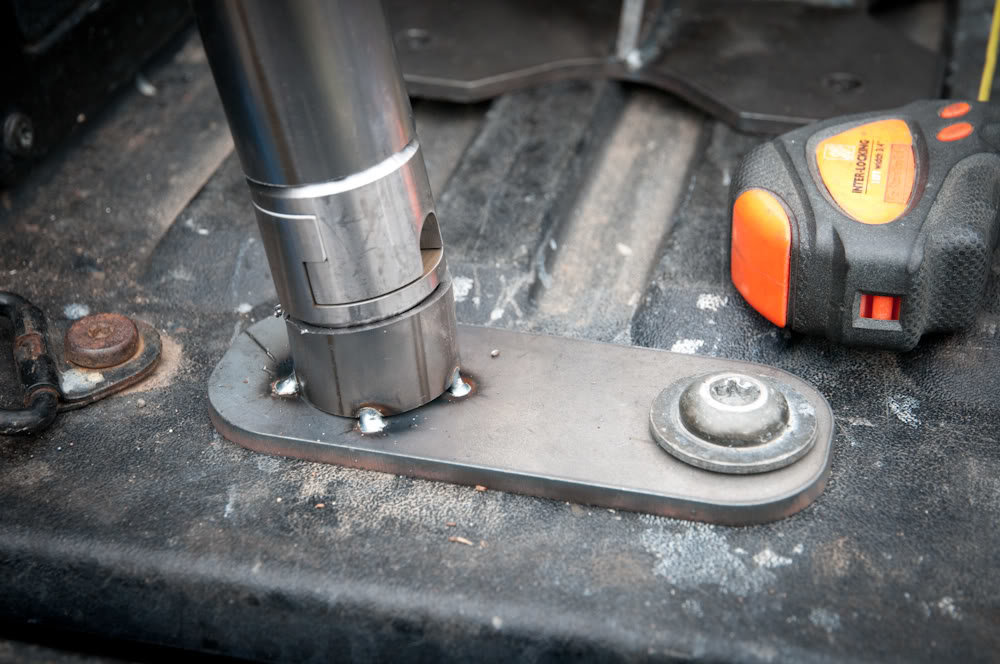

    I would love to see how these work, any chance you have a video, i see the bolt holds it in place but it looks like the notches would prevent it from lifting out, is there enough flex that you can pull the bars inward? Thanks they look cool, and GREAT RACK!

    No video the rack just slide into place all you have to do is slide the rack back about 2" and it will lift right out.

    Very cool how that works

    Yeah they tube couplers are pretty cool pricey but cool.

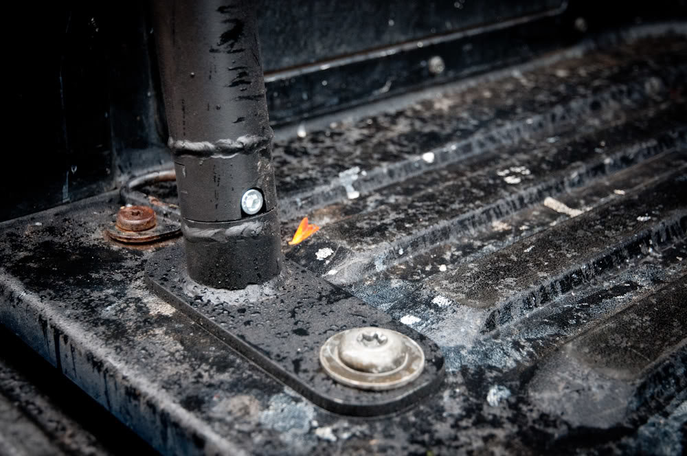

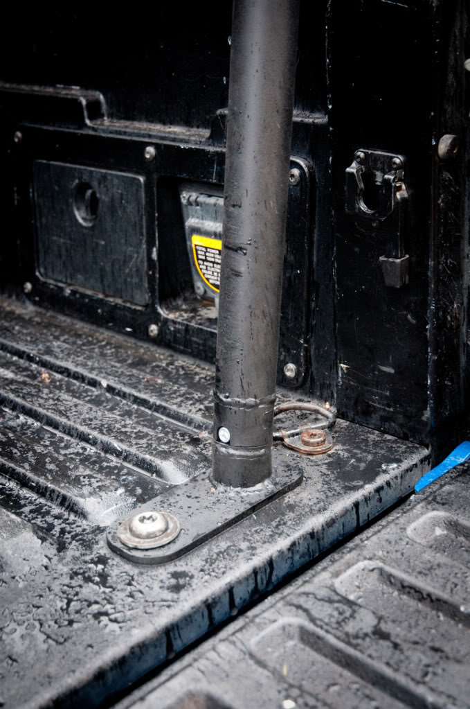

    Man that is SICK!!!!! Looks Way better than All Pro's to me!! Just curious why the legs on it and not just mount it in the bed rail system? I am NOT knocking your design it looks great!!!!:thumbsup:

    Thanks and the rack is designed to hold things on top of it like a tire, camping gear or a roof top tent and its about 200lbs alone. The bed sides can't support that much so I decided to attach it to the frame.
