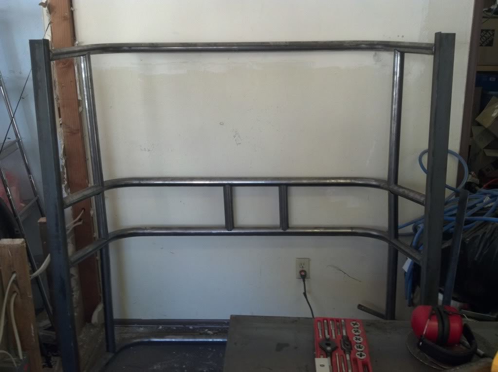

    Not much I've dry fitted the side bars and the two top bars i just have the 4 bent bars on the top and then i can weld it all up. I'm still waiting on the tube couplers from RuffStuff and then I can complete the mounts.

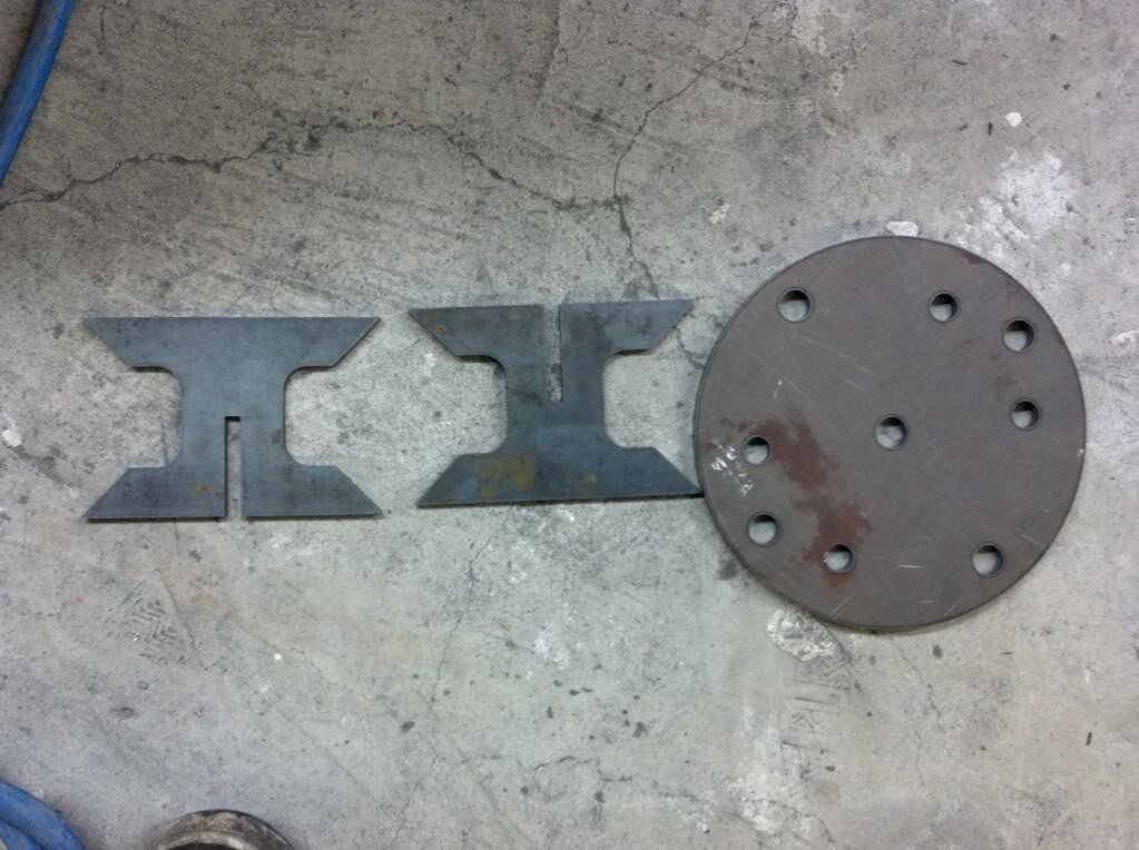

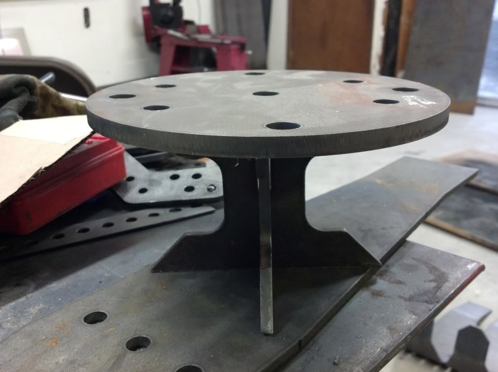

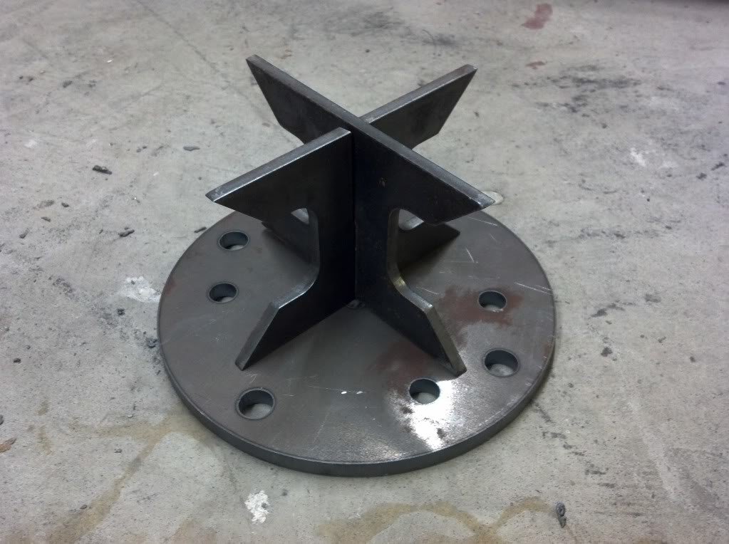

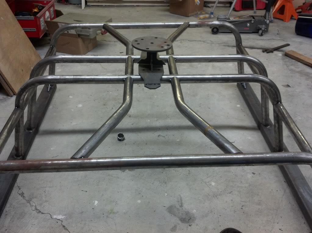

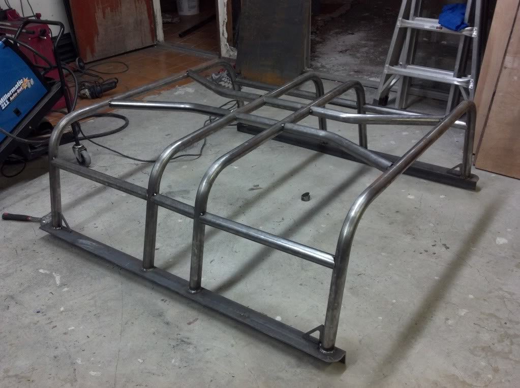

    Okay I know I've been lagging on pictures but here is the bed rack as it sits today. I will be getting the tube copulers next week and then it will be done.
    I started the tire mount today. It's 3/8th plate with 1/4" uprights.
    I still need to cut the plates to mount it to the rack I'll have those done this weekend.
    This is how the tire mount will sit on the rack it's just mocked up with one of my skid plate pieces for the photo.

    #153
    Nightstr
    Nightstr Well-Known Member
    Dec 24, 2009
    #28125
    5,373
    Felipe
    Sacramento CA
    05 prerunner sr5
    BLHM BLWM 3" TOUGH COUNTRY LIFT TRD SEAT COVERS THULE RACK M/T KM2 265/65/16
    Oh my fn gosh!!!!! That is pure sex.:drool:

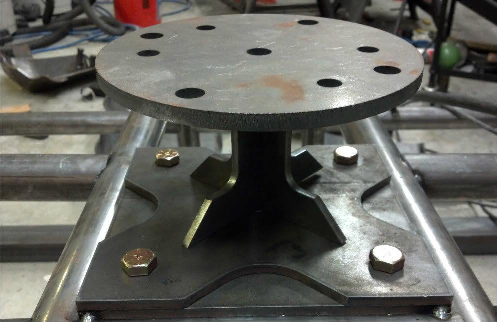

    This is how the tire mount will sit on the rack it's just tacked up with and bolts in the holes. It's all removable and unchangeable with whatever you want to add to the rack.
