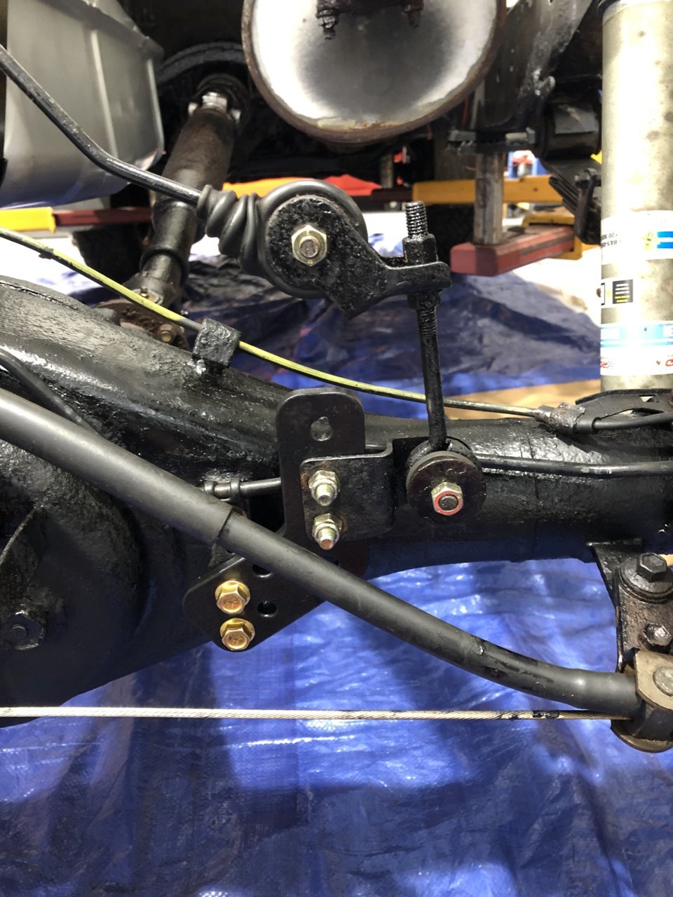

    My BAMF bracket arrived yesterday. Just installed it. I think I have 3” lift. I am running OME springs with an AAL, so here is the setting I used. Is there a better way to determine my actual lift from stock?

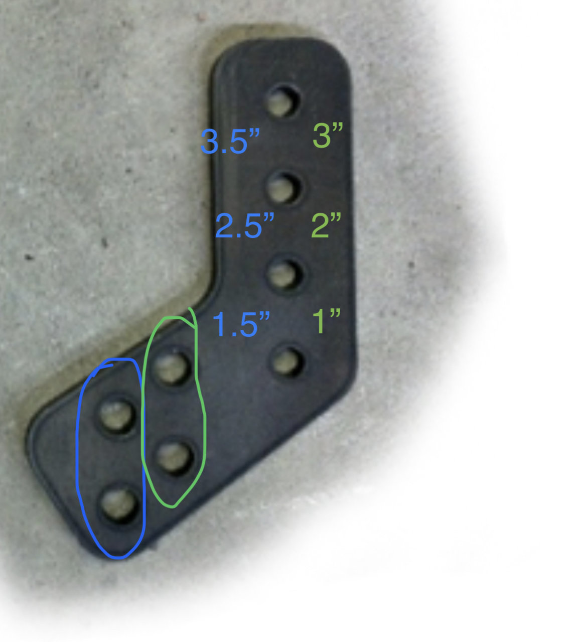

    For those wondering which holes you should use.
    1. determine how much lift you actually have
    2. Measure from the center of the bottom set of whichever holes you choose on the axle and choose the top set of holes for the actual rear brake portion that matches the measurement of your lift.
    if it’s 2.5” of lift then center to center of the mounting holes should match.

    This should help some
