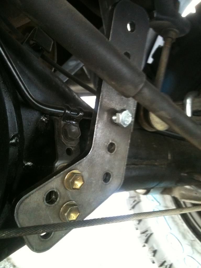

    you have it set at 4" of lift is that where you want it?

    Well I tried putting it on the third hole from the bottom and the brake line was in the way...

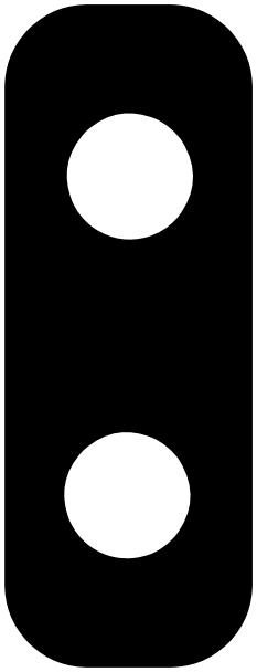

    Humm when we test fitted it there was no issues.
    Another thing you can try is put the bolt in from the other side.
    If you can't get it let me know I'll cut you out one of these to move the bracket out 1/4"

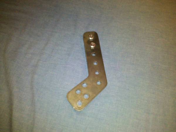

    Got it today, awesome shipping. Thanks :thumbsup:

    Got it!! Thanks Jerry! Installing tomorrow

    Ok sounds good. I'll try to flip the bolt. (I think that may work)
    I'll let you know.

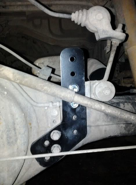

    got mine on. Just flipped the boat. Thanks

    Okay cool.
    And fixed ;)
