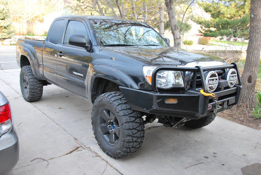

    i am really considering an arb bumper for my access cab speedway blue taco. The thing is i really havnt seen hardly any pics of them on access cab trucks before.
    so if you have a pic and you would luv to show ur truck off i would luv to see the pics. Also tell me what you did to your suspension as well, like if you upgraded it or just left her stock

    this is the thing man ive googled it and i havnt found anything really and well i just wanna see some pics of arb bumpers on access cab tacomas plain and simple

    the front stock springs would have a hard time supporting that weight bud...you'd need some OME 886 springs...other wise your front will sag BAD

    Yes, they are heavy duty lift springs designed for those who want a 2.5-3" lift but also have the heavy weight of the bumper on the front to overcome.
