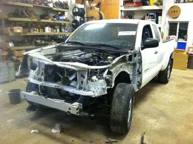

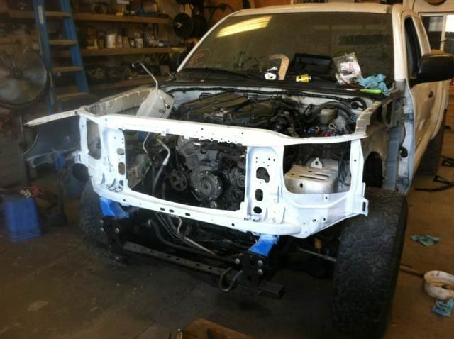

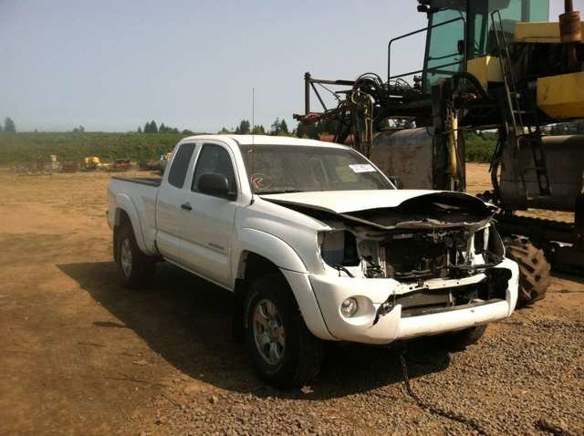

    Hey guys I got my Taco a few weeks ago at an insurance auction and wanted to share my build with you guys
    Here she is just like I got her
    Started tearing her apart and build my need to buy list
    Had a small engine fire in it that needed repaired

    I got it for under just 8000 and put in about 4000 into it, I had to replace the motor pics coming soon

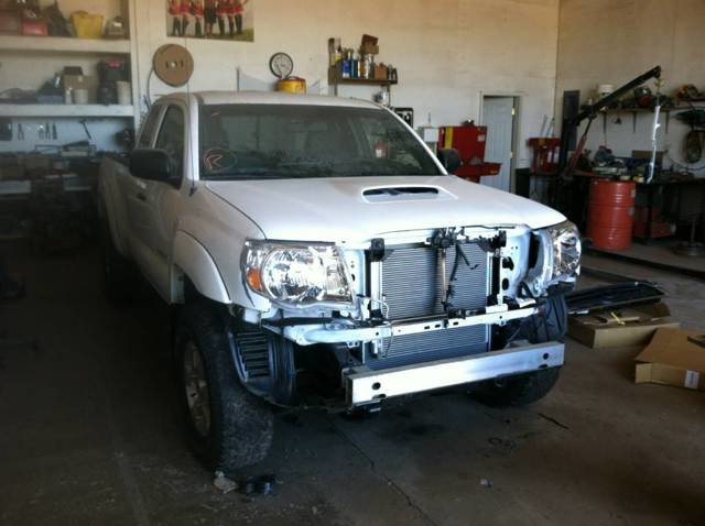

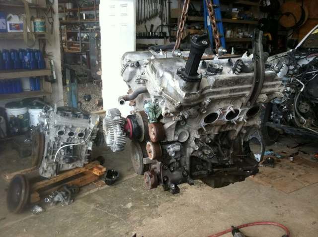

    Original motor had to come out because the pervious owner thru a rod out the side of the block
    Once the motor was in I welded in the new core support
    Hood and lights getting aligned

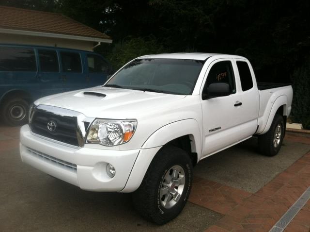

    She is all done with the FJ TRD wheels I got a 3" lift in box to put on but it's a spacer lift.. Are these lifts really that bad for easy driving? I don't hit trails or anything just go thru a few rough places when I go fishing but reading reviews has me a little worried on it

    The lift isnt bad as long as you dont wheel it that hard, but the ride quality of them is terrible. Its gunna drive like a brick. I had a 3" rough country on my old taco and i hated it.

    that lift will ride great! you shouldn't notice any change, as it is a top plate spacer, not an in coil spacer.
