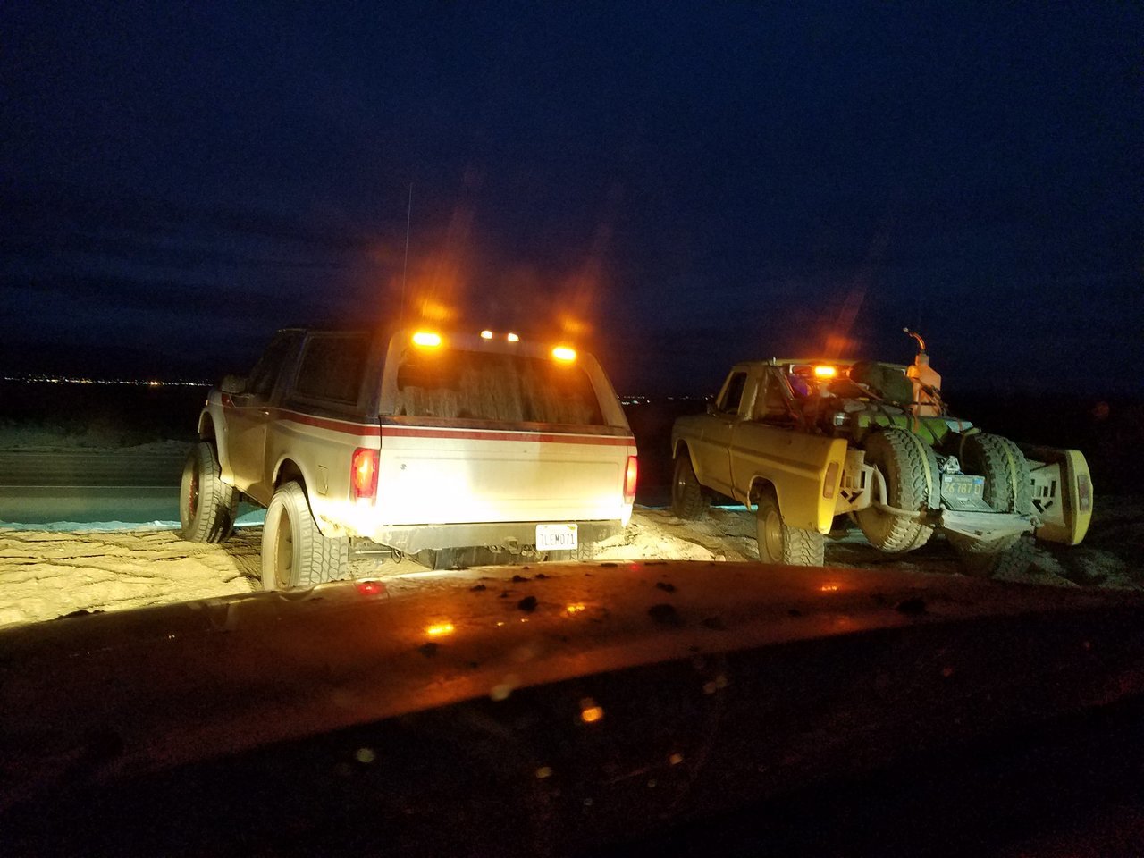

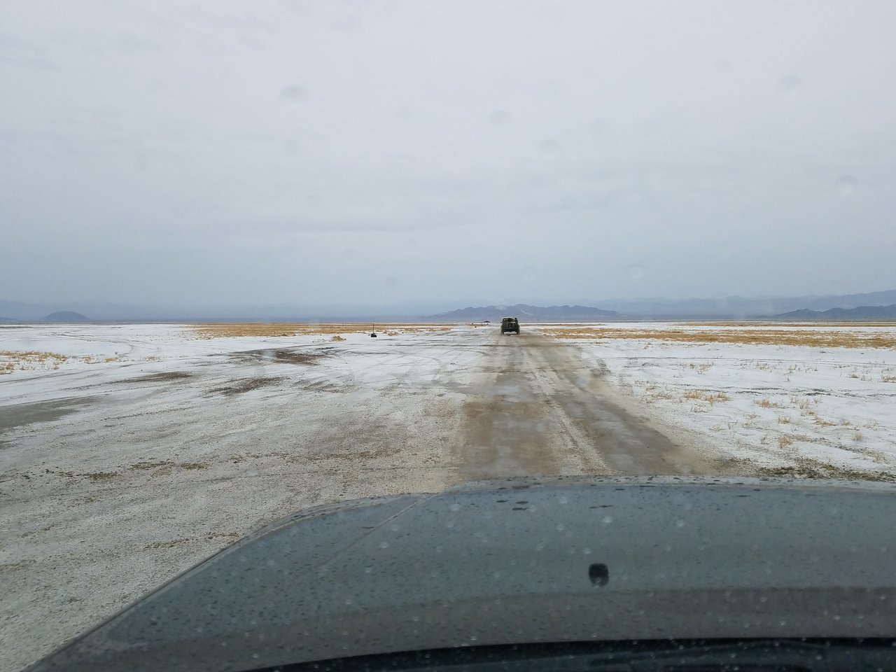

    Went on a little Broverlanding trip on Mojave road the other weekend, finally got around to the pictures. Truck did great, definitely had a few oh-shit-ouch moments, but truck came out unscathed. The front coilovers have a bit of preload in them now for sure, less bottoming out, even stance more or less. Went pretty minimal on gear this time to try and stay light and fast. Took off around 9 Saturday from Afton, ranger hydrolocked his motor, we towed him out to the road and got on the trail around 10 or so. Checked the lava tubes out, bombed a lot of dirt roads, got a few rock chips, had a lot of laughs, and made it to Laughlin by around 8 maybe. Gambled, slept and got an even later start home, planning to take dirt to the lakebed and hit the road from there. F-100 sheared an upper link bolt and on our way out to the road, at about 85, Bronco broke an axle and went for a bit of a skid. After a bit of time and a long night, he got his trailer to it and back home. Great trip, definitely want to go again. Baja trip coming in a few weeks, so some upgrades from are coming in preparation...

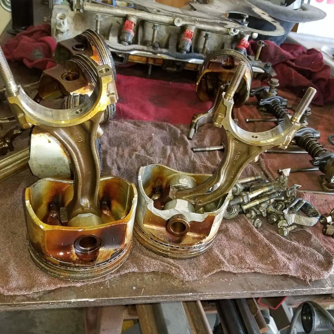

    The ranger carnage...

    Will buff out for sure :violent:
    Assuming he just hit the crossing too fast?

    Too fast, stock height, open element intake....:bananadead:

    I was just thinking a snorkel really would have helped here.

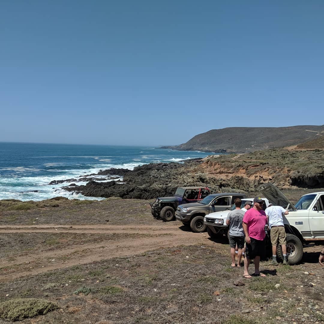

    Did a lil baja trip for a buddies bachelor party this weekend. Stayed at Horsepower ranch outside Ensenada and at the Old Mill in San Quintin. Great time, truck did fine but I have a clunk in the front end somewhere on some situations. The AC on, listening to SiriusXM playing Coachella sets was pretty clutch.

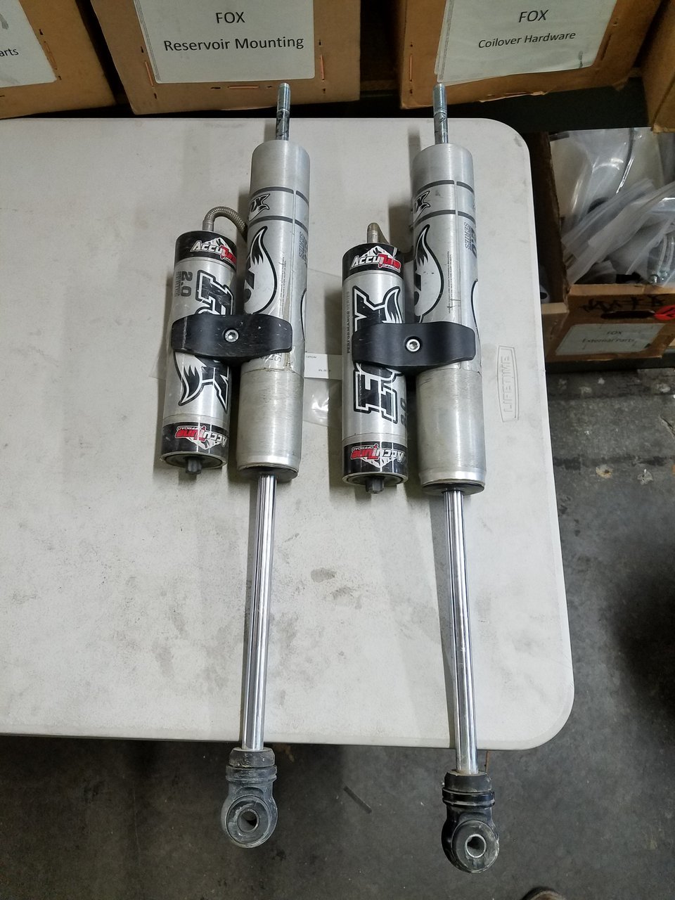

    Also, rear upgrades are in the works, just waiting on Fox's lead time on some new 2.5s in back.

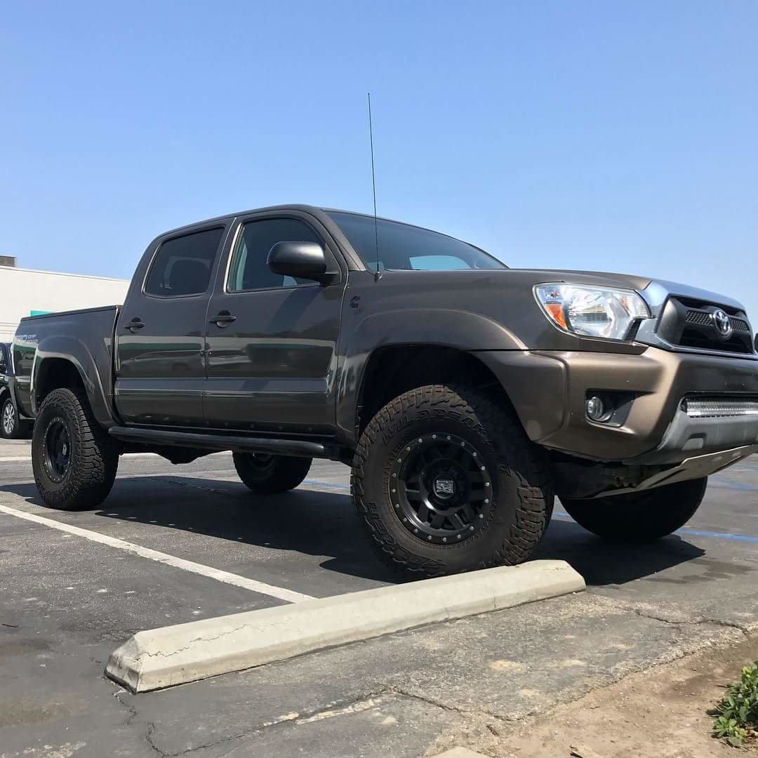

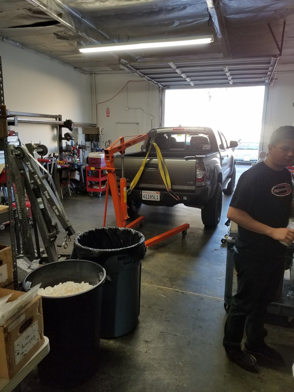

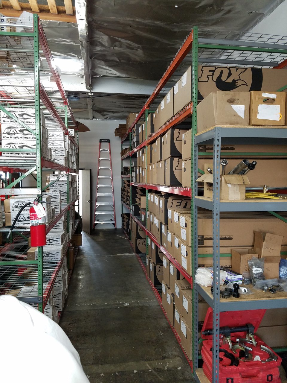

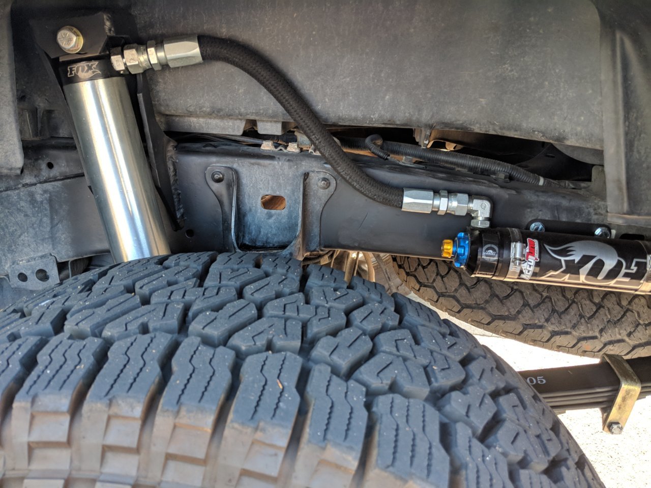

    Took my truck down to AccuTune in Carson while I was on vacation and my buddy Andrew installed some Icon RXT leafs, B.A.M.F. shock towers and some Fox 2.5s with DSC adjusters. Also swapped the super bumps out for some other bumps Andrew is trying out that are a bit softer so the bottom out isn't so harsh. They fiddled with the tunes since they had the time, working on balancing the valving front and rear. Feels weird not doing work on my own truck, but I'm glad Andrew was able to sort it out. Towers took some modification to really try to get the full 12" of travel out of these things without lots of issues, and we're close. Tires rub on articulation and brake lines are too short, so I got some 1.25" wheelspacers and will be ordering some brake lines soon here. Not looking forward to the amount of trimming that will be needed once these wheelspacers are on...
    After driving it around a few days, the truck feels super smooth through some big dips in the neighborhood and some very abrupt driveway transitions I took at speed. I set the leafs in the middle position, so one of the leafs replaced with the additional one, and it sits about the same, maybe a touch higher, than my old progressive AAL pack with overload. Should be perfect for loading with gear for a weekend in the dirt, hopefully soon!
