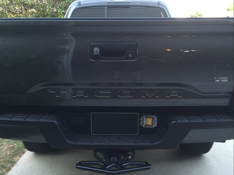

    Hey, Folks.
    I tried searching and I know someone has done it, but I cannot seem to find the post. Any help would be appreciated.
    I'm trying to find the post / thread where someone installed a flush mount backup light in the spot to the right of the license plate. The post that I am thinking about showed the light pattern and coverage.

    Search "rigid ignite", that's the go to light for this application.

    That's mine in the pic but I didn't post any beam pics. That's the diffused lens , I would go with that one for reverse light duty.

    One final question. My plan is to use this as the sole back up light. Did you have to hook up to a relay or is the stock power good to go?

    I tapped into the trailer harness and it works fine. The ignites pull so few amps you could do two and still have no issues.

    Finished this part of the mod:
    This is the first time that a used a stepped bit (go Harbor Freight!). It makes shit like this too easy:
    I cleaned up the hole a bit more after this pic (not shown):
    As seen in the other links, this particular light is great for that location. Although, note that the included mounting screws and nuts are SAE and are about 1/4in too short. There is a bit of gap between the plastic and the metal part of the bumper in this location. It is thin metal, so I used the BFH with a plastic drift and with difficulty was able to get the left side to catch a couple threads.
    In typical defeat, I'm going to grab some longer screws on the way home, maybe even metric.
