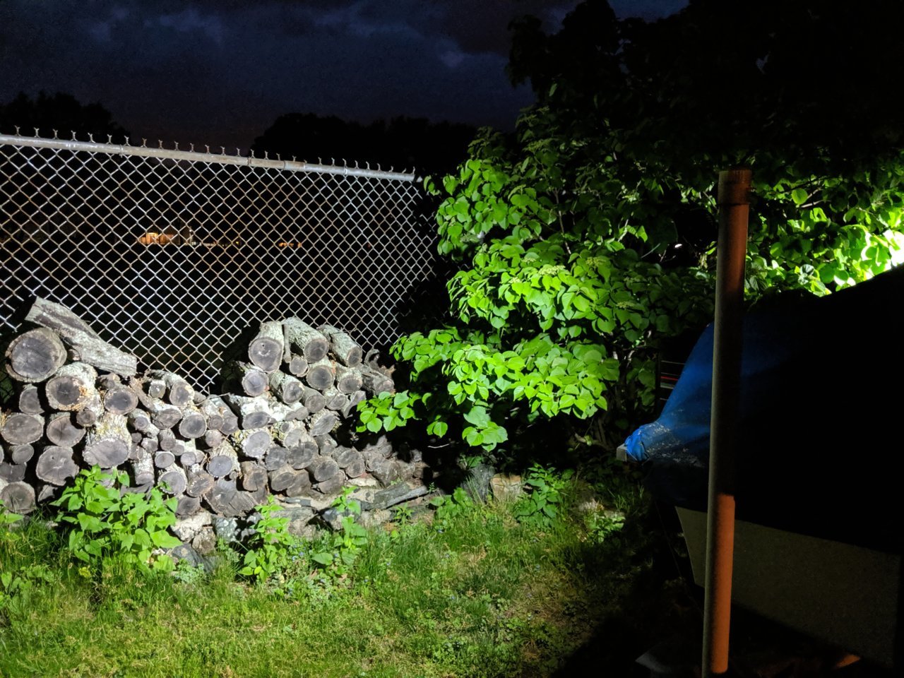

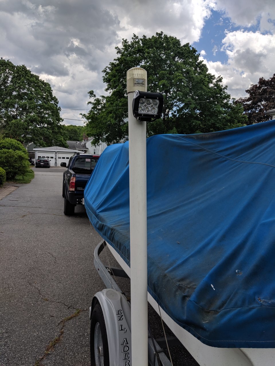

    Thought I needed some light backing down the boat ramp at night. Found these pod LEDs in 4 pack for $25.00 on Amazon.
    Found a 7 pin round to 5 pin flat. That 5th wire, being the back up lights. Ran a pair off wires for each pod and swapped out the connector. I can hardly wait to see what they do when i need them.
