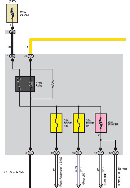

    A few weeks ago I noticed the rear sliding window not working. Didn’t pay much attention thinking snow/ice issue. Today I started looking and discovered neither rear side windows work either from any of the door switches .No sign of blown fuse but found no 12v on either side of fuse (in cab) marked “Door R/L” . Are these normally fed from the front fuse/relay box? I need to look tomorrow when it warms up outside..

    Door R/L = Rear Left...

    Strange the right or left rear windows don’t work. Is that 30A (pink) fuse under the hood?

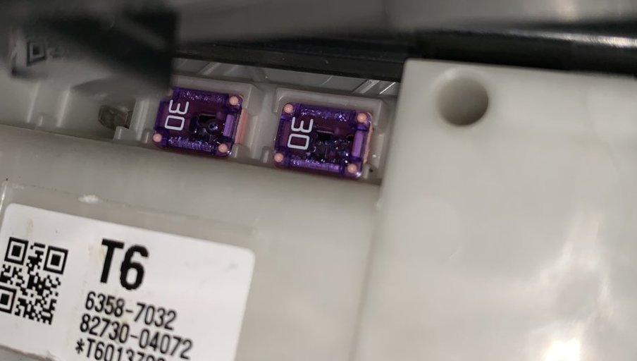

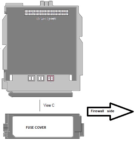

    No..it's above the cab fuse panel on the side

    Well hidden
    Thanks!

    Wow, those are fun. How is anyone supposed to get those out?

    Just kidding, no way to get that tool in there and pull on it. Check the power at the pin coming out towards the window motor.

    I got them both out and checked them. They’re good..
