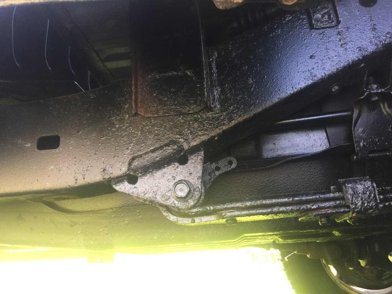

    How does this frame look?
    I was told it was sprayed.

    When it was sprayed especially recently, only hummer will tell the truth.

    I would ask very concrete questions about details including amount of rust inside the frame, metal condition and such. If you find any of the answer not truth you will have a ground of at least getting deposit back. Of course if answers are good enough to make the trip.
    By looking at the state of bolts and nuts you can easy say, that the truck got acquainted with rust, but under such thick layer of muddy goo on the frame it is hard to tell how good it is without "kicking the tire" (or ringing a hammer in that case).

    10$ say's They bought some cans of bed spray at the local auto parts store to spray it down so they can sell it.
    this pic they didnt even get the whole frame up top..

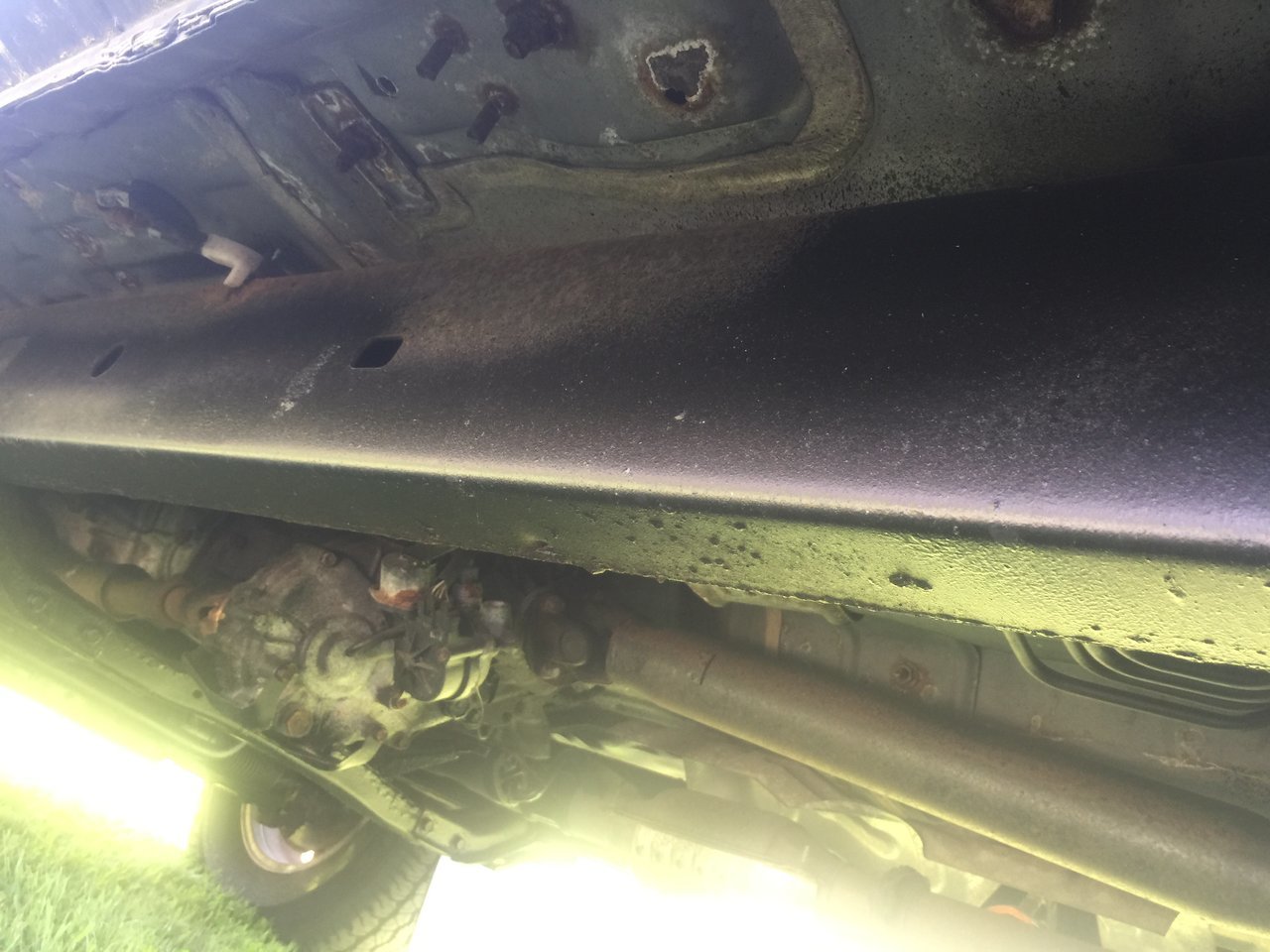

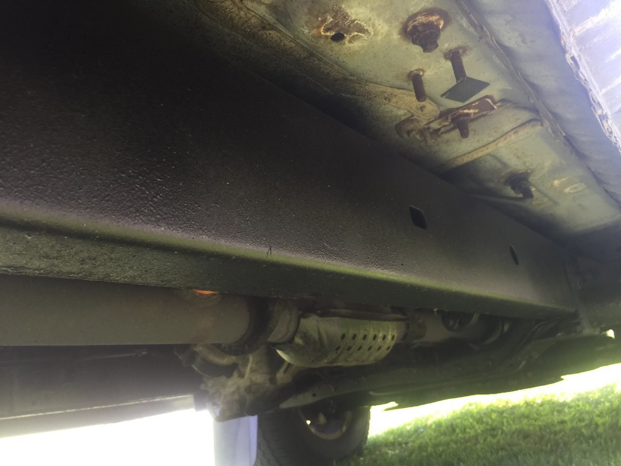

    Look at the bolts sticking through the bottom of the cab. They look pretty rusty. Personally I'd pass. There is probably allot of shit you cant see that worse then the stuff you CAN see.

    WTF are these rusted bolts for?
    BTW It looks like the floor got eaten some too.

    It looks like it was sprayed/painted over whatever rust was there, looks like there's some rust-like looking texture underneath the paint. I don't see anything terrible though, doesn't look like any covered up perforations or anything.
    Was it sprayed/coated by Toyota?

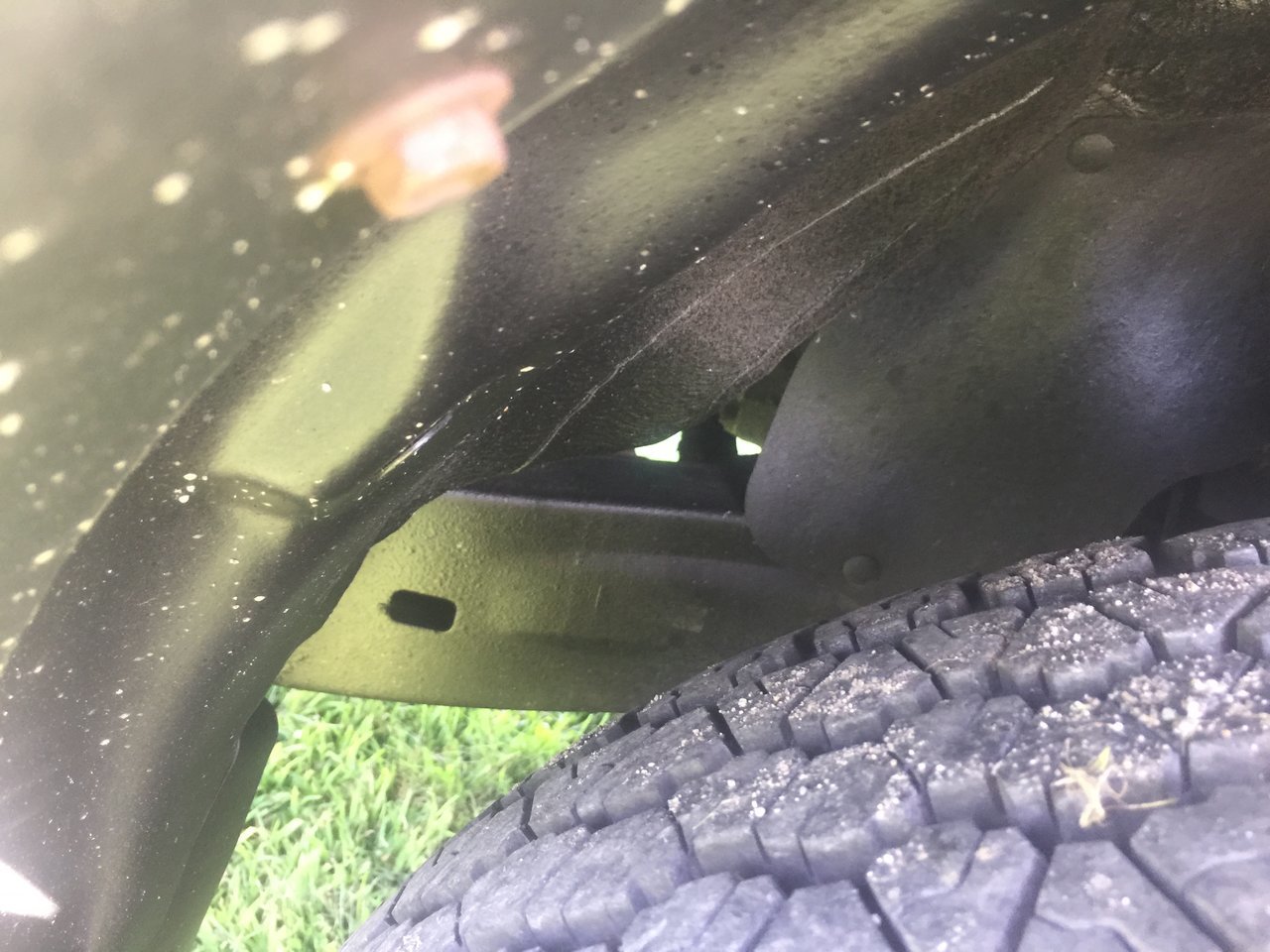

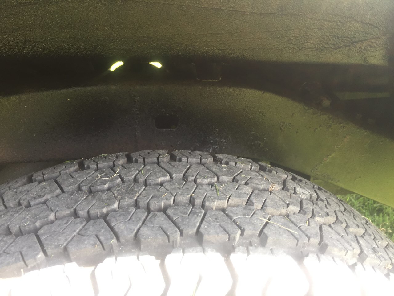

    Doesn't look that bad though a still tap certain areas with a ball peen hammer. Looks like there's some scaling but nothing major.
