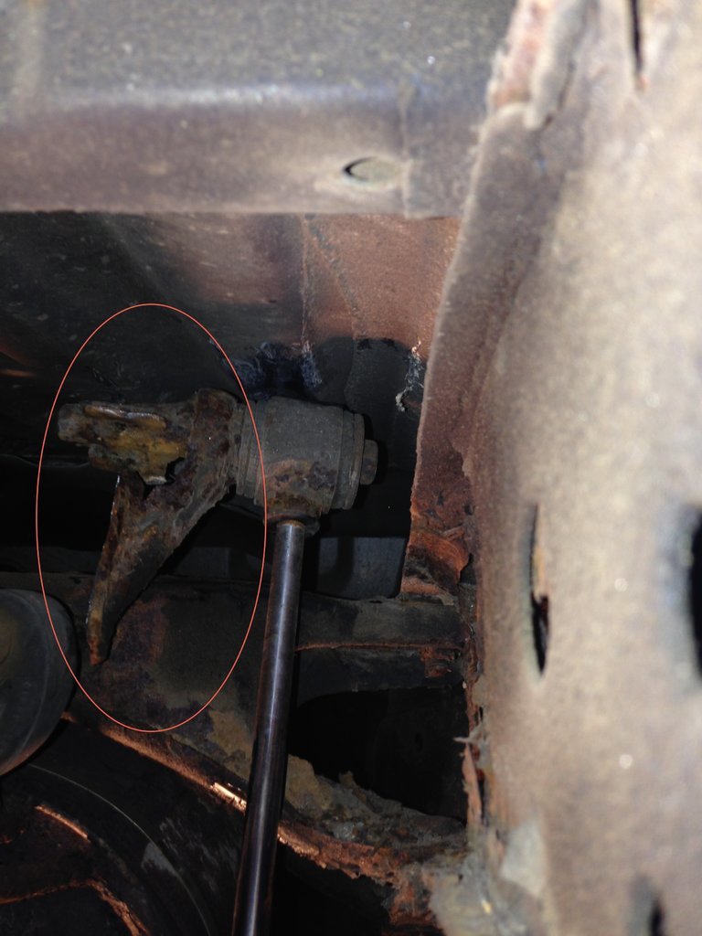

    my '02 was coated by Toyota in '07 and last year one of the rear shocks broke off of the frame, taking the shock mount with it. there were a bunch of other holes in the rear frame that i could have easily knocked through with a hammer. see below.
    I was about 6 months before the 10-yr extended warranty on the rust coating expired, so i was qualified for a frame replacement. otherwise i would have been 100% f'd. maybe 7-8k for a new frame?

    One time coating is not a solution for making the frame rust proof. This was one of these deals, where Toyota tried to solve the problem: "I'll coat your frame for free and you f*** off". And later it was used as an excuse in the "extended warranty" program to reduce the number of vehicles qualified for the frame replacement.
    Fighting the rust is a constant battle. You will never win it, the only thing you can do is fight it every fall and spring, every year. Any time you stop or delay the treatment, the rust will advance and will never go back. Once metal turns into rust it will never tun back to metal. The rust prevention of the frame (and the entire body) is as much important maintenance item as an oil change. Buying Tacoma with rusted and then painted frame like that is like buying a truck with 150k miles when the first oil change was at 149k miles.

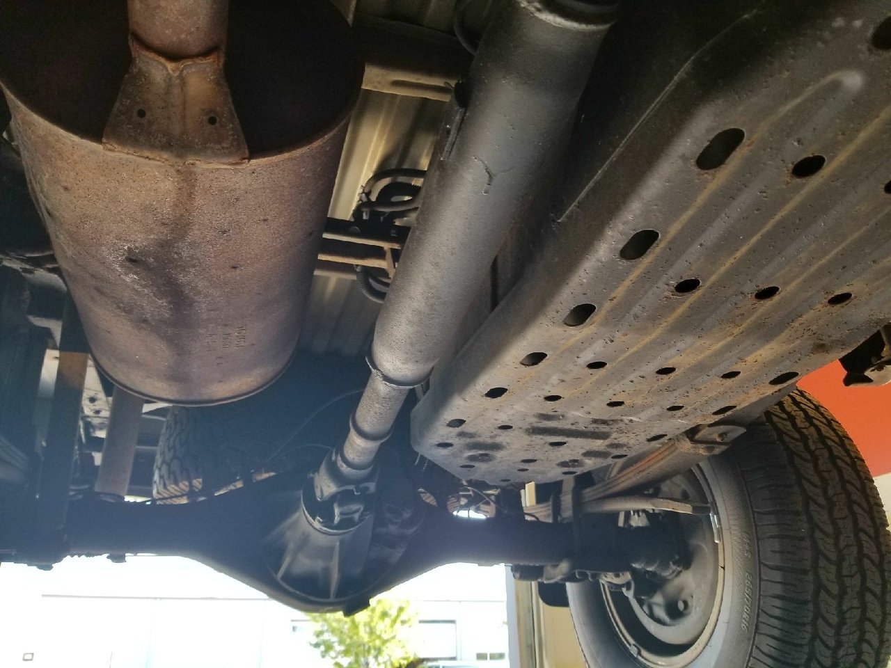

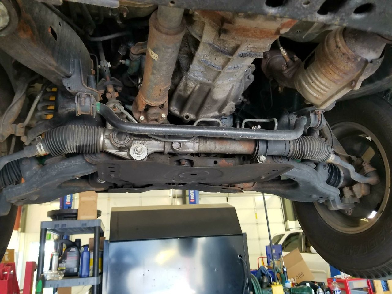

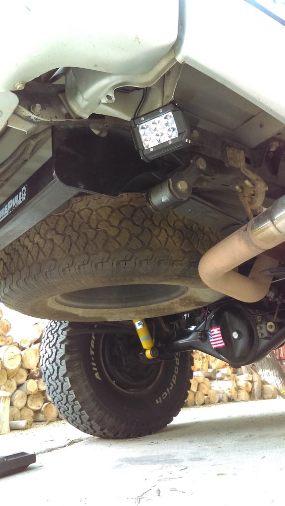

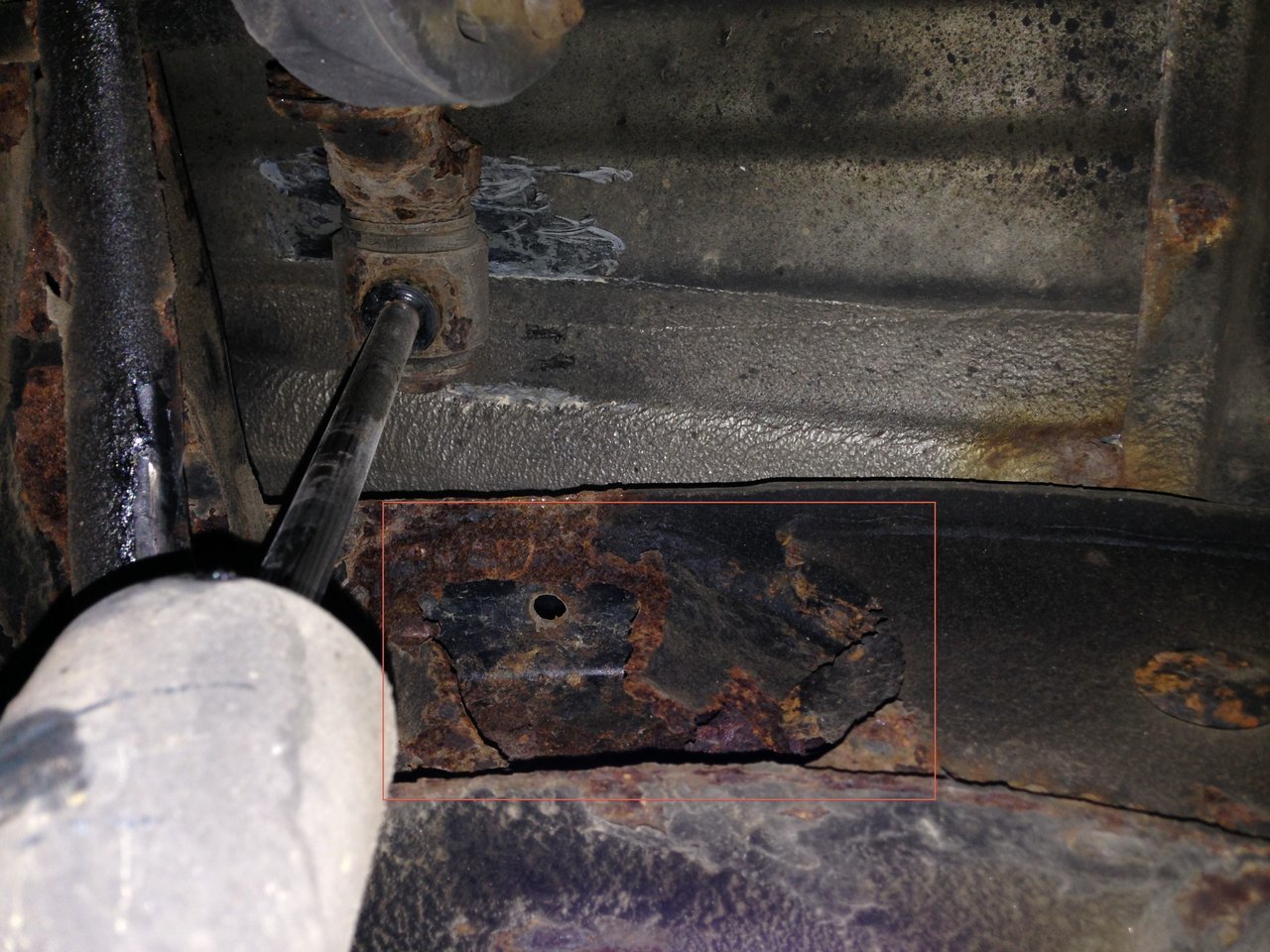

    There's enough rust on the rest of that thing to make life hell should to need to replace anything else on that thing.
    Frame might be fine, but all the other bolts I see are rusted.
    Mrguitarguy01[OP] likes this.

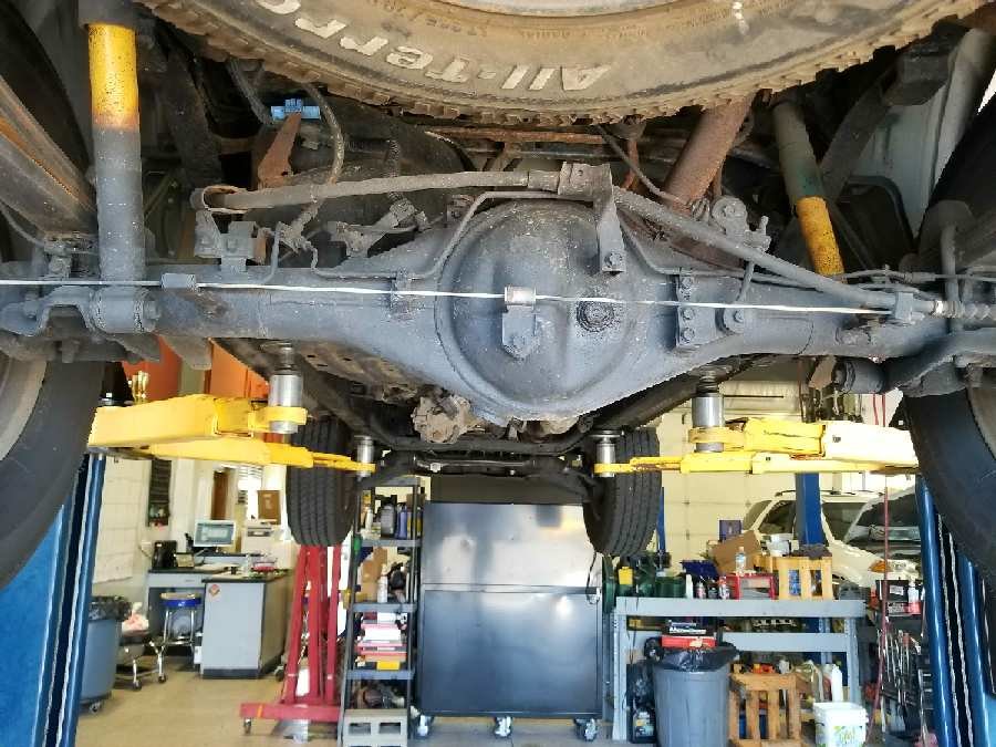

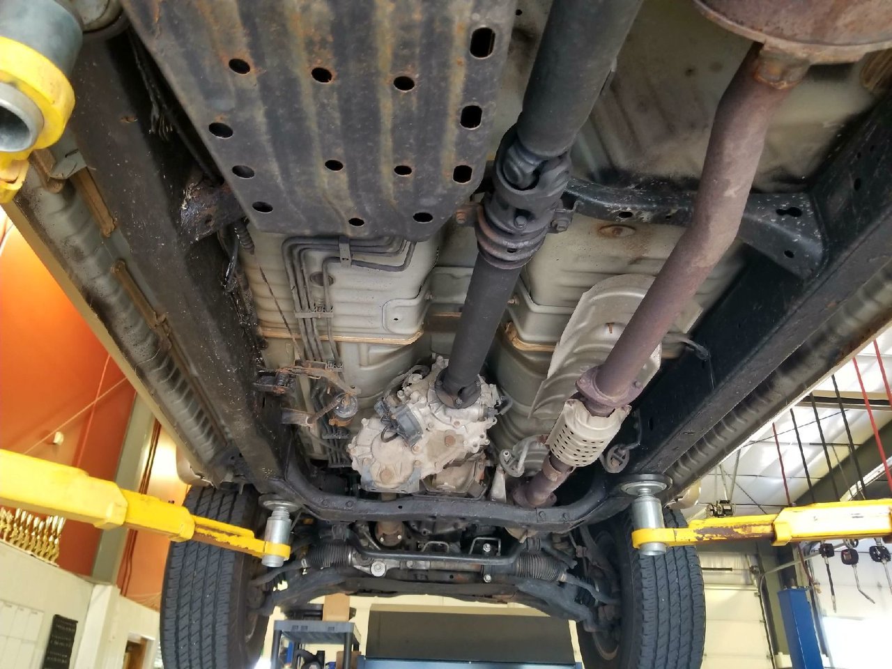

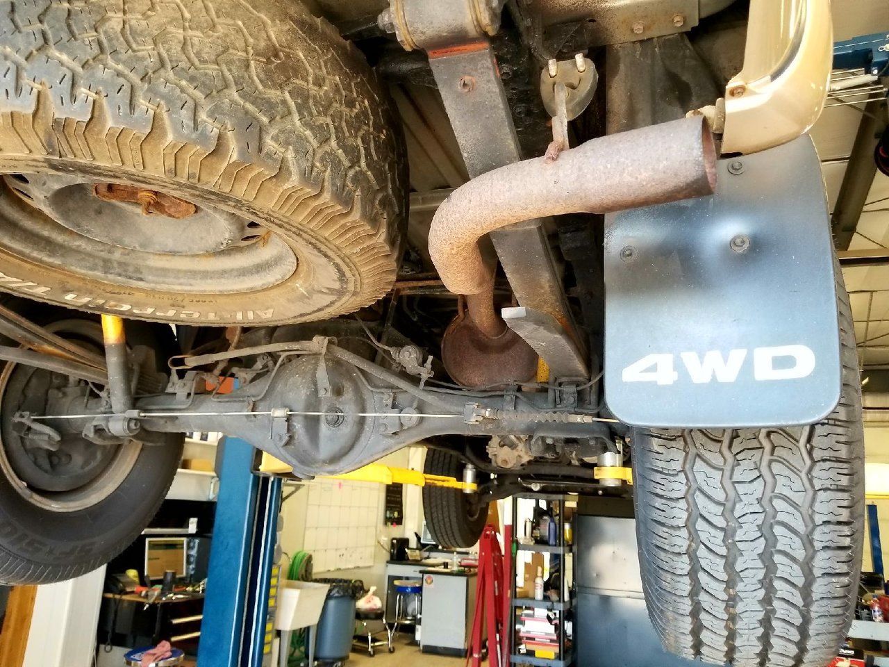

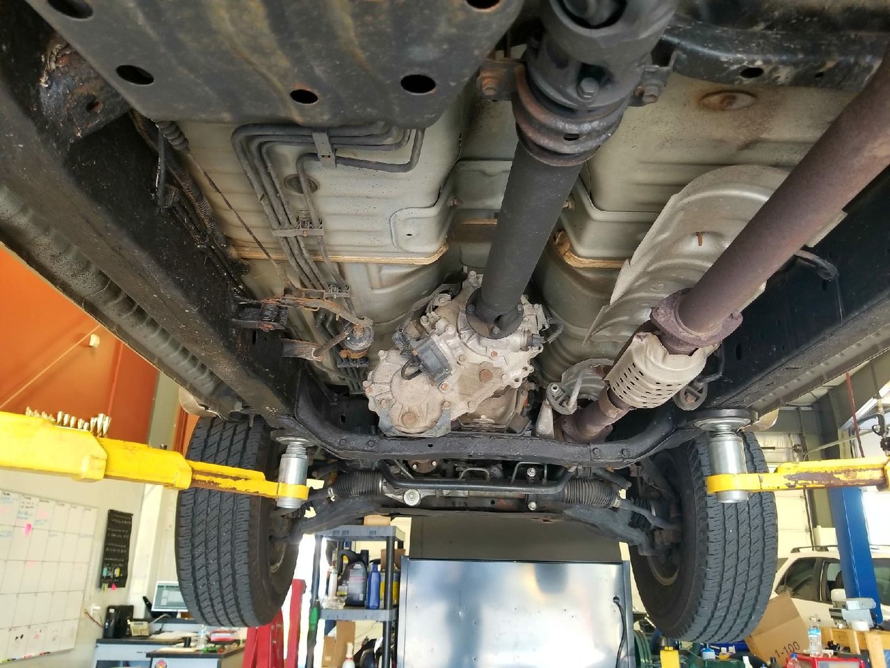

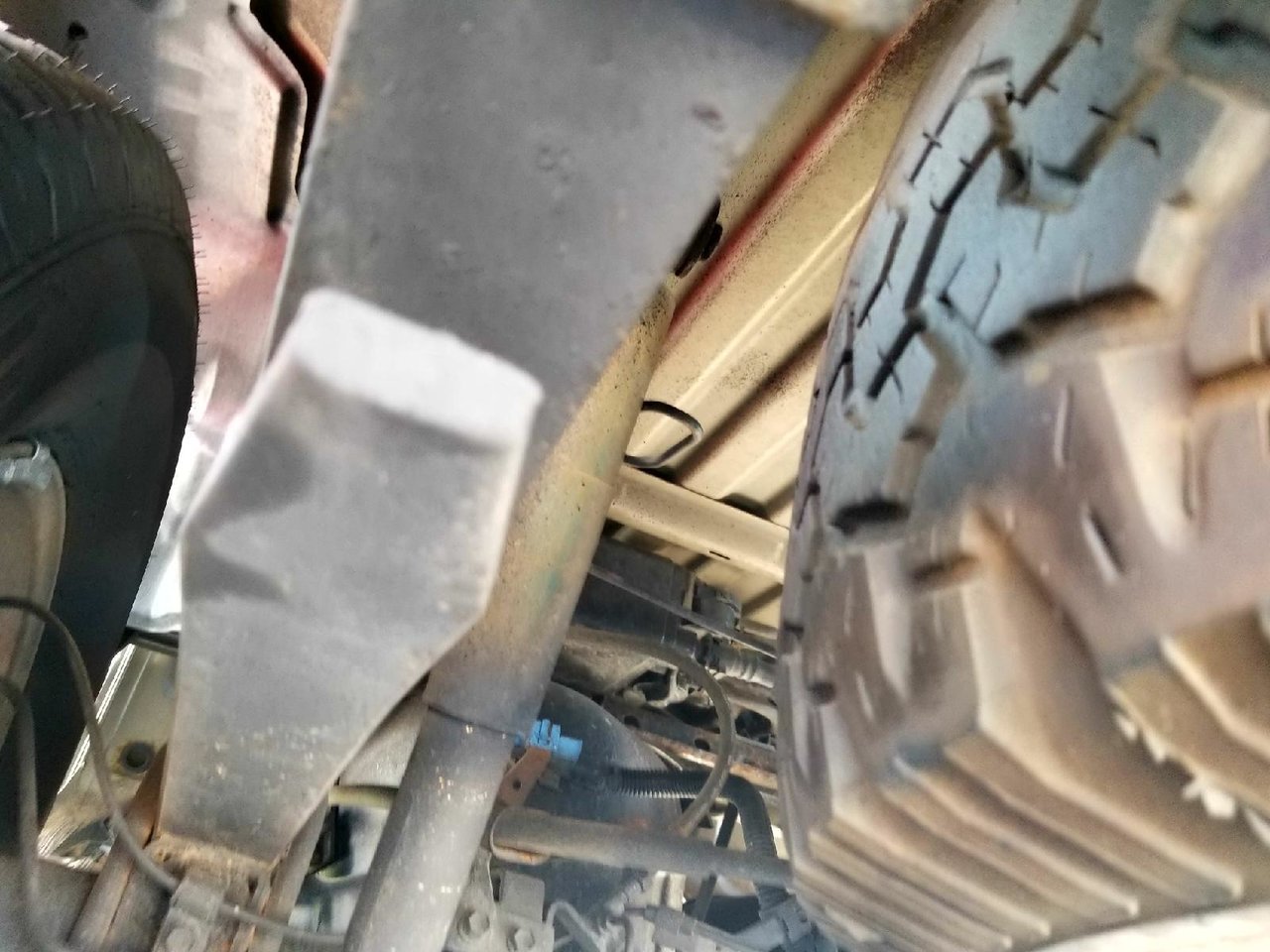

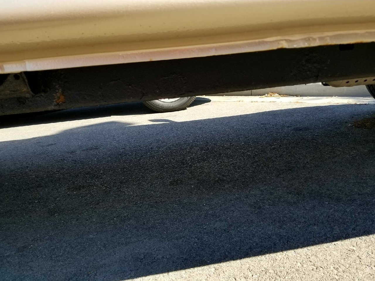

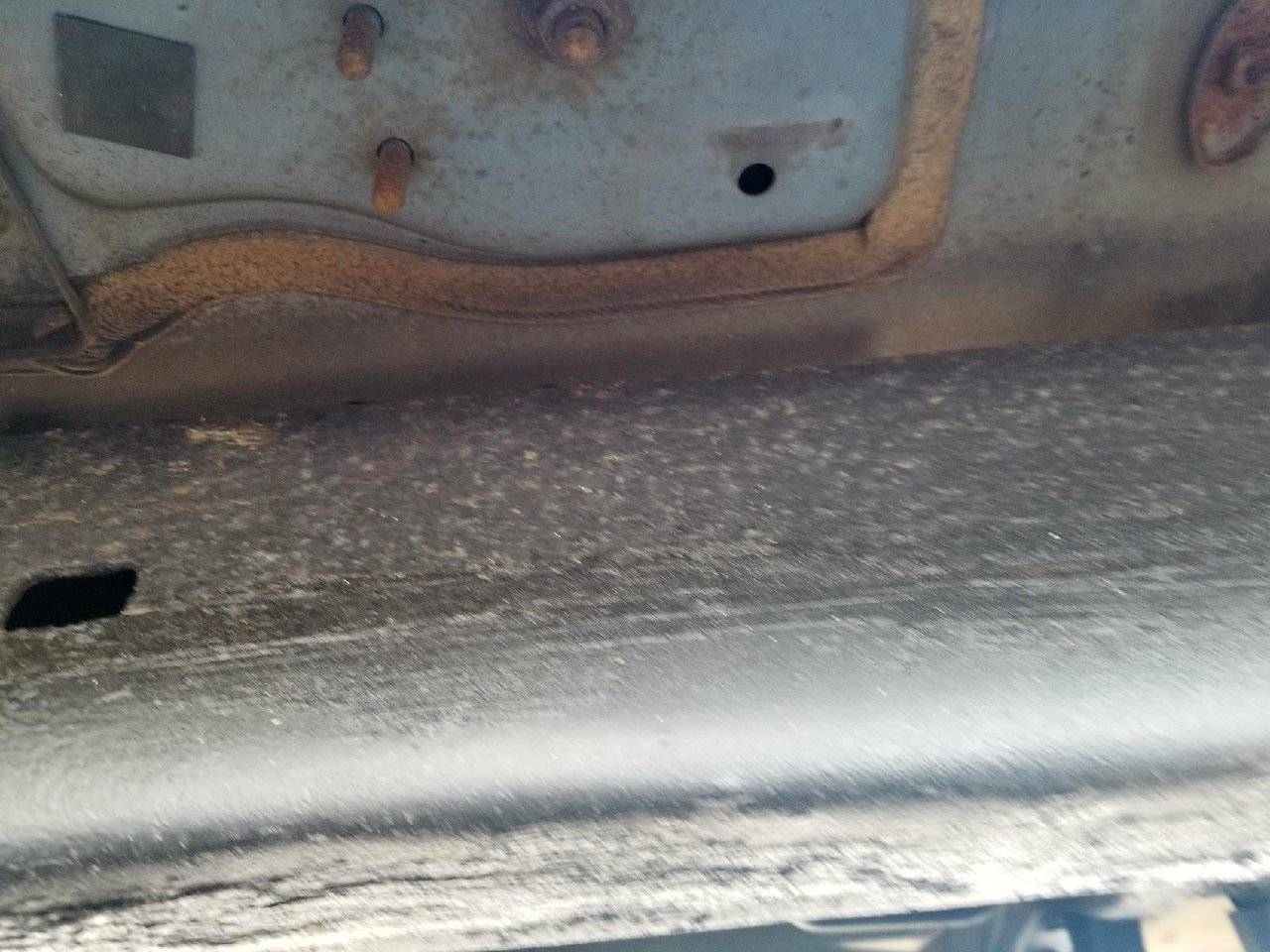

    How is this frame?

    The frame was sprayed, clearly, but you can see there is some rust underneath the paint or whatever undercoating it is, as it has already started to peel off on some places (pics 4,6,10,11,12,13) and you can even see it by the texture (pics 4,7,8,11) on some spots. As I said earlier, these frames rot from the inside out.... so a hammer test would be needed. It's a good sign they were able to put it on a lift, but still, I'd do a hammer test, just to be sure, as it could be rotten inside but not to the point of breaking in half
    if it is far from you, I'd pass because this crap only accelerate the problem, so
    I'd scrape that stuff off and treat this rust ASAP
    The good point is if it was sprayed by toyota, the truck might be eligible for a new frame, but don't count on this....

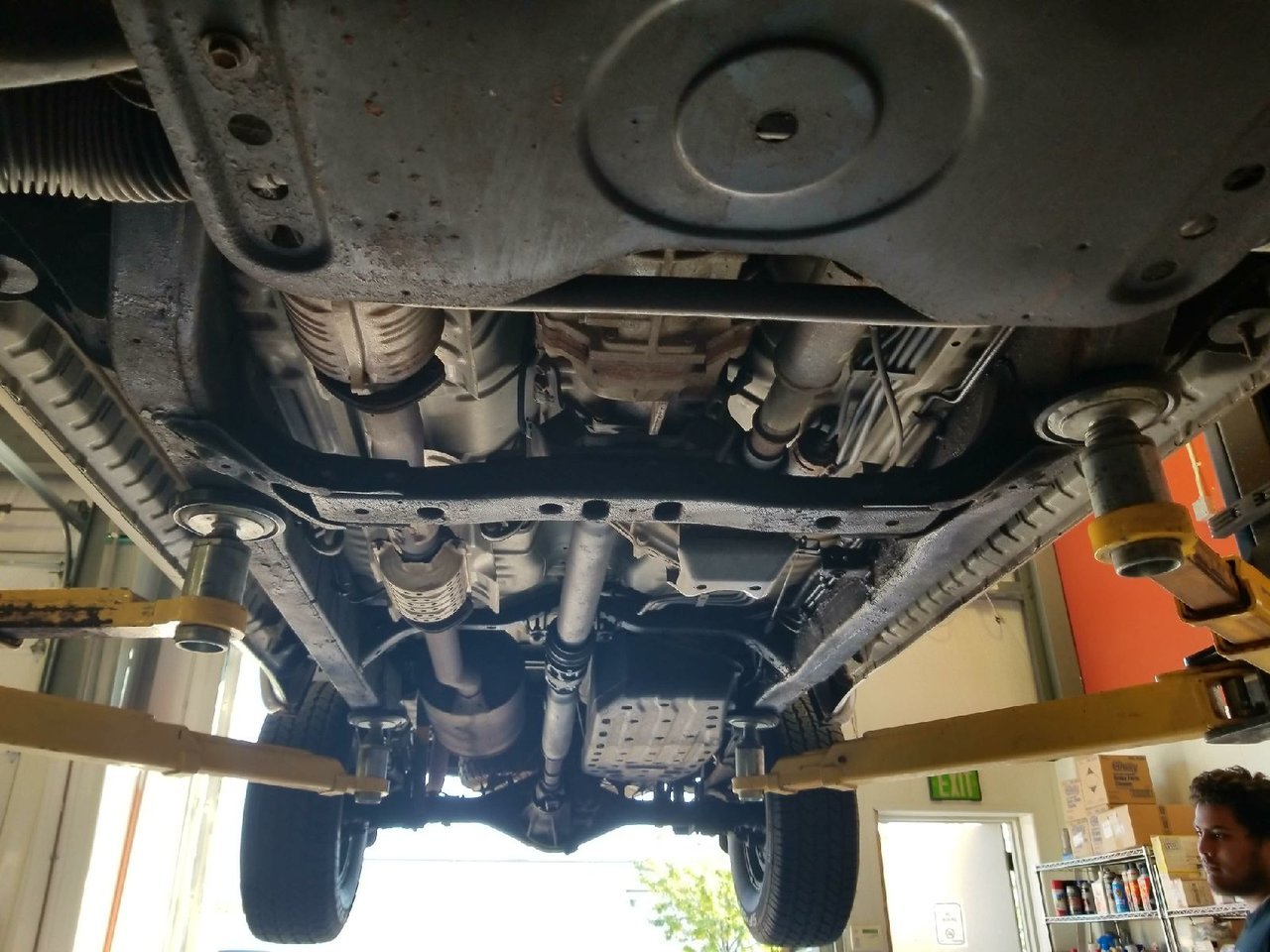

    This is a completely different truck than the last one. I just didn't want to start a new thread.
    I saw a few areas of concern but this one looks way better than the last one.
    tcjacado likes this.

    looks better, yes but it seems to be as rusty underneath the paint than the last one...

    don't want to be the negative one, but rust on these trucks is pretty nasty. In the end, you still decide if you buy or not.
    I can tell you that mine looked horrible, peeling off paint and rusty flakes all over it but it was rock solid everywhere. I could even see fresh shiny metal when I scratched the rust off. Rust does not mean it's not a good truck, but you have to put it to the test to see how bad it is
    Also, as strange as it may sound, not being sprayed actually helps, as there is nothing trapping the rust and moisture against the frame, so rust wasn't/isn't accelerated. Rusty but greased is better than being rusty and painted over, as the grease prevent moisture from building up, while paint is like a bandaid on a gangrenous wound (unless treated properly before painting)
    anyway, If you can't perform a hammer test or find someone who can do it for you, it's too risky to buy a rusty one

    It's very hard to judge the integrity of the frame by pictures, although they are helpful. They really need a hands on inspection. Post 48 looks very good, but without an inspection, its a gamble.
    I've had three frames succumbs to rust. My current frame is questionable. I never saw it on any of them until the dealer inspected the frames. Trucks that lived in cold weather climates are suspect. You can't be too diligent in investigating the rust. This is your hard earned money we are taking about. Spend it wisely. Get an inspection. I'd do it for you if close enough.
    Frames can be fixed. If done correctly they will be better than EOM. If you are up for that, then plunge ahead. Just be aware of the risk you take.
