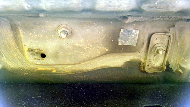

    Here is another frame to look at (not for sale), just for comparison. To clear all confusions and questions, this is 22 years old California frame with zero rust moved to "cold state" area 9 months ago so it was sprayed with fluid film about 4 months ago. So what you need to look is stuff like bubbled surface or rotted welds.
    For comparison with "other trucks" shown here here are bolts coming down through the vehicle body.

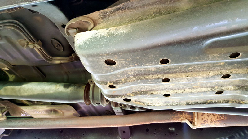

    Now I just realized I f*** up and did not take care of fuel tank skid plate. So here is used to be clean rust free just after 9 months living "cold state" when not protected by fluid film.
    You can see surface rust already in some places, tomorrow I will find out how it looks from the top when I remove it for inspection.

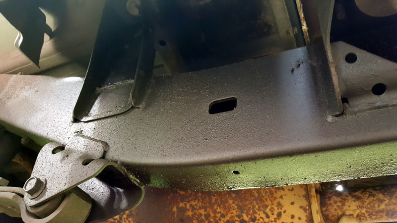

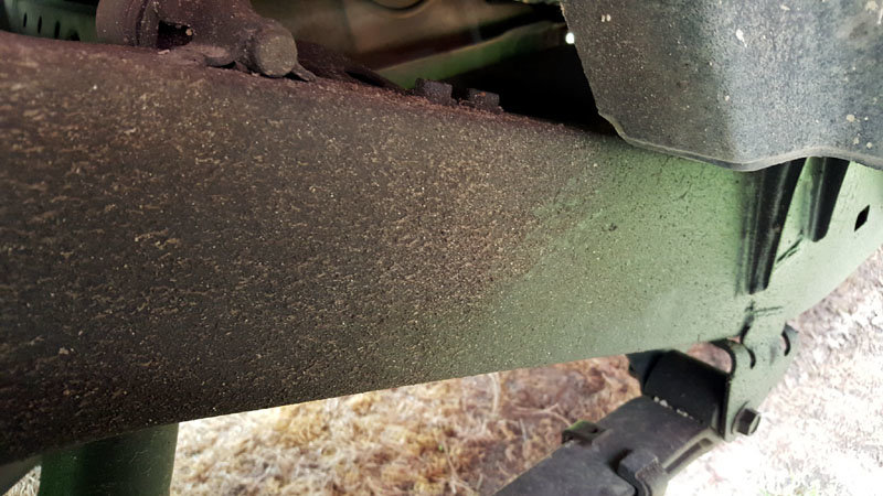

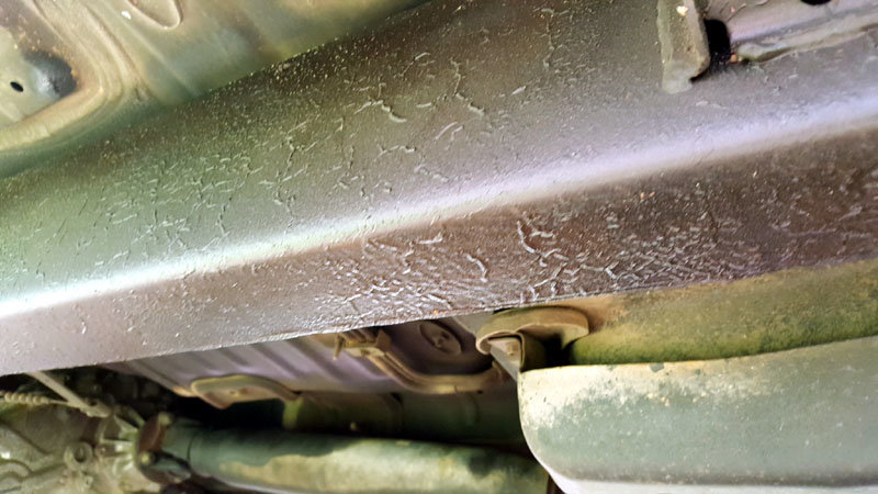

    Most of these pictures are taken in the wrong place. You need to see the inside of the frame channel and the gas tank side is usually the worst. Here is my gen 1 before I scrapped it so you can see where specifically you should concentrate:
    Gas tank side is harder to get a good photo of:
