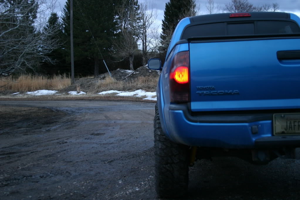

    anyone know approx how many inches the tires will stick out past the fender flares on 285/70/17 on 17x9 with a -12 offset...

    I would like to know how far they stick out as well....

    This far... Exact setup
