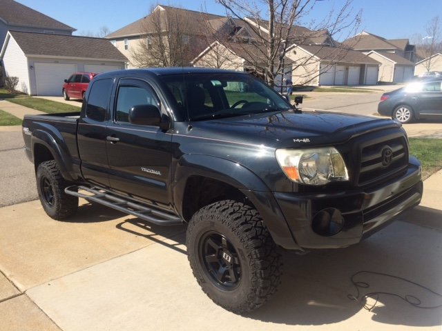

    Did you rub at all with this setup?

    I rubbed on the front mud flaps in reverse at full left lock. So I ditched them and solved that issue
