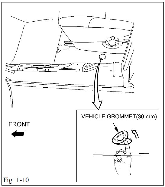

    Hello everyone---I searched but not finding what I am looking for. What is the best place to exit the cab of a 2008 Tacoma with wires to a back up camera as well as bed lights? Is there an easy spot?

    The best place is under the driver seat theres a grommet under the carpet roughly in the middle close to the door sill
