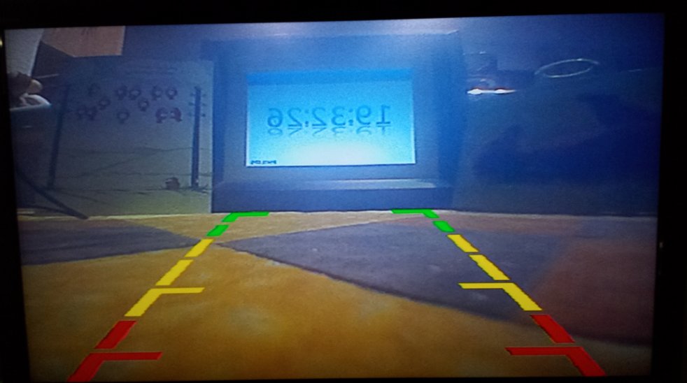

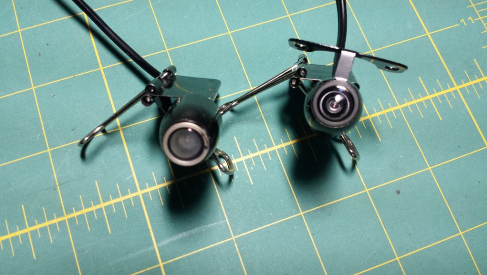

    I did put e-sky camera (from Amazon) inside the steel trailer hitch plug:
    It is easy removable, and under that armor it is well protected from being run over. The only issue I have is road dust hitting the camera lenses, that are not quite strong for that. I already went through two cameras, that got lenses "sand blasted" causing the blurry image.
    Here is the sand blasted camera image (with guide lines) vs the new one (without guide lines):
    Here are these two cameras side by side (sand blasted on the left)
    I'm still looking for better location for the camera.
