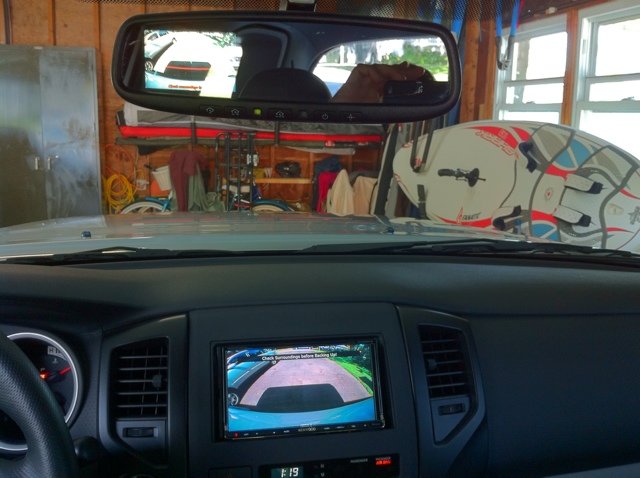

    2012, its an aftermarket HU but it comes up to both. just tapped the camera wires and fed them to the HU. (this was already covered in the thread i think) but just wanted to put the photo up. i find the lines on the mirror more helpful than using the HU.
    my truck did not come with the camera or mirror. i ordered them from a user on the forum and plugged them in.

    B737 - what dash kit did u use?? I have the Scoshe for the 05-11 but have been afraid to install as I heard the fit was horrible!!!

    It is the 2011 Metra Dash kit. It took a lot of tweaking but it came out great. in fact i could live with it in its current state with no problem. In the future i will swap it out, but am in no hurry. No one would ever notice.
    It will take some adjusting and trimming of the parts but you can get it to fit properly. the curve towards the top is slightly different, but once you fit it in there right the gap lines will be tight and equal. you also need to dremmel, file or trim the hazard light cut out. but its very tight, doesnt rattle, shake or move, and the gaps are good.
